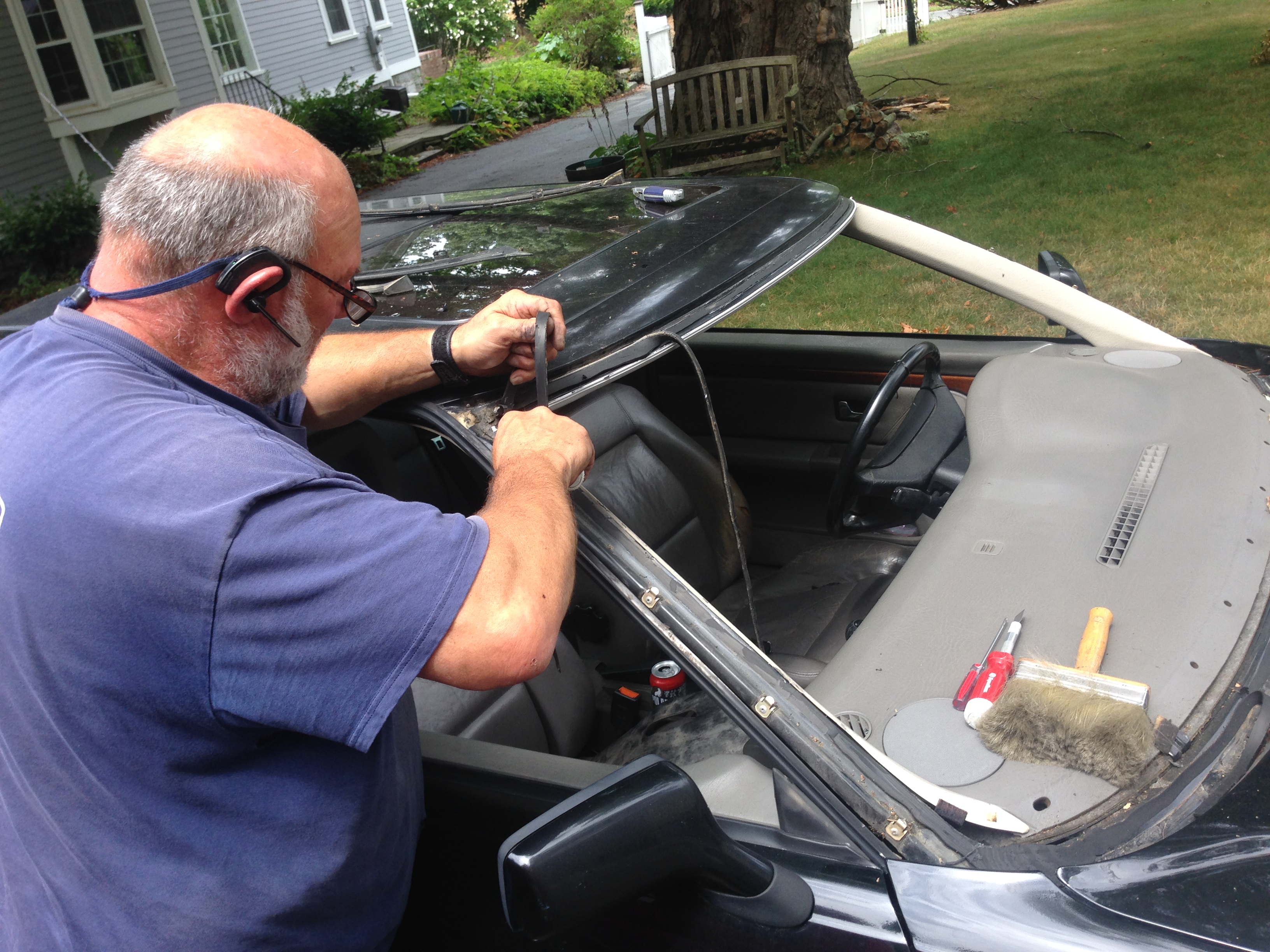

Re: Pain in the glass
Don replacing a Coupe Quattro Windshield for me this past summer
- DonCotton - 1.JPG (2.33 MiB) Viewed 41887 times
