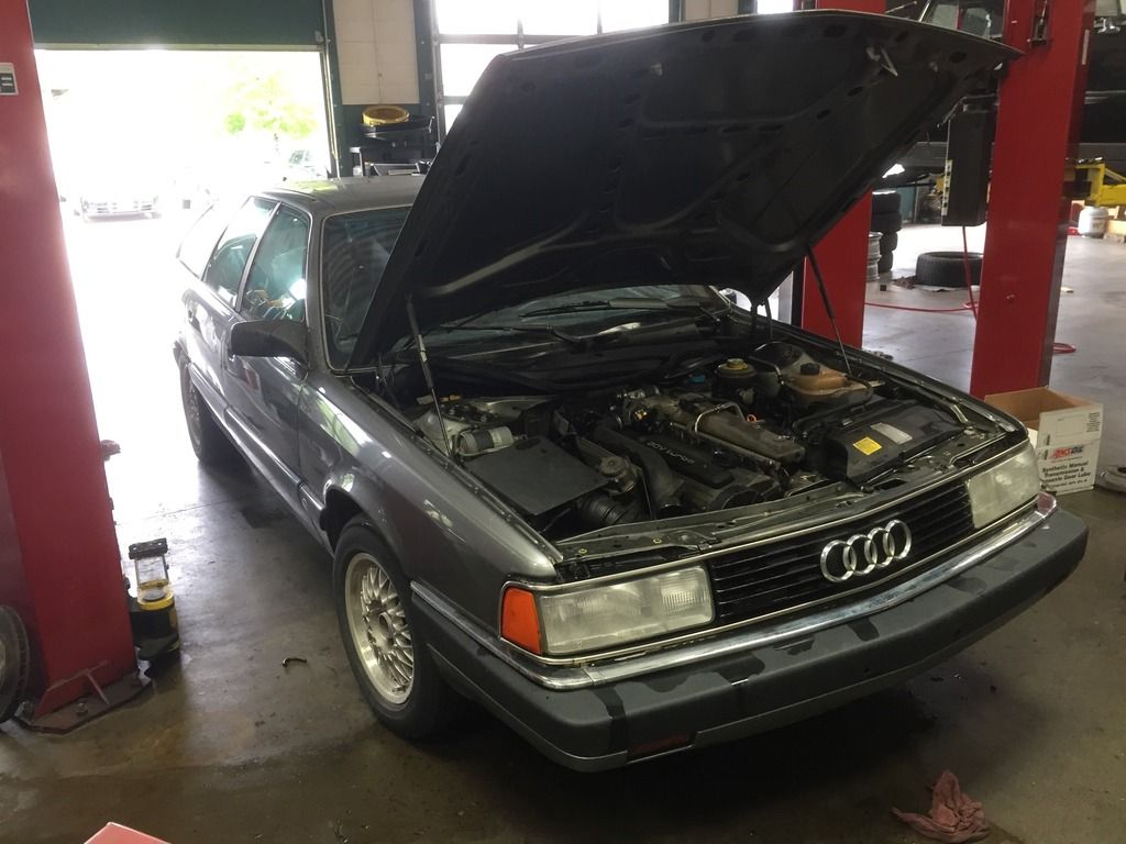

Here's what I'm starting with:
The poor thing was going to be gutted so I traded a fully dressed AAN for it to save it. The driveshaft was removed because the bad rear diff mount was improperly diagnosed as a carrier bearing, the interior is a bit of a mess (sagging headliner and the like), has comfort seats, and the intake had been hacked up and was missing some bits, had a 20v intercooler in it...
Good news is its not rusty, had Konis, SS brake lines, gutted cats/removed center muffler, and hopefully more... And it came with a spare rear wiper motor, fingers crossed it works.

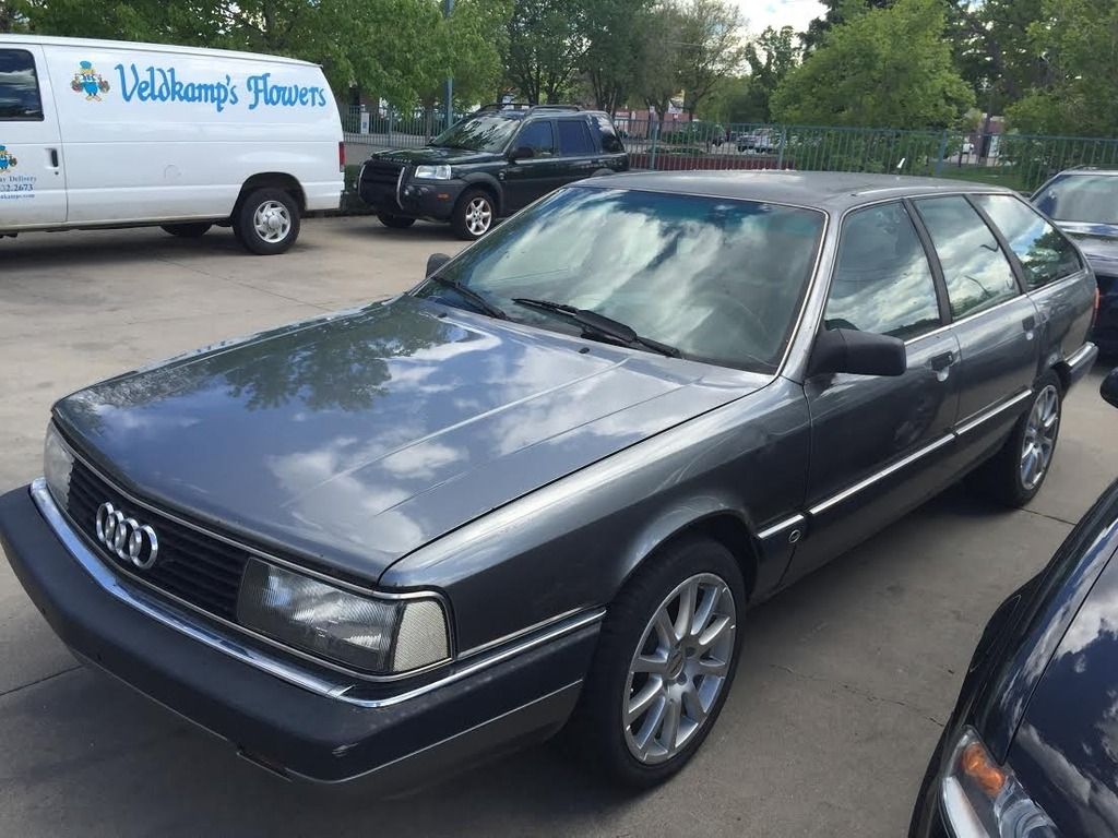

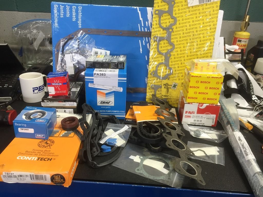

Here we go...
Parts

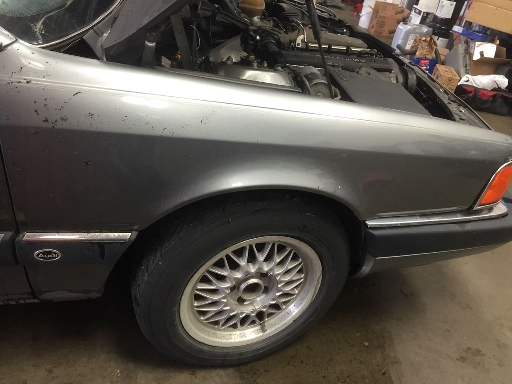

And then this mystery that I'm still trying to solve... Anyone got ideas?
Re: Eli's 200 20v Avant, it's about damn time
What mystery? The fact that it doesn't have side repeaters?
paradox11235
Posts: 135
Post by paradox11235 »
Yeah, I was under the impression that all the 20v 200s had them
Ok I'm guessing either the euro ones don't have them and you have euro fenders for some reason or it was repainted and they filled the holes?
paradox11235
Posts: 135
I inspected them pretty carefully and I don't think they're filled. I'll have to check and see if the wiring was there. Maybe I should get a history report

Well, it's a start...
Looking much better

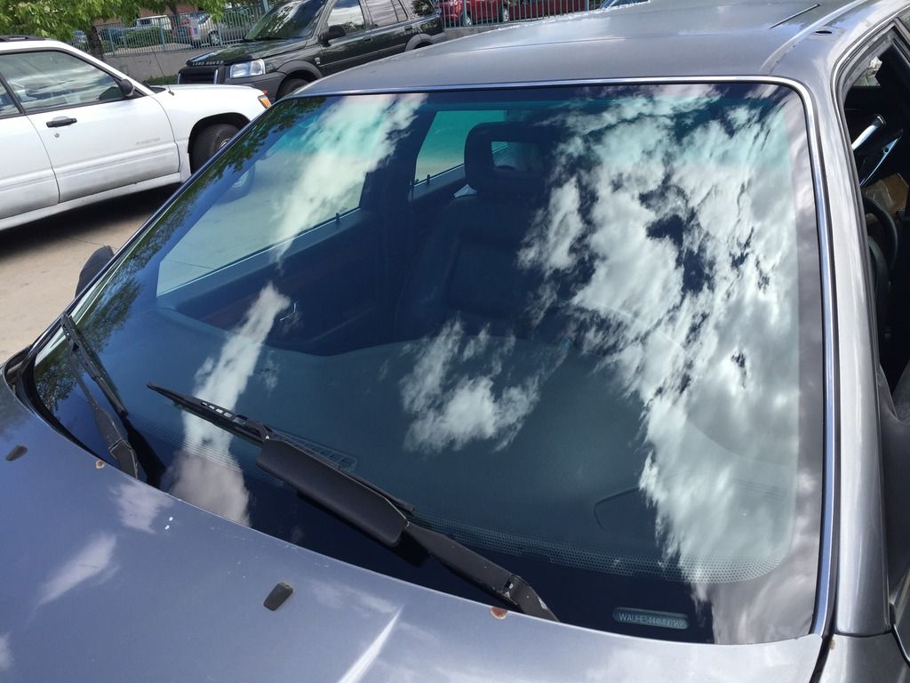

More minor updates...
Shiny new glass...

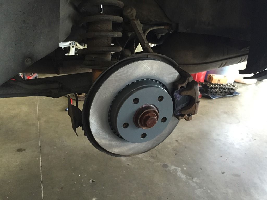

Rear brakes done (just stock for now)

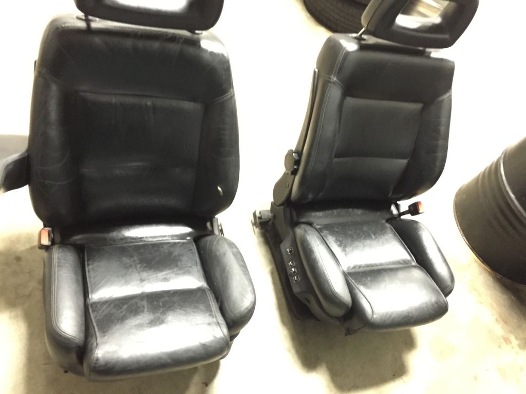

Sport seats cleaned and conditioned. Bad picture, but...
Annd driving her home finally

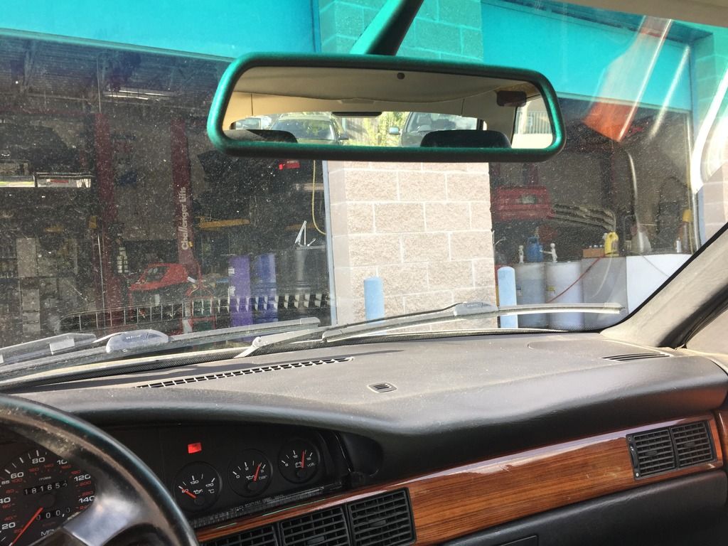

I installed this today though... Haven't hooked it up yet, but it just needs 12v and ground. Autodimming compass mirror from a6
Nice!
I've been wanting to do the same for my coupe.
