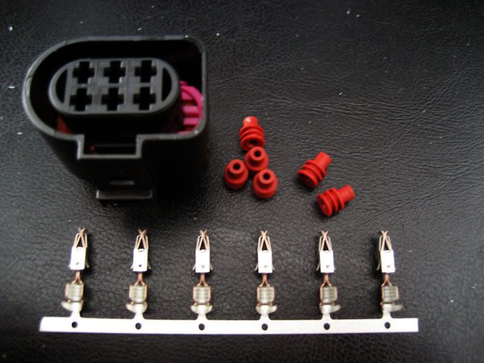

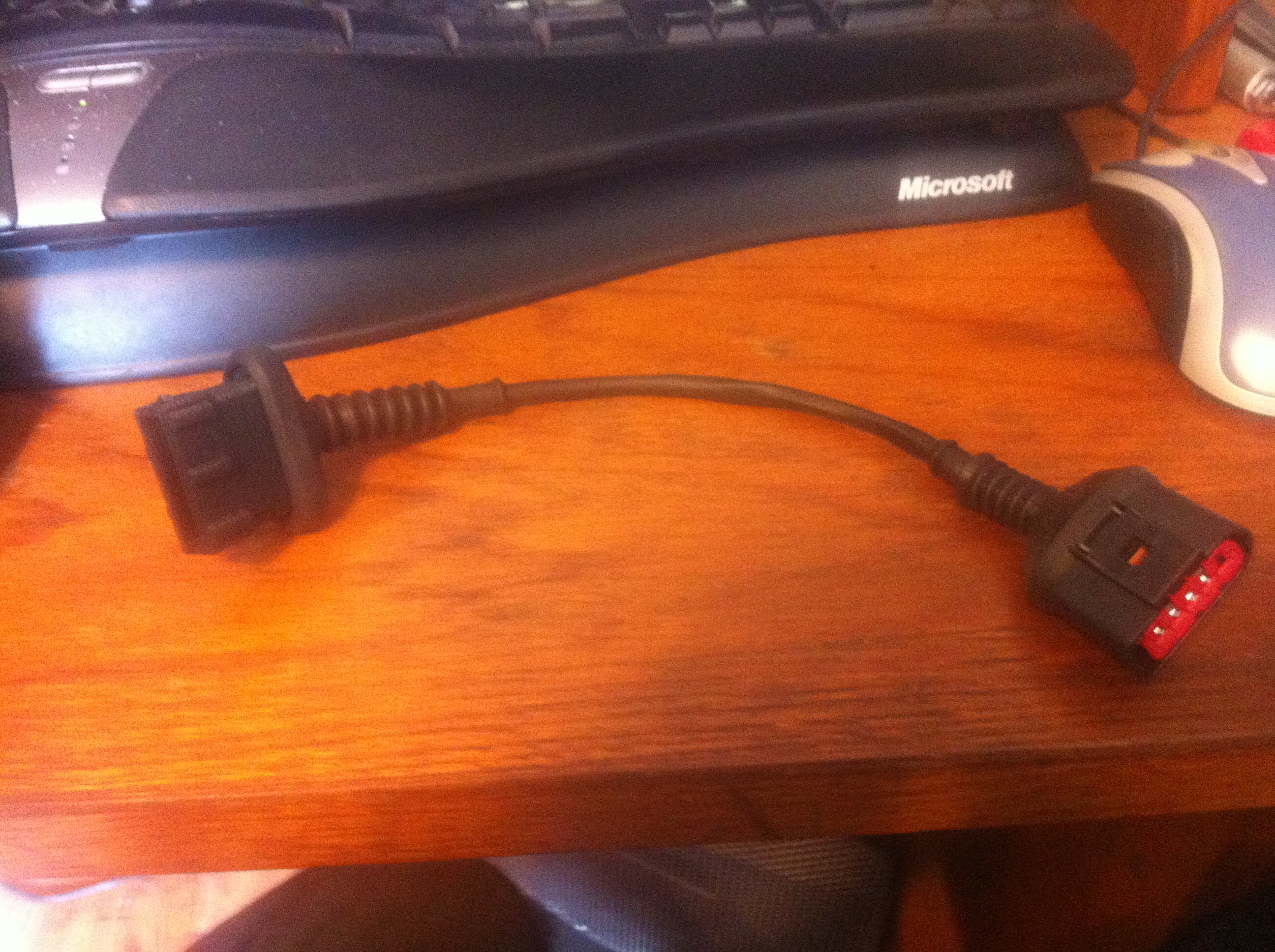

Re: Any guesses what this adapter is for?
Nice! New printer putting n work!
looks like a wb02 connector on the right?
Posts: 1589
How about now?
nevermind I fail - wb02 has two rows of pins...
LOL you made it too easy :)
B5 RS4 MAF for big HP Motronic tunes
Posts: 1589
EDIGREG wrote:LOL you made it too easy :)
you're amazing! :lol:

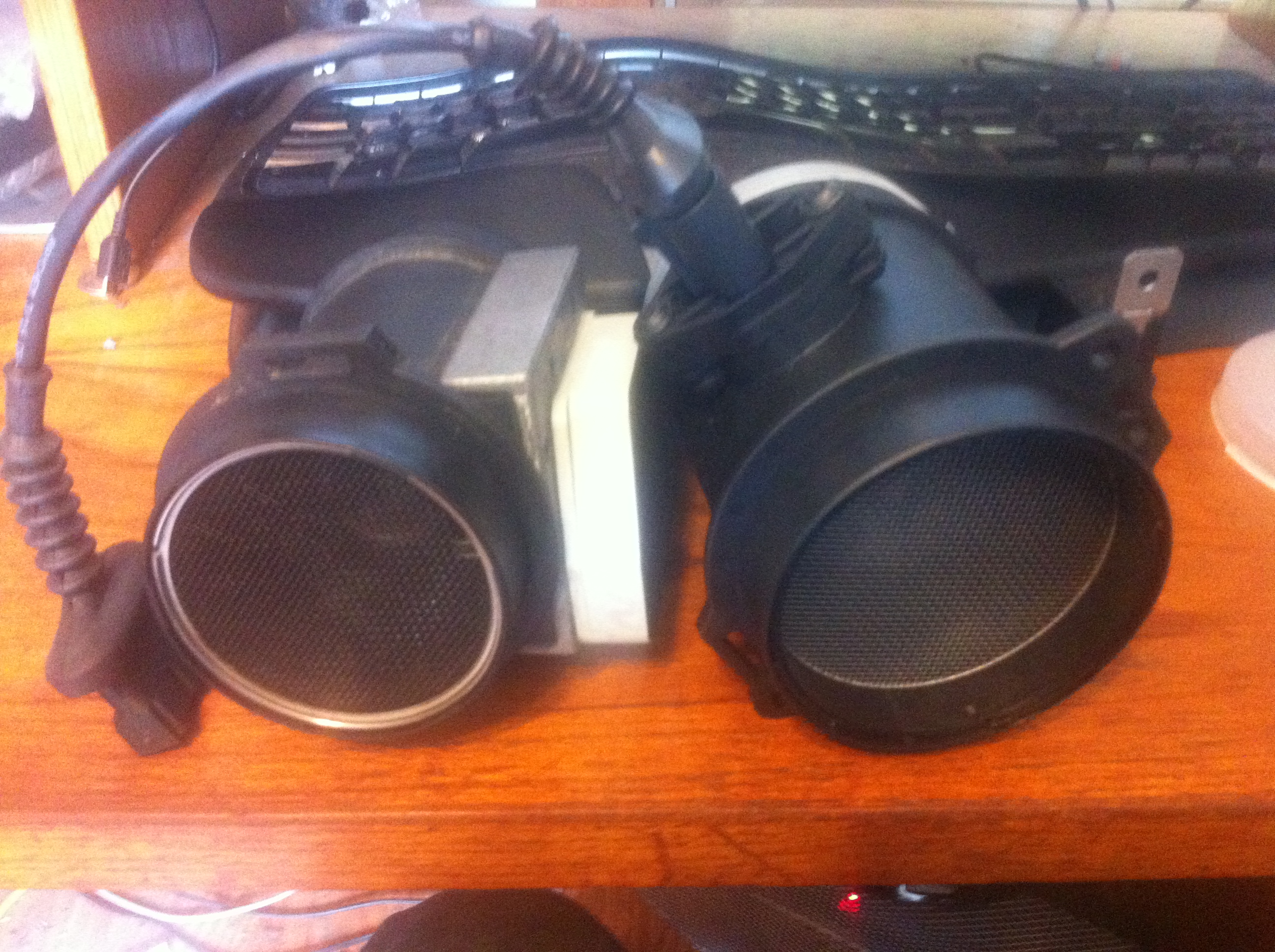

yep, going to be tuning on this maf this week so we can have it as an option for 400+whp cars where the stock MAF can no longer meter.
