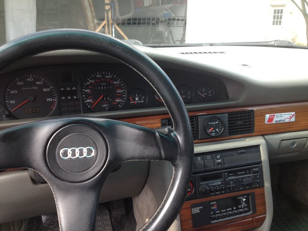

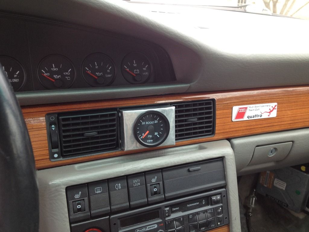

There is a little hole in the center vent (toward the left side of the car) that you can get electrical wires through, and presumably an air hose too. You just have to trim it a bit most likely. I'll see if I can get a picture of mine.
Re: Chappers' 200 20vt sedan - Pearl
I have skinned the hell out of my knuckles but I fished the pressure line and wires through the vent above the glove box and routed up to the centre vent hole. I made this little aluminum box to hold the gauge. Next job is to paint it black. But really I want to 3d print a pod that would look much prettier.
But for now this will do.

I got the dimmed light power from one of the switches for abs, seat heaters, etc.

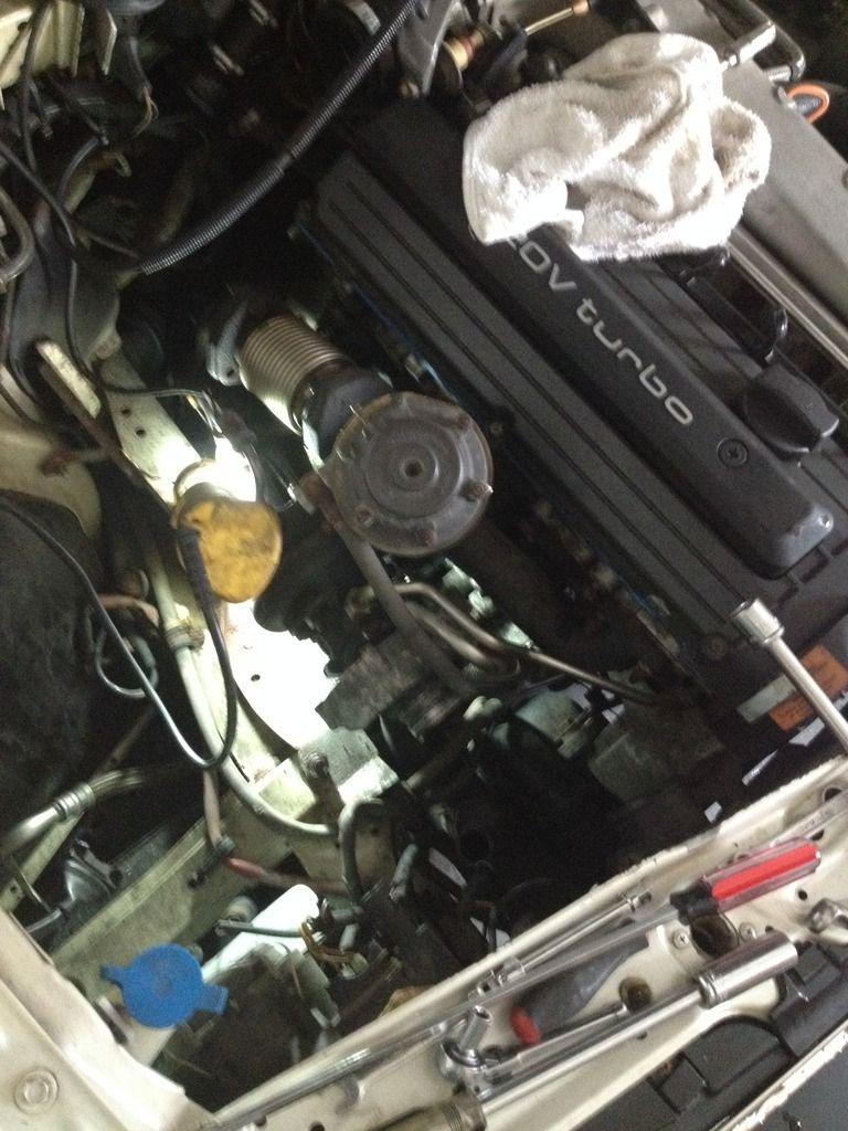

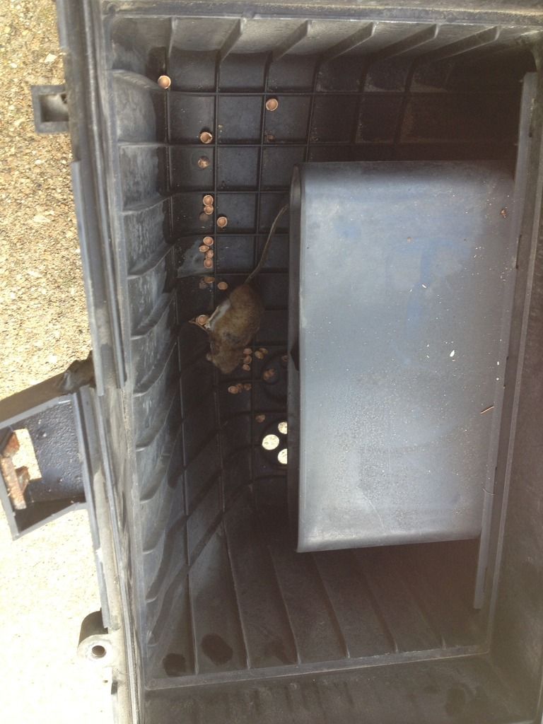

Started to pull the turbo out, found a mouse inside the air box, scared the crap out of me at first!
Also I got stuck on the last downpipe nut, I can't seem to get anything on that gives any leverage! What do you chaps use?

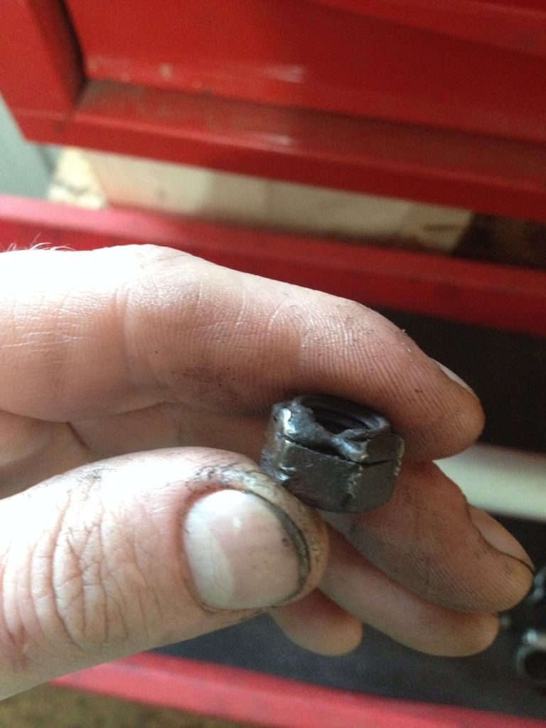

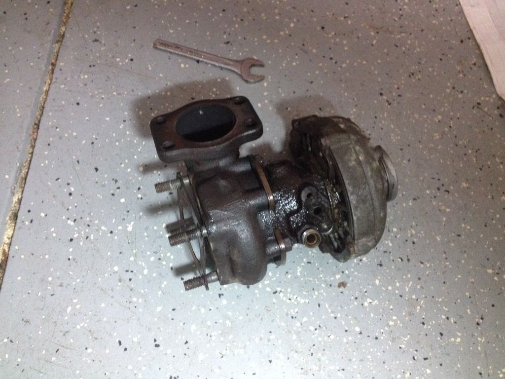

Get in! I got that nut off, what a pain.
It was some deformed dwarf too, 15mm wrench vs 17mm for the other 3, think it's some sort of lock nut?
Also ended up taking off a couple heat shields, but managed to get turbo off with downpipe there.

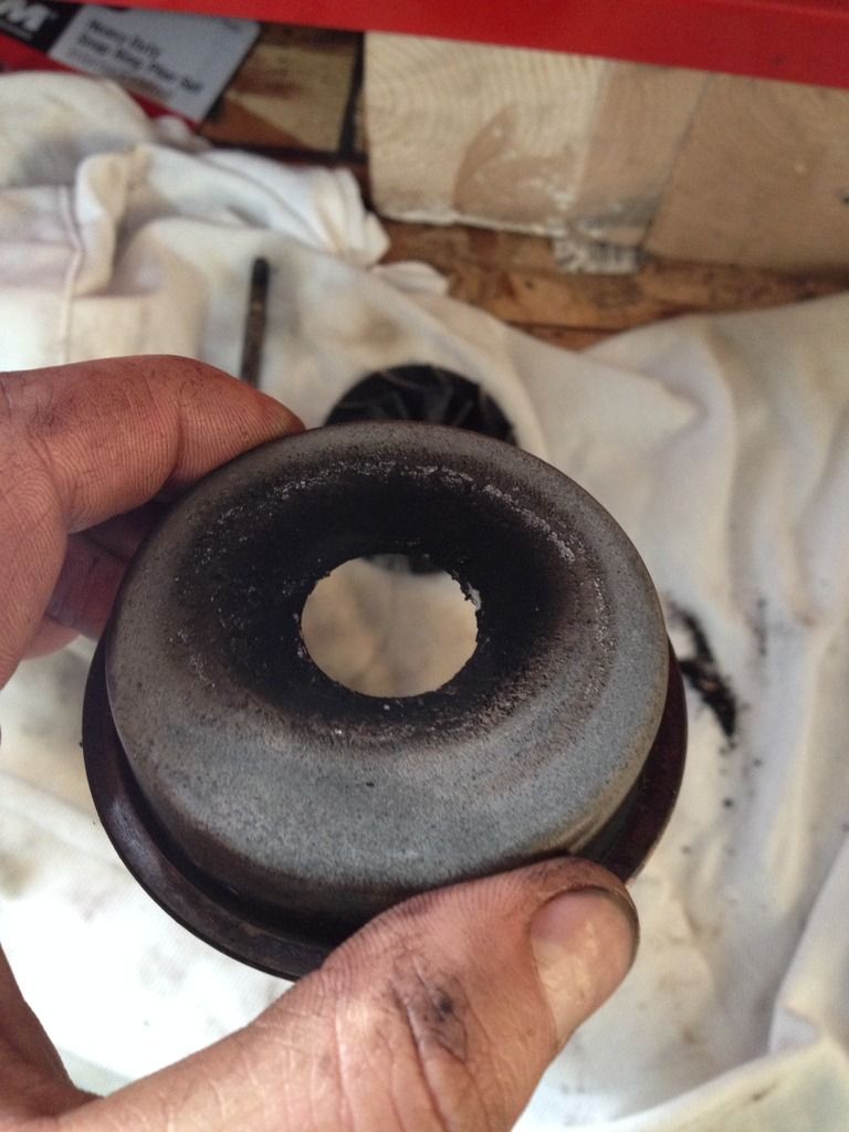

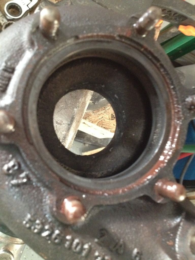

Turbo is oily after the compressor, going in to the intercooler there's oil all over.
The turbine wheel looks like there's ash on it! Comes off like a powder, I know it takes 550 degC and above to burn soot to ash. Is this normal to see in our turbos?
It's fairly normal to have oil in the compressor since of the turbo and intercooler piping since the crank breather system goes through it. It can happen due to the seals though. Oil in the turbine housing would more likely be a sign of seal failure.

Either way I persevered with a 15mm wrench and it came off.

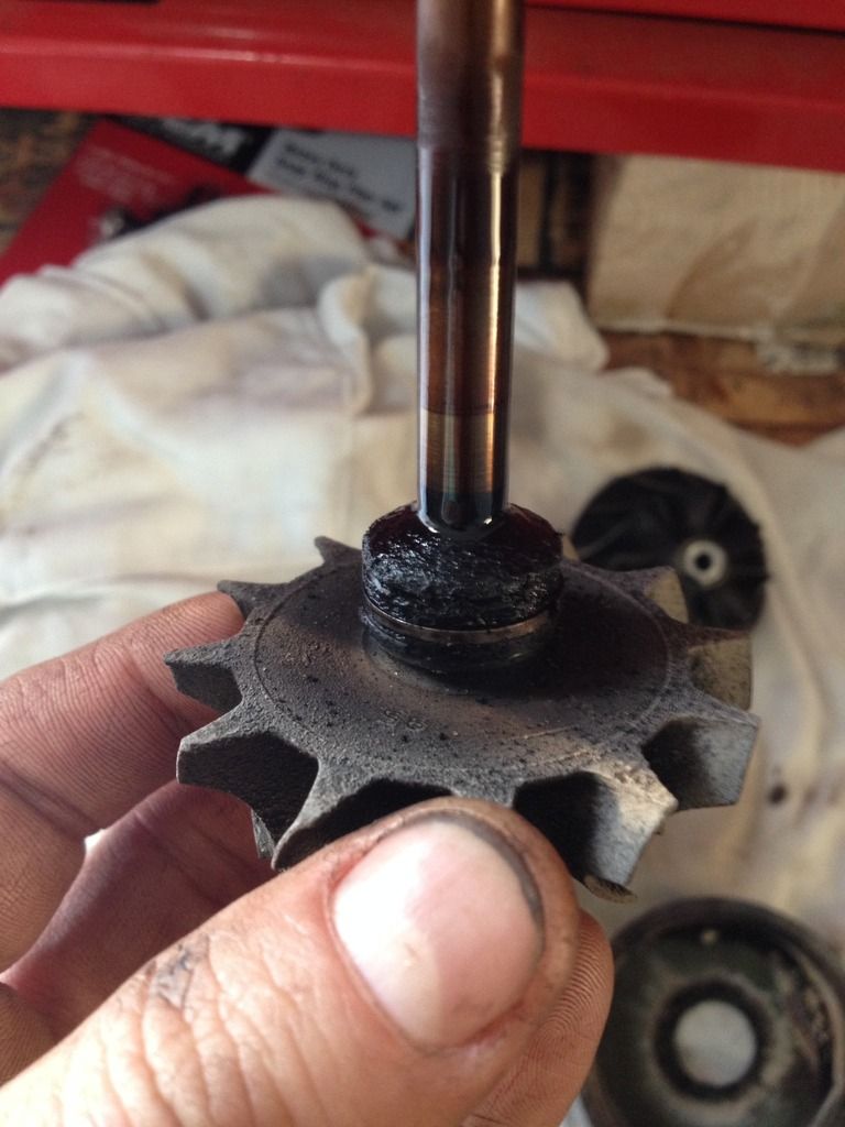

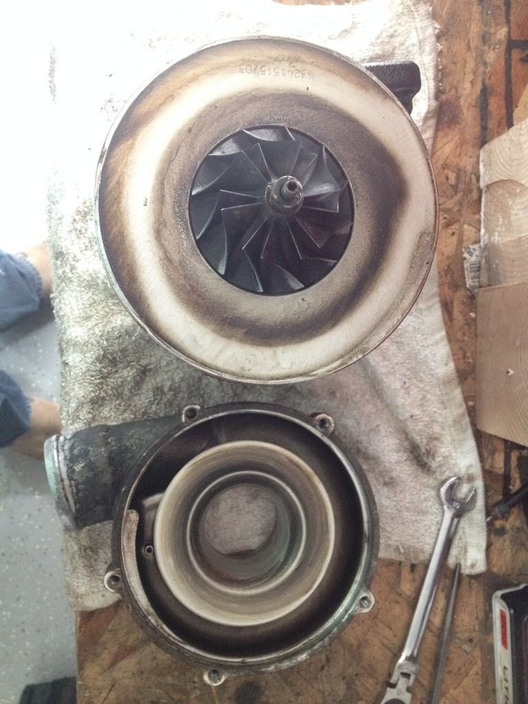

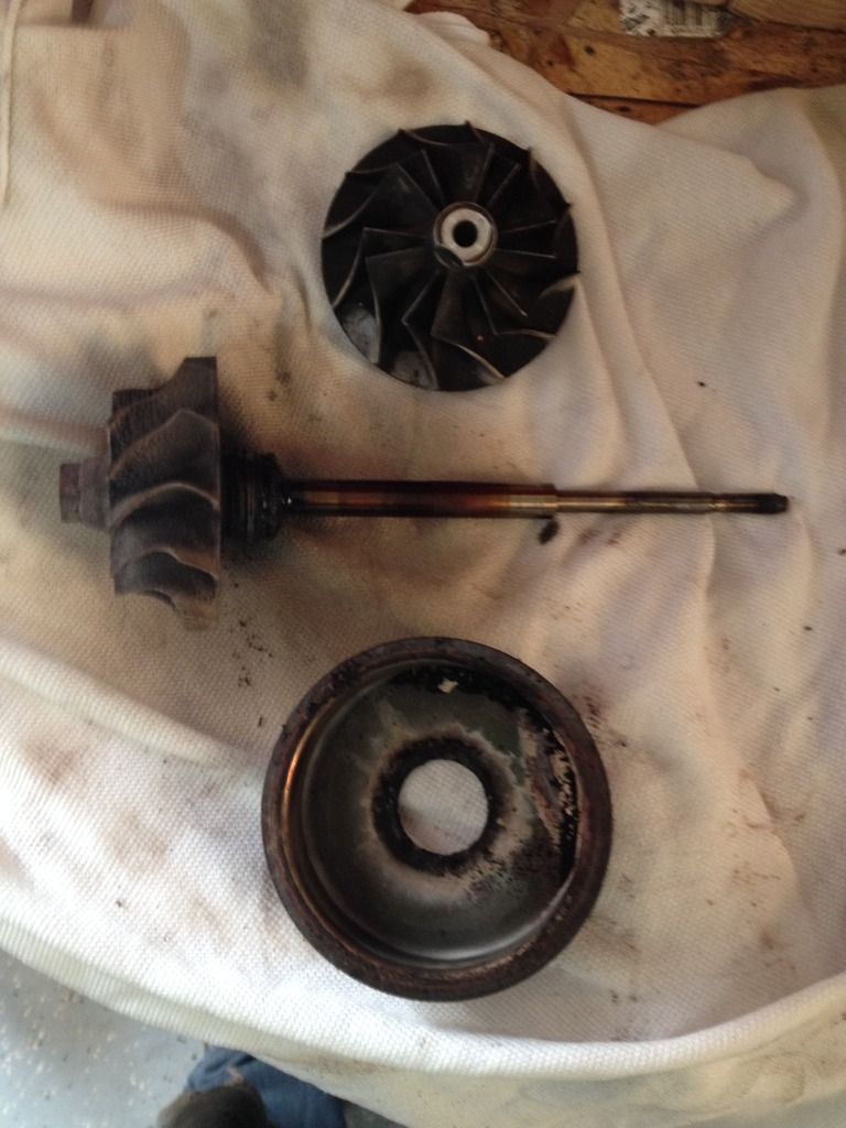

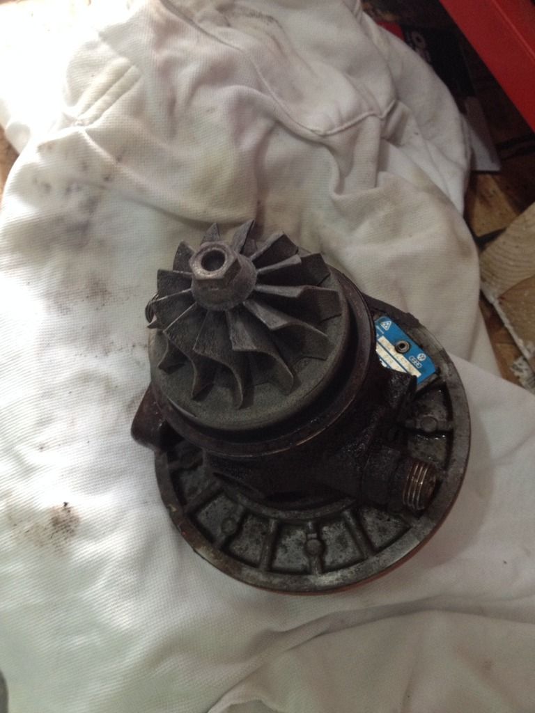

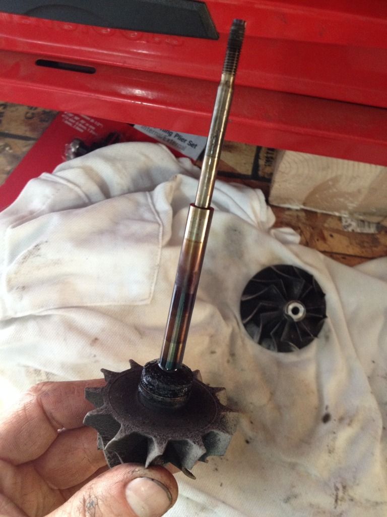

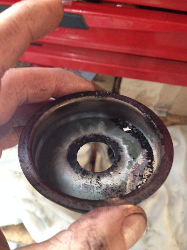

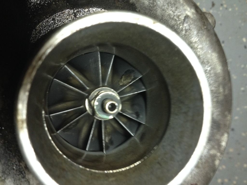

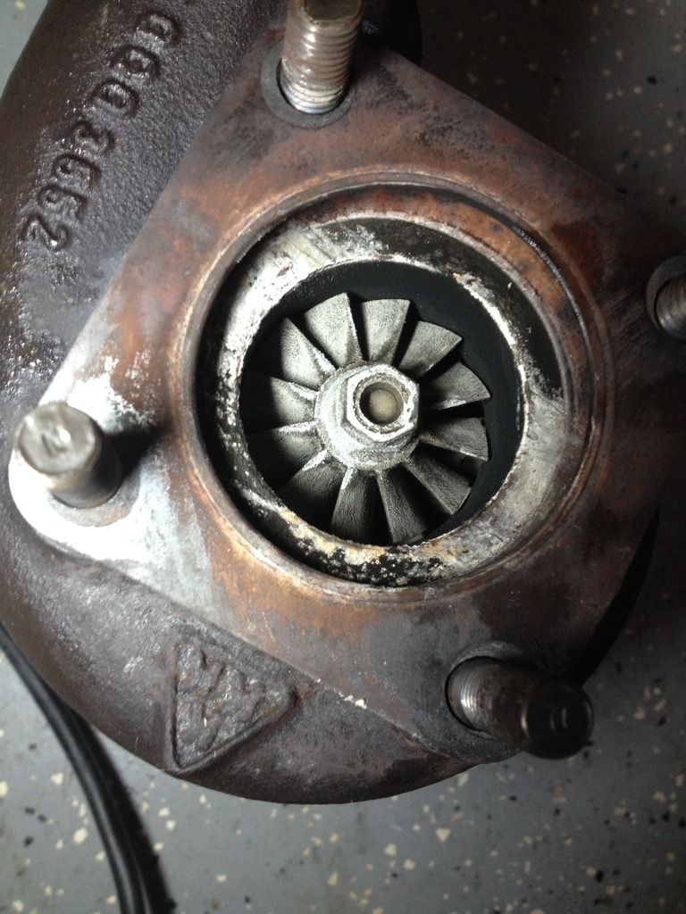

More strip down this evening, followed by lots of cleaning of parts in gasoline and carb cleaner.
Everything came apart nicely, no broken bolt or anything! Applied a little heat to the compressor wheel to expand it and remove from the shaft.
Pics are just from the strip down part, looking at the shaft near the piston rings looks pretty oily and sooty and there's a little collection of ash inside the heat shield.

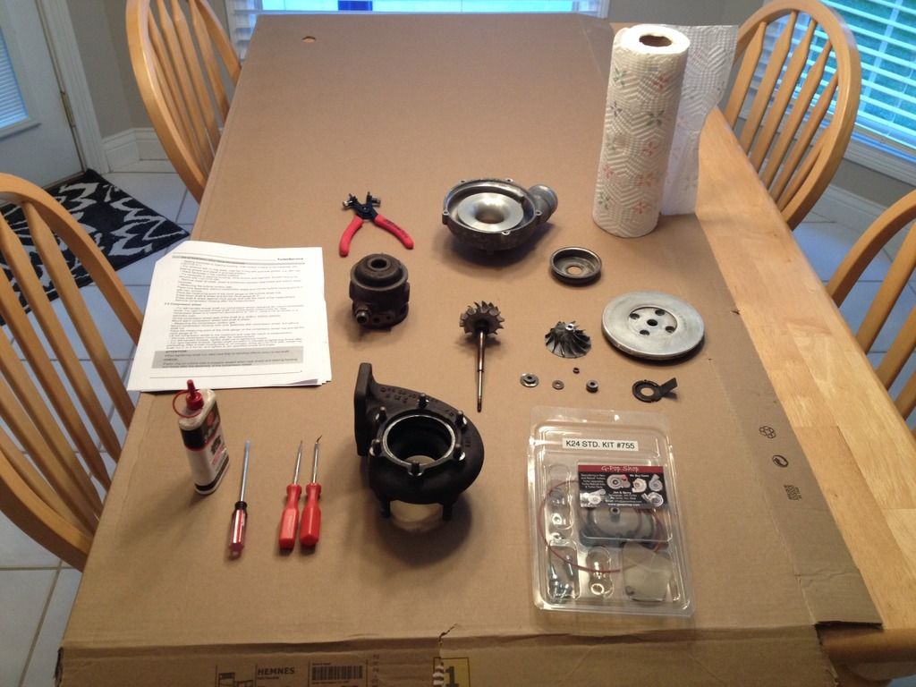

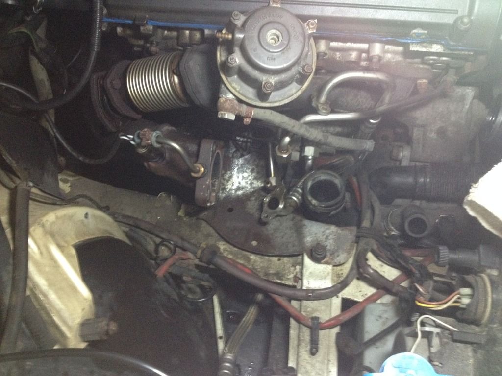

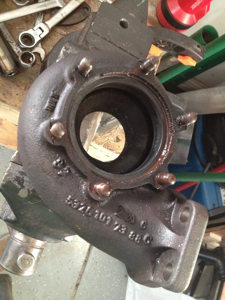

Last night I rebuilt the k24 7000 using the instructions that same with the rebuild kit from G Pop shop. They were OK but didn't give torque specs or end float specs. But it went together nicely and I used my dial indicator torque wrench to get even torque (mostly 70-80 lbf.in) on most bolts/nuts.
Turbo spins really freely, got the new manifold and downpipe gaskets from AutohausAZ so I spent this evening throwing it back in.
I got stuck on the coolant return fitting though, it's right under the turbo and I couldn't seem to get it aligned so that the nut would thread on properly. At that point my back had had enough and I called it a night.
I saw that the other end of that coolant return line was hose clamped to the block so I'll unattached from there to maneuver the threaded end better.

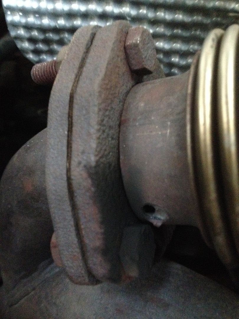

While checking various things on the engine while it was running I noticed something strange about the bellows, there's a small hole developed or I'd not noticed before. I suppose it's not meant to be there as it's leaking quite a bit.
Anyone seen this before? Is there some explanation? Rest of bellow is mint!

Lol that's so weird. It almost looks like it was helped along seeing as those areas are somewhat thick.
