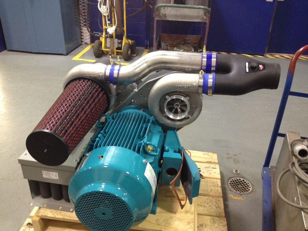

Also thought of you guys today at work when I saw our new blower motor!
The inlets on those compressor housings are 5" ID!

Not heard this yet, supposed to flow 2000 kg'/hr
We test commercial vehicle engines up to 600chp
This is a 'low cost' solution to simulate a 16L engine flow rate.
Got me thinking about a possible sequential setup for the high HP builds I've seen, where the turbo response is quite laggy. Could a vortech supercharger be added to improve low down power and torque?

I don't think a centrifugal supercharger like that is the answer to low end power. The other variations of superchargers would be much better for that. However, I like the idea of sequential turbos even better. It just takes some very fancy plumbing.

Welcome! What is that setup used for??
Posts: 2145
Re: Chappers' 200 20vt sedan - Pearl
Never mind, engine simulations as stated above. Super cool.

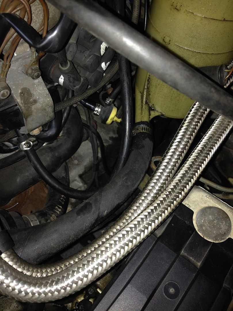

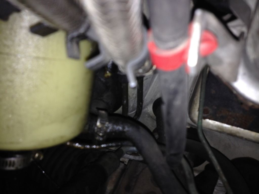

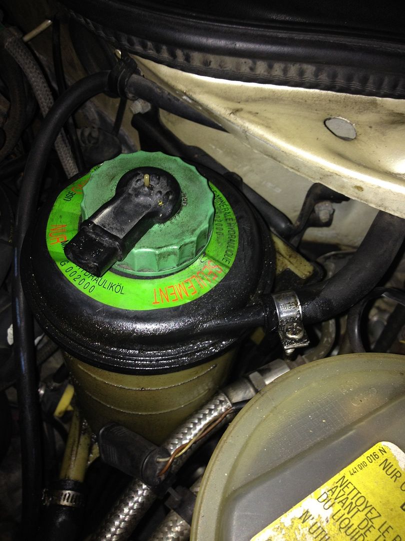

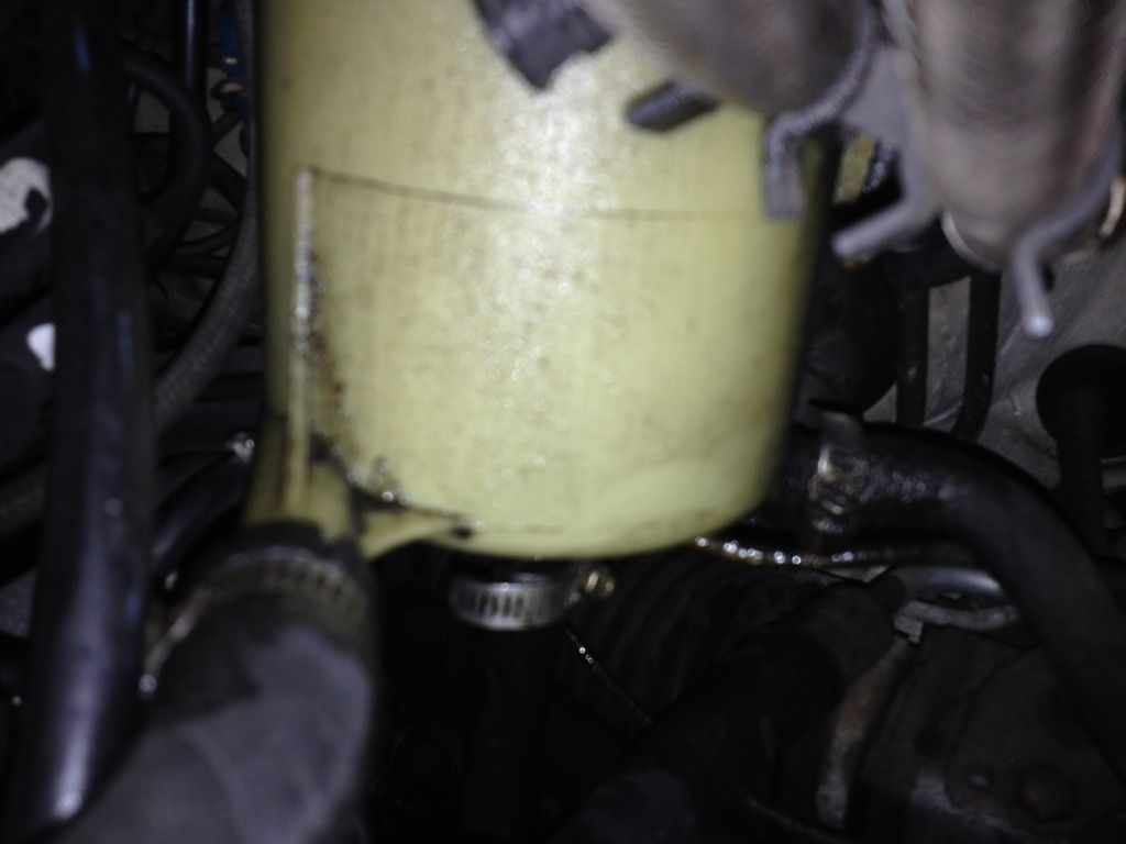

Pentosin pentosin everywhere but not a drop in the resevoir!
(Actually I do have to keep topping up to the correct level)
Anyone know where I can get new hoses?
What do you guys do when yours swell up and start leaking? Ermm should I rephrase that?

I would try some local hydraulic shop with the hoses.
You do obviously have some hose leaks but I'm betting your major leak source is the rack itself. That's one of the worst problems with these cars.

Juizer wrote:LOL,rephase not necessary. :D
Thanks, that's a good idea, but I would have to remove the banjo fittings, which are currently not leaking - so i'm sort of reluctant to disturb those, hmm
loxxrider wrote:You do obviously have some hose leaks but I'm betting your major leak source is the rack itself. That's one of the worst problems with these cars.
It just seems to be leaking at the ends of the hoses where they are hose clamped onto the reservoir, if i could find the appropriate diameter/type of hydraulic hoses, i might cut off the swollen ends and connect the new to old hose via barbed hose connectors. Anyone used that method before with success?
But thanks Chris, i'll check the rack for leaks as well....

Don't worry about the banjos, if you get new crush washers for them, they will seal reliably

Cheers Chris, I appreciate your advice especially as my questions are so mundane and don't even compare to the in depth conversations and pioneering updates on this forum!
I'm ordering a recharged brake accumulator from David Kase so I'll be replacing hoses then.

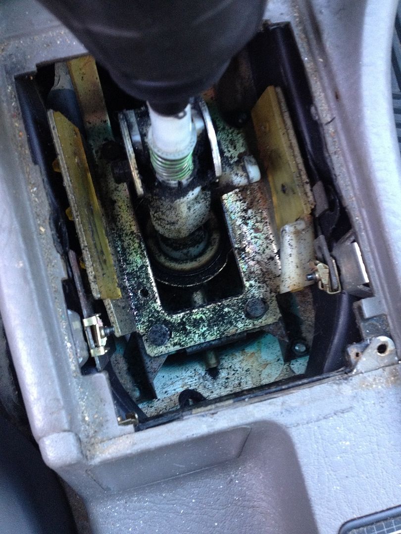

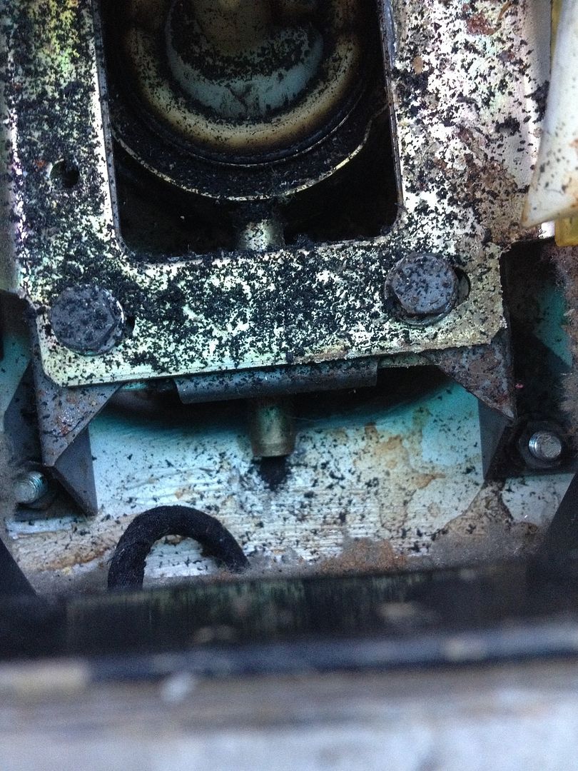

I also decided I'd had enough of the annoying squeaking coming from the shifter area. So I removed the boot for a look, I found black powder all over, similar to disintegrated foam. The rod at the rear of the shifter area seems to rub the body in that area, like it's missing something or dropped? Also found a loose little white plastic collar, wondering where that is from?
Any advice?

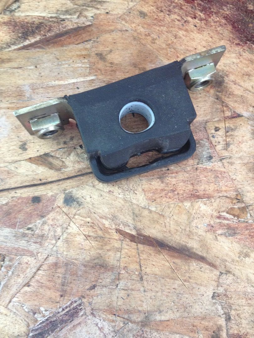

looks like the part 42 in the diagram below is maybe worn out and causing excessive movement? maybe the source of the black powder?
Either way I cant find the part on Jim Ellis website.
I also can't see that mysterious white collar in the diagram below....

Found some interesting reading here
http://www.audifans.com/archives/1999/08/msg00183.html
Looks like this is the part I'm looking for, oh and there's that plastic collar in the middle, also looks like the black powder is probably from that mount!

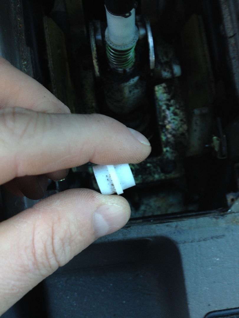

All sorted, and didn't cost me a penny! Turns out the shaft was shoved under the rubber part of the mount, so it wasn't properly supported, it permanently rubbed against the body, and it knocked the white collar out of the mount.
The gear selector mechanism must have been removed at some point and reinstalled incorrectly.
I took the mount off and popped the collar back in, put it back on the shaft and it's perfect! Like driving a different car! And most importantly no squeak!
