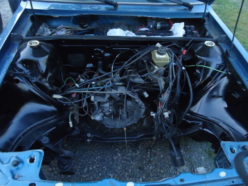

How it all started 6+ years ago:
In Progress:

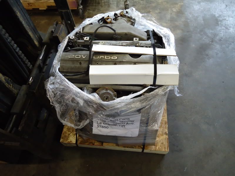

Was without a heart for 2+ years

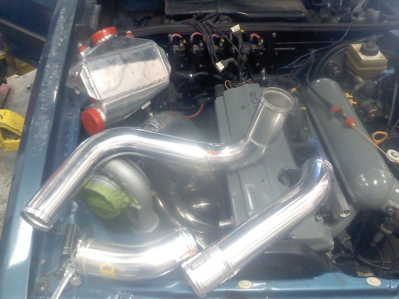

I/C Piping going together

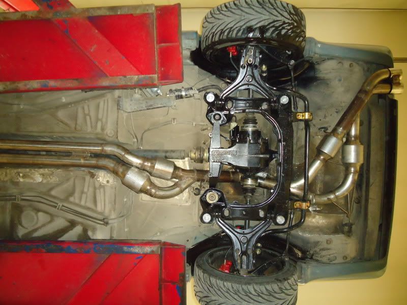

Derracuda Exhaust

I never noticed you were air to water Ben! Any more pics on that setup? I am debating going that route with the 200.
Nick
'00 A4 1.8t
'91 200 20v
'91 200 20v Avant
Re: Ben's Oceanic H1C/K26 AAN 4kq - 56k death
amd is the best wrote:I never noticed you were air to water Ben! Any more pics on that setup? I am debating going that route with the 200.
I don't have any good pictures at the moment. I will try and snap some here soon for ya! Right now I am just using the AUX radiator off of a 90 so the system looks rather ridiculous. The current pump I am using is off of a Montana mini-van (the aux electric water pump for the rear heater). Overall, I don't think the Aux 90 Radiator is going to be up to the task once summer hits, so I am going to modify a Honda radiator to work as my heat exchanger/fill point. The nice thing is that a civic radiator fits nicely in front of the stock 4k rad.

Very cool! Where is the IC located?
Nick
'00 A4 1.8t
'91 200 20v
'91 200 20v Avant
amd is the best wrote:Very cool! Where is the IC located?
Currently in front of the radiator, the IC blocks the lower part of the radiator just a tiny bit; but, fortunately so far it hasn't caused any cooling issues at all. Even if I let it set and idle for hours on end inside the shop.
I did take this while I was still getting things situated.
