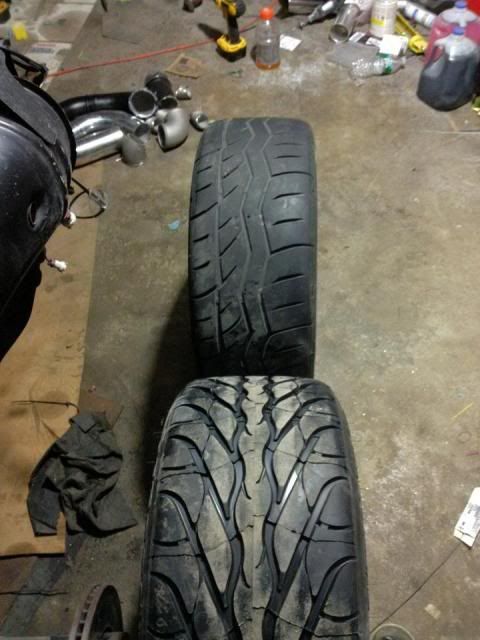

wider street rubber in hopes that the car can go mid 10's on STREET tires, i believe the current Audi record for that is 10.8. then to kiss the 9's on some slicks, and after that just cruise around the streets and enjoy the car. a front torsen diff to replace the stock open one. new paint, new engine bay scheme, new interior setup/dash and have more fun.

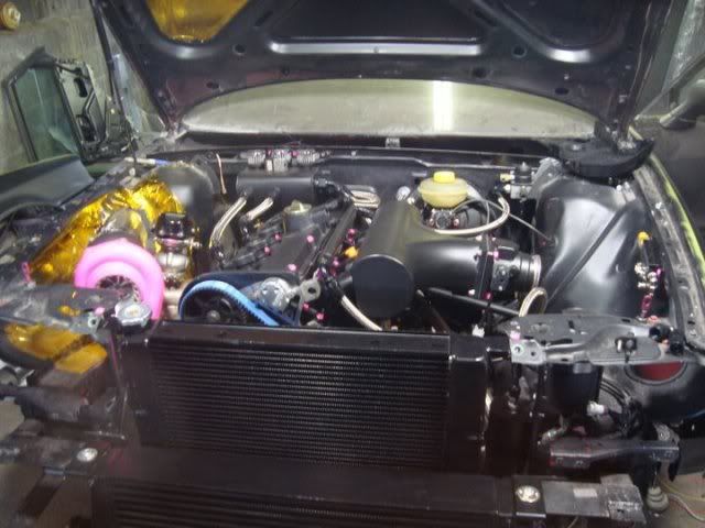

2.0l 20v
AEG crank
Custom pinned crank gear
Welded crank trigger wheel/bolts to crank
Welded oil pump gear
Calico rod and main bearings
SCAT connecting rods
83.5mm 8.5:1 compression teflon coated skirts JE pistons
Clutchmasters FX700 twin disc with steel flywheel
AEB head
Supertech Titanium retainers
Supertech Exhaust valves with single groove keeper
Stock intake valves
Cat 3652 billet cams
Custom built intake manifold
BBK 75mm Throttle body
Bosch 044 Fuel Pump x 2
Holley low pressure high volume pump
1 gallon (ish?) surge tank
2000cc T1 injectors
Aeromotive adjustable FPR
-8 fuel line
Vibrant Performance 800 core
Custom tubular exhaust manifold
Custom 4" stainless down pipe
Custom 4" aluminum exhaust from down pipe back
Custom 3" intercooler piping

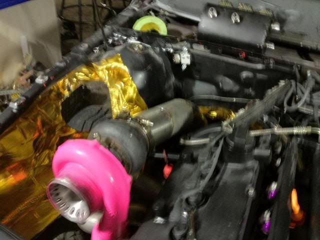

PTE 6765 (will be a 6766 for the 2012 season) t4 .81a/r
Lugtronic ECU tuned by Kevin Black....and no matter how many shiny or expensive parts are IN a motor or a car, without a tune....you just have an expensive pile of schit.

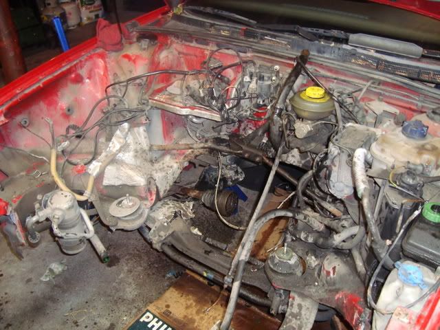

i am doing the same thing, zerb.. but into a CQ. with one of the 3 AEB's.... and keeping the rabbit, too. just gutted the coupe over the weekend..... what is your tranny plan? i am going 5 spd 01e.... and S2 axles from England.
gonna make brackets and such.... trans, motor, etc. i gotta keep an eye on this, you may be working ahead of me

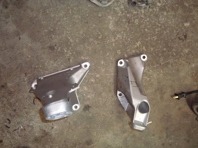

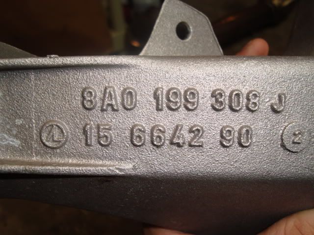

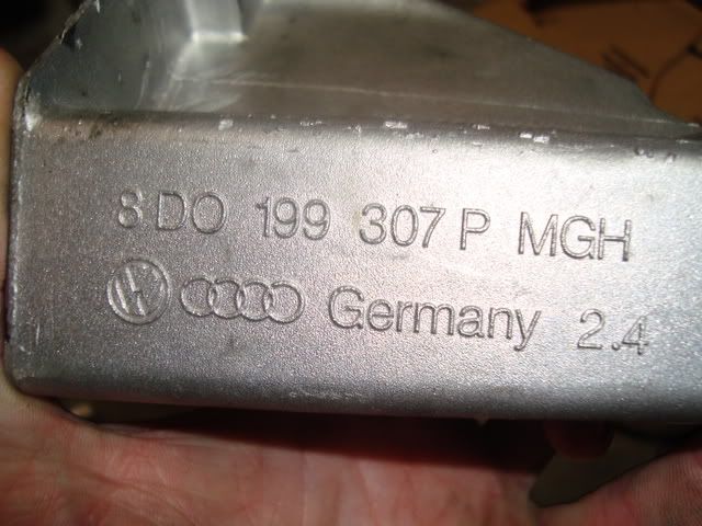

as far as engine mount brackets, since you have the 058 block, you just need
8A0 199 307 F = LEFT engine mount bracket
8A0 199 308 J = RIGHT engine mount bracket
and those should bolt right to you block and right into the car without mdoification. as for me, since i have an 06a block, the passenger side bracket is the same story, but ill need to 'modify' the drivers side bracket that i got, which i got out of a b6 passat.

yeah.... it is 01A... and i am new to this swap too. you saw Issams page on Poortex about the 1.8T into these cars i take it?
my mounts are all custom, as i am going the 01E (longer/stronger) and it will move the motor forward an inch or so. either that or relocate the rear diff, or run a shorter propshaft. this is the easiest move for me.
but i gotta watch your progress, to see how you are doing things.... what is the planned usage of the car? mine is about the same reasoning as you, no traction. but drag race only for me.

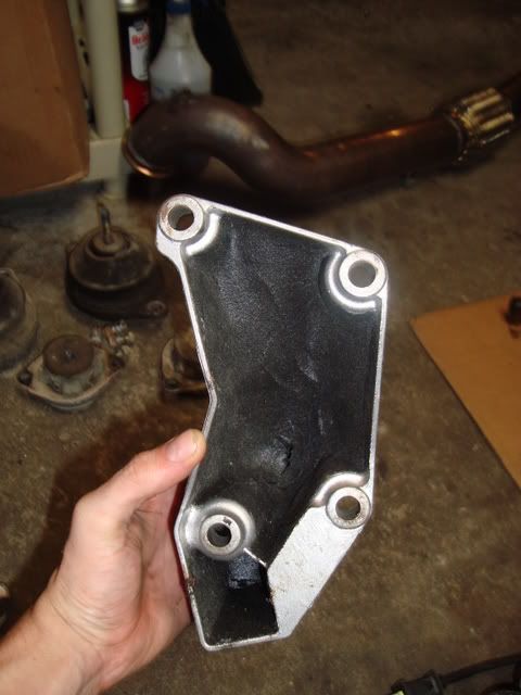

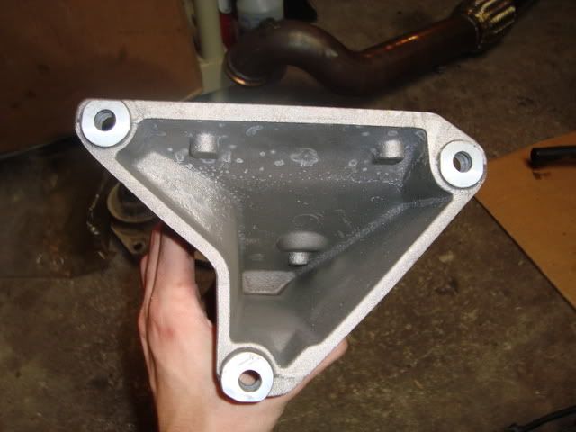

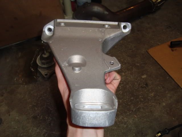

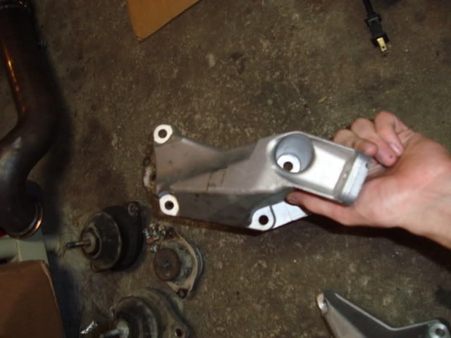

just got the passenger side mount bracket in the mail today via VAGparts, going too see how everything bolts in tomorrow afternoon hopefully.
This mount is out of a b6 passat, it bolts right up to the 06a block, but does not bolt directly into the b3 chasis, i will be sure to take pics as to what i do in order to get the bracket to bolt into the car come tomorrow...
This mount is out a few different euro spec chasis',anything with the ABK,ACE,ADR engine codes...it bolts directly to the 06a block(and the 058 block, as well as the 2.0l 8v block) and right into the car.
