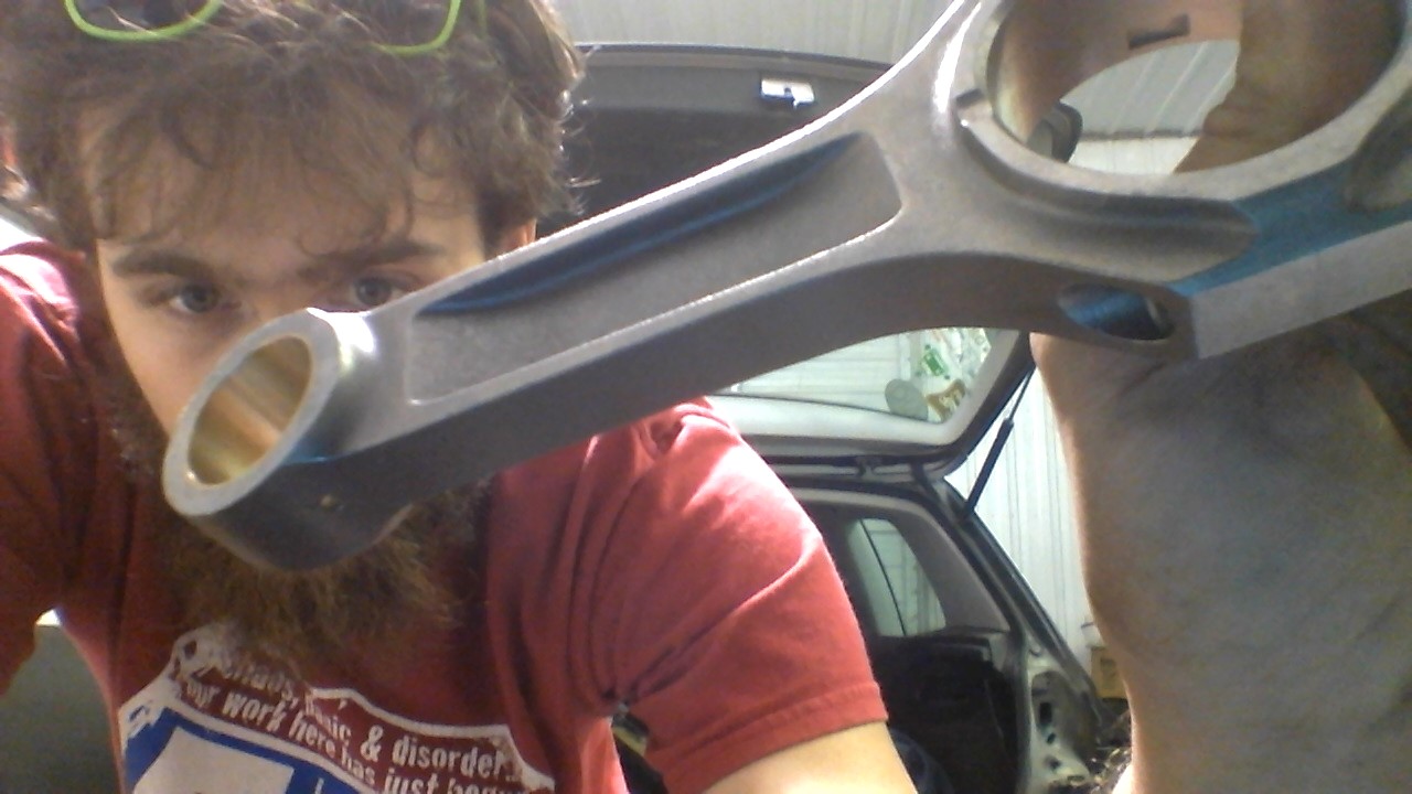

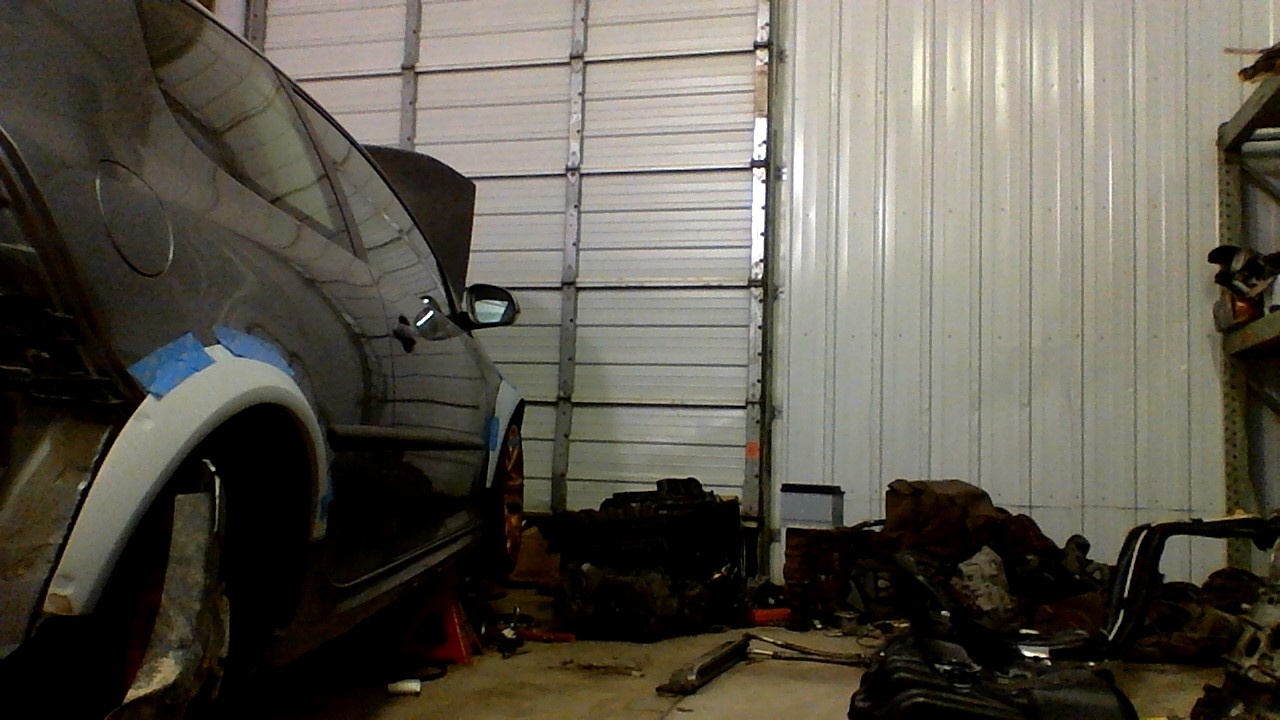

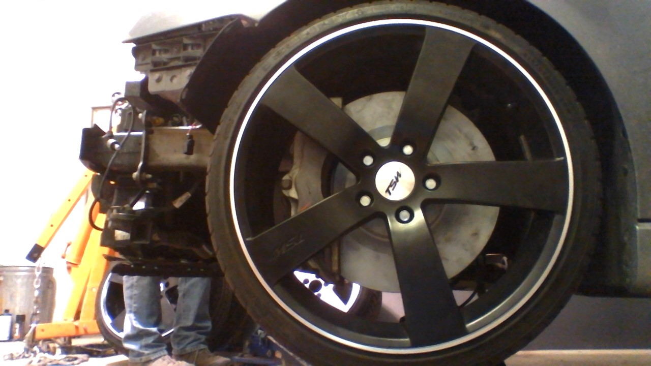

Some more pictures
Rods
Rods
Flares test fitting
Flares test fitting
18z brakes under TSW wheels

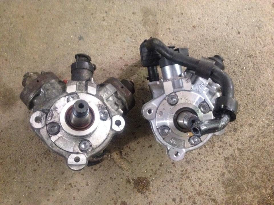

Finally have what looks like the solution for my biggest issue with the fueling, how to make the GM LML twin piston pump work. The issue is the stock cp4.1 fuel pump is a single piston with a single feed, the cp4.2 found on the GM LML duramax is a twin piston with 2 feeds. The pressures involved here are way above where I want to be testing untried solutions. I've been digging around on sled pulling and big truck tuning forums to try to come up with a safe solution for routing the 2 into 1. After finding a few "ghetto" solutions using fittings from water jet machines I found my answer. It came from the VAG parts bin. The 2.5L Euro crafter engine is a revamped version of the 2.5L I5 tdi some are familiar with. It takes the standard engine lowers compression with new pistons and upgrades the fuel system from a VE pump to common rail. So it has a common rail fuel rail with 6 ports, uses the same sensors, and has the same size return as the stock rail. Took some digging, but I finally got a measurement on one and it appears to be short enough to fit it on the head and still be able to have room to get to the injectors.
So with that ordered it was on to finding the pump, which I found on craigslist locally. So I have 2 of the major hurdles for fueling done. Now trying to find either different nozzles or someone that can upgrade the current nozzles i have. No one has done an upgraded VW CR nozzle yet that I know of as no one has run out of fueling yet, but I'd like to get more fueling in a shorter time to keep timing tighter. The goal is not the smoke like a freight train, I want clear power which is more difficult to do then the standard crank the fueling and go tunes. The keys I think are higher rail pressure and bigger nozzles. This means I can deliver a finer mist from the larger nozzles and have it burn more since I can keep the window it's injected in the sweet spot.

well got some more work done, seems the new fuel pump will work quite nicely once i build a small spacer shim to move it back, but the gear and everything swaps straight across from the VW pump. So I should have that issue resolved, next figuring out the fuel lines on the new rail.
CP4.2 from duramax next to the cp4.1 from the VW notice how much bigger it is.
