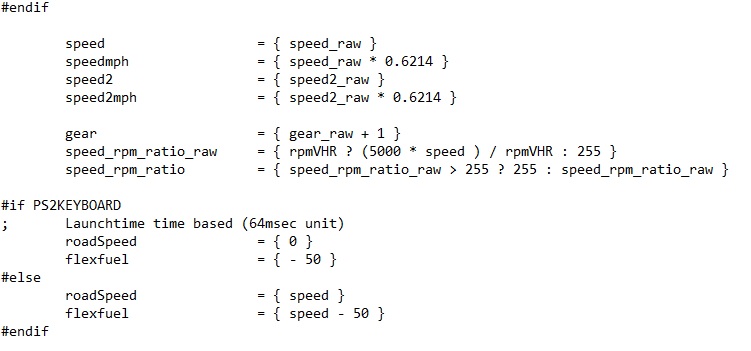

Has anyone located or accomplished this in VEMStune? Currently my 190 speed sensor calibration is correctly showing 74% ethanol and my roadspeed gauge is displaying either 124 or 135 km/h the two times I've looked at it live or in a log. I have located roadSpeed numerous times in the 1.2.38 ini text so is that where I should be modifying the road speed gauge's reading from? My suspicion is I'll need to edit something in the portion of the ini file I've attached below probably. I'll do some tests before the day is out with that theory. Thanks to everyone that drops by and learns something or helps in some small way :flag:
1.2.38 ini.jpg (53.26 KiB) Viewed 18051 times

Apparently after setting up my anytrim it's actually referencing the 124 or 135 km/h which I didn't see coming. I'm not sure which setting I would modify in the ini after that realization.
I almost positive this is what I'm looking for to change the readings accordingly:
https://vems.hu/vt/help/v3/v3_speed_sensor.html
Also those two gauges, wheel speed and road speed, don't appear to read independently of each other in values so I'm looking in the wrong place clearly.
