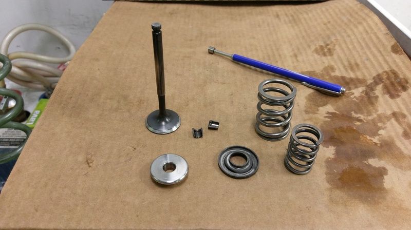

Well FWIW at least it doesn't look like there's valve kiss marks on the piston, do you know the status of those valves yet?
Re: Alex G's URS6 AAN K24-7400 build
That's what I was thinking. Why do you think the valves might be bent?

I haven't disassembled the head yet to test. I suspect the intake valves on #5 are bent because it gets harder to turn over by hand when they move. Same portion of the cycle.

It might just be where they're located with relation to other lobes in terms of effort, have you tried going the opposite direction? I've never seen bent valves without kiss marks. I have seen valves halfway embedded in pistons before though haha

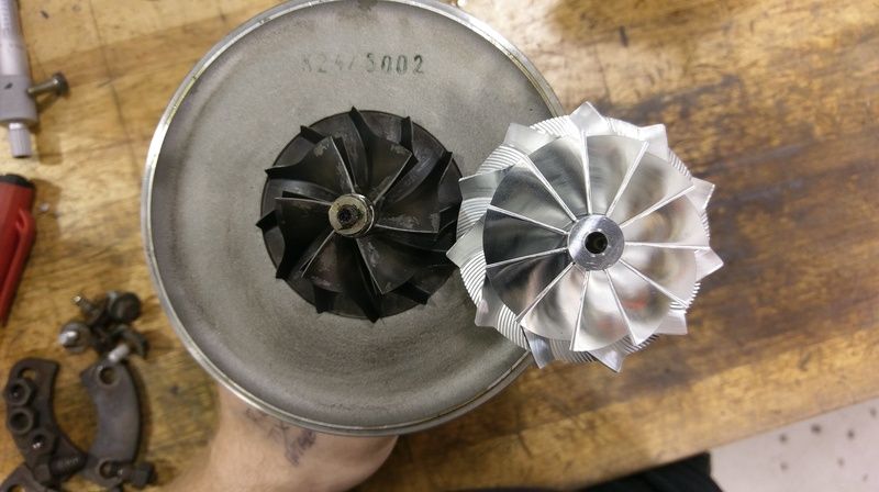

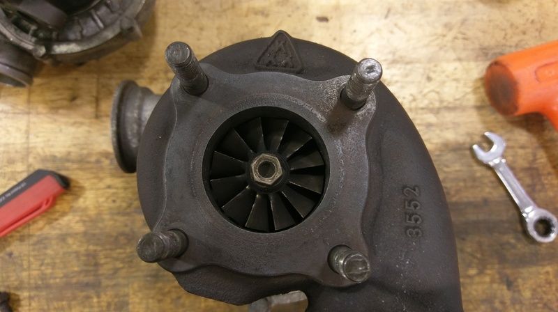

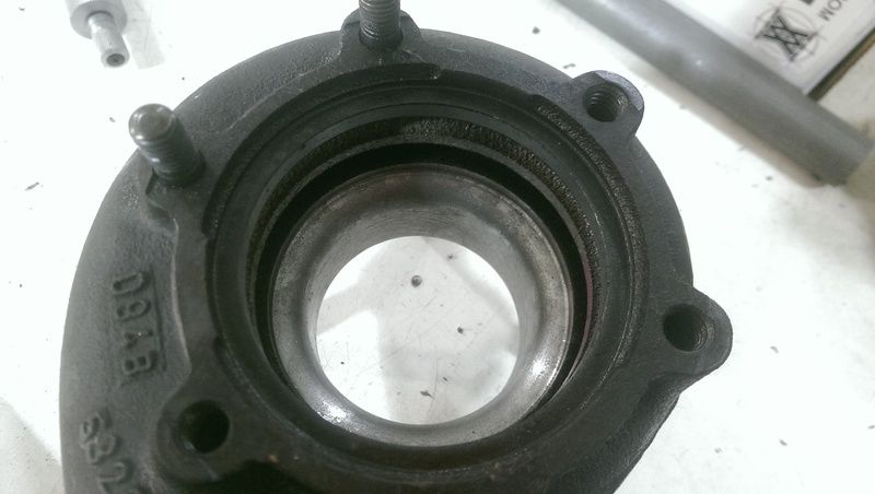

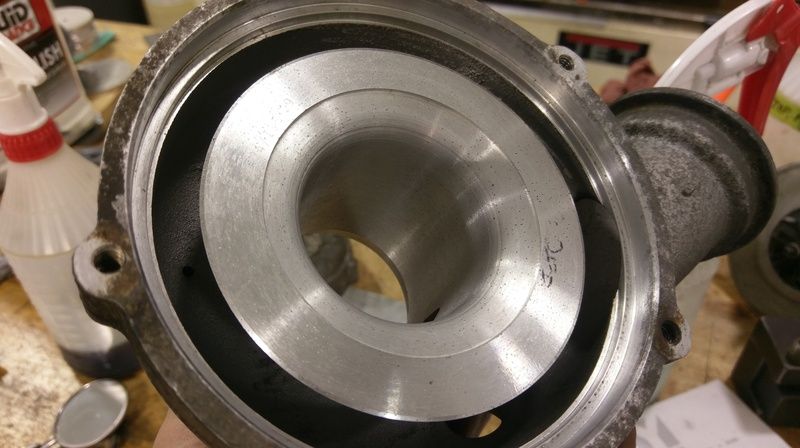

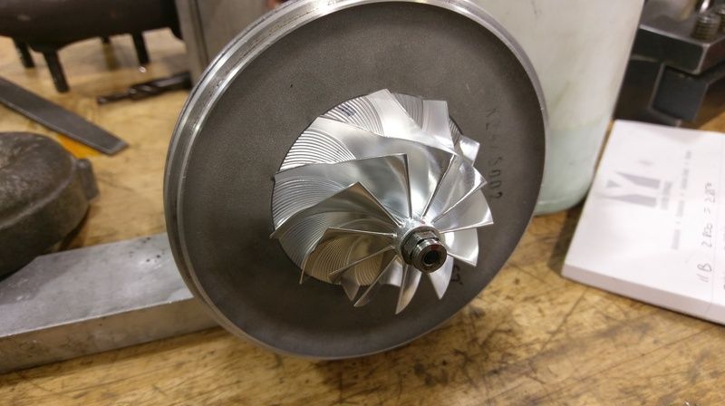

Finally making some headway
A little too fast for the little brute 7000
Machined K24 housing anyone?
7000 under the machined K24 housing

I finally got my tune dialed in on my 200 running the 7400, I love the setup. Drives like stock but pulls like crazy. I think a billet wheel is in my future...
PLANETARY4
- Posts: 39
- Joined: Mon May 23, 2016 8:13 am
Cool, I'm excited! I think later I will install a ARD billet wheel.
What turbine housing are you using?
eesh. too much clearance on that turbine outlet. you're looking for closer to .040" total clearance. that looks like about 4 times that.
PLANETARY4
- Posts: 39
That picture is the 7000 not the 7400. I was showing the difference. The 7400 fit is .040" offset from the profile
Alex
'90 V8q
'95 S6
'90 V8q
'95 S6
reading helps sometimes. I see the caption, missed it the first time. carry on.

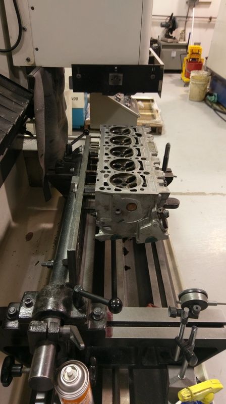

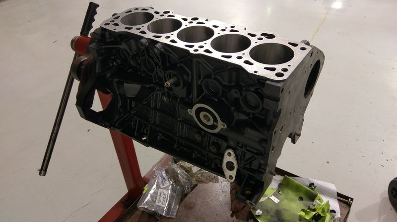

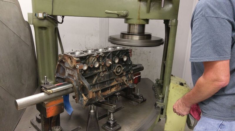

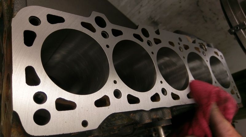

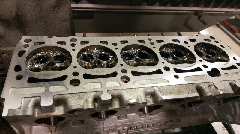

I can now focus on this project.
No bent valves! I surfaced the head, decked the block, honed it to 81.5mm. I'm awaiting Wiesco pistons from FRP.
I took only .003 off of each. Not bad.
I plan to port match the RS2 EM.

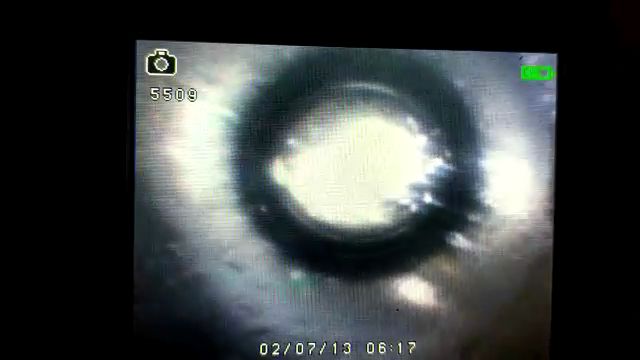

Deburring the bottom end. I cleaned up the oil galley. I took a video of a bore scope through galley. Woot!

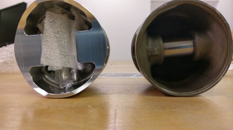

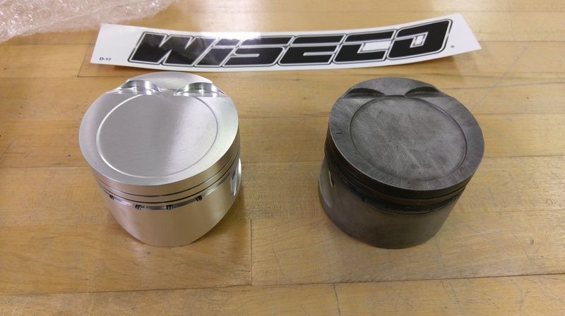

Re: Alex G's URS6 AAN Billet hybrid K24-7400 build
oh heck ya! I love aftermarket pistons just for the weight savings.
PLANETARY4
- Posts: 39
can you really feel the response difference?
