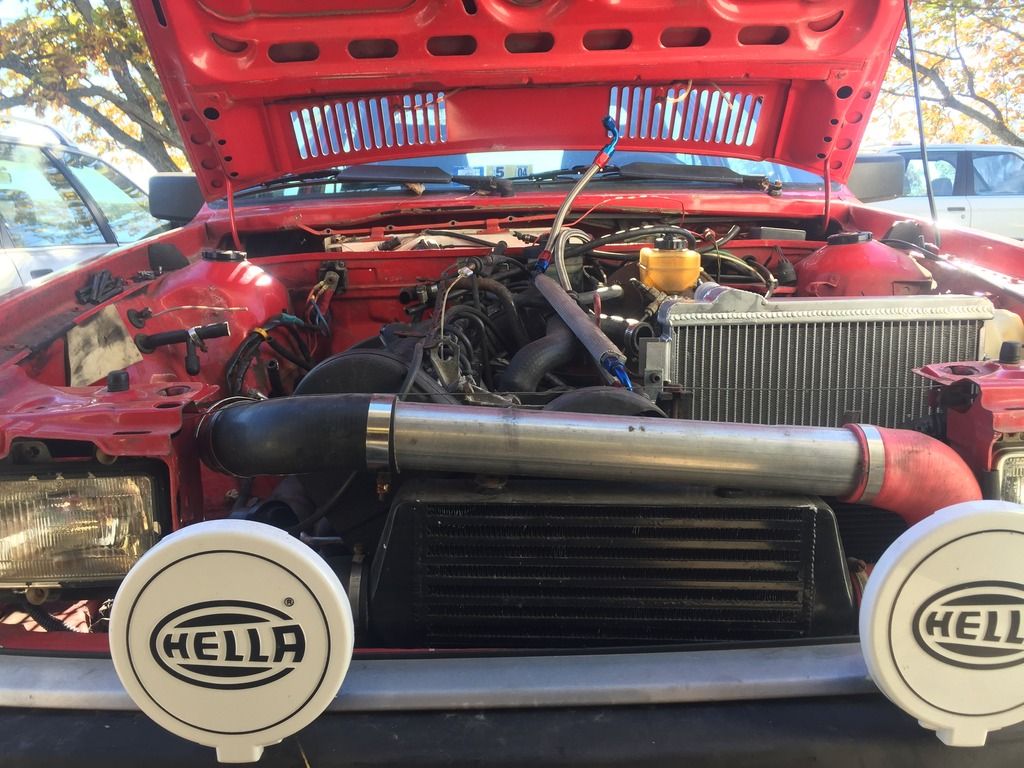

So the project car is an 1985 4000q. It has the mc1 from the 88 5ktq. NF head with 034 larger exhaust valves, headstuds, mls headgasket, dialynx exhaust manifold, k24, front mount ebay intercooler that is slightly larger than a urq intercooler larger oil cooler mounted in front on the radiator. 3b clutch and flywheel. 5ktq trans with an urq rear diff. Lots of suspension upgrades. Interior is black leather I swapped in with good door cards and pretty beat seats. Im running CIS with a wide band to keep it in check. Running about 18 psi right now. Cant wait to ditch it, not that I hate CIS, im just excited to learn about stand alone and cant wait for a little more power. I just did the 5 lug swap and have a few questions.
I used 5ktq front strut housings, 5ktq struts, g60 brakes, comp brake strut mounts, mark 2 gti tie rod ends, 034 bent tie rod, 034 urq ball joints, a1 racing sleeves, adjusters and hats and helper springs with eibach main springs, flat bearings on the spring seats. set ride height a little lower than stock maybe. The comp brake strut mounts don't seem to engage quite enough thread for my liking since the 5ktq struts don't have as many. I think im going to switch to urq bilsteins to remedy this. I love how they feel, I hope they last as they seem to get mixed reviews.
I set the alignment by, setting the wheel straight ahead and then measuring from the front of the tires, tread to tread and then the rear of the tires until the were equal. I also measured from the inner tread to the sway bar mount bracket and tried to keep those measurements equal as well.
The car rides great no noises and feels tight. The steering however feels very darty and touchy. Its very noticeable on the gravel road I live on. A little steering input goes a long way and seems to need constant input. feels a little scary at speed on the gravel road.
I was wondering if I could have bent the tie rod to much or in the wrong spot? I had to bend it more since it was hitting the down pipe. Put it in the press at work and made some adjustments with a hammer on the floor when I got it home
Does it matter I switched the mark 2 tie rods, left on the right and right on the left? Seemed better for tie rod clearance.
Ive been reading a bit about bump steer and steering geometry and wonder if this might be my problem. I know my alignment is pretty slack but ive checked it a few times, and have done this type of alignment before with much better results. I fully plan on getting a 4 wheel alignment but I don't want to pay for one and then need to tear it all back apart. I know this swap has been done many times so I just wanted to get some input before I take it in to get it aligned or tear it back apart. gonna try and add some pics here too.

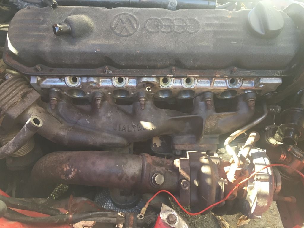

Just got my vems from Marc and and have started the efi conversion. Before I put the 2871r on I wanted to get it tuned on the k24. Problem is the intake just won't fit with the dialynx exhaust manifold and intake spacer and the Fuel rail won't fit with out the spacer. I've ground as much as I can from the intake I believe. Does the updated 034 rail fit w/o the spacer? I think I have an original version or home made. Picked up a 034 20v header 3" dp and 2871r maybe best to just go ahead and put that on and be done. I feel I'm going to need more intercooler to really take advantage though. I wanted to go in steps to save down time, learn VEMS. What do you think?

Ive ground and ground on my intake and cannot get the intake to fit with the spacer on the dialynx manifold. So im gonna just go ahead with the 034 tube header and DP. I have a 2871r that seems to be in ok shape that came with the setup. I was thinking of picking up a gt28rs or maybe the volvo k24 7400, have to check what flange it runs vs the 034 header. My goal is around 300hp, with good drivablilty and quick boost. something fun for rally cross and windy gravel roads. You can see above that my intercooler is not the greatest so Im a litte concerned about throwing the 2871r on there and turning it up to where it would be fun. Im looking for opinions on weather I should just go ahead with 2871r or pick up a smaller turbo for a little better response. So anyone who's run a 28rs, volvo k24 7400 or the gt2817r let me know your thoughts. I do have a 1.8t avant that the 28rs could end up on if I decide to upgrade to the 2871r...
