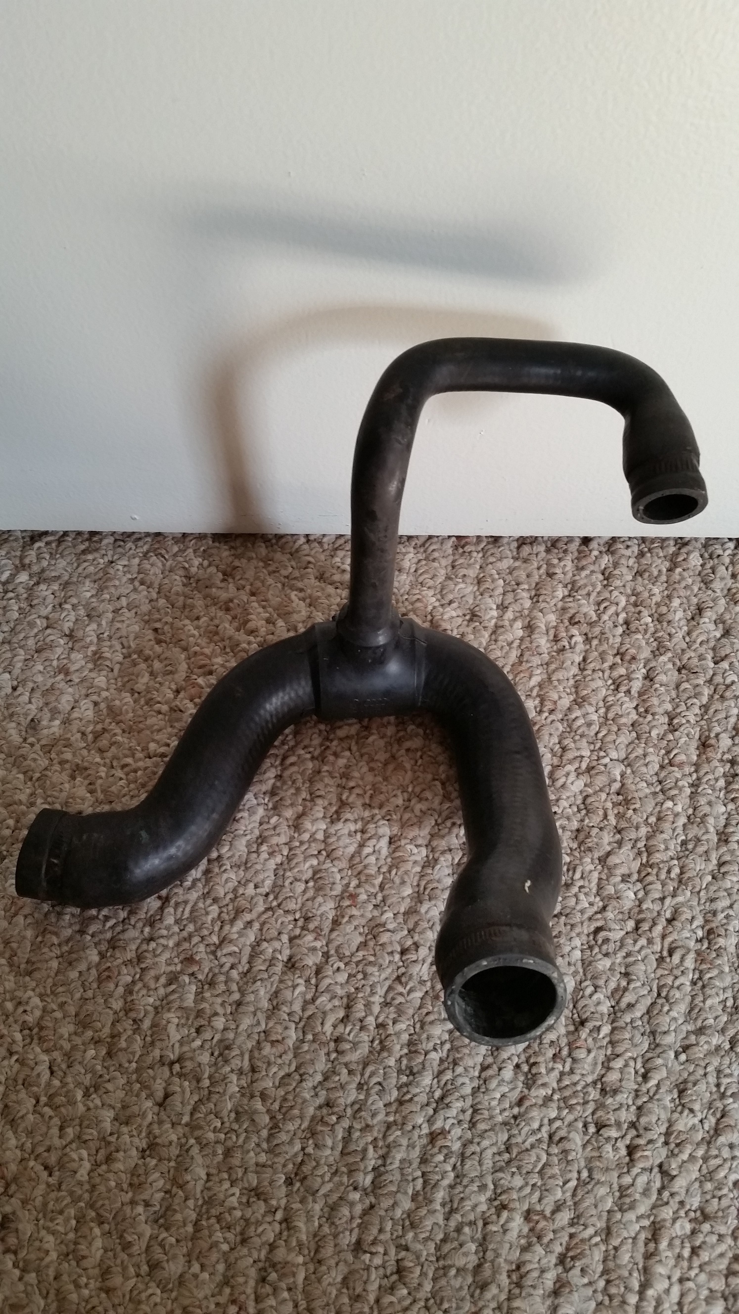

I asked on the UrS forum on QW, but what do you guys do for replacement hose in terms of the turbo coolant return line (under the intake manifold)? I cannot find the factory hose anywhere.
Re: Mike's 200 20v avant
I used some 3/8" silicone hose for my 20vt. I know it will fit the factory metal part, only because I was sent one for a 20vt on accident.

Mikey, is this a coolant hose you need? It is NLA, and I happen to have a mint used one. :D
World Impex use to be able to get them I do not know any longer. Last check they sold thru there for $137.
PN# 447-121-101-S Reg. OEM Audi retail was: $160 new
