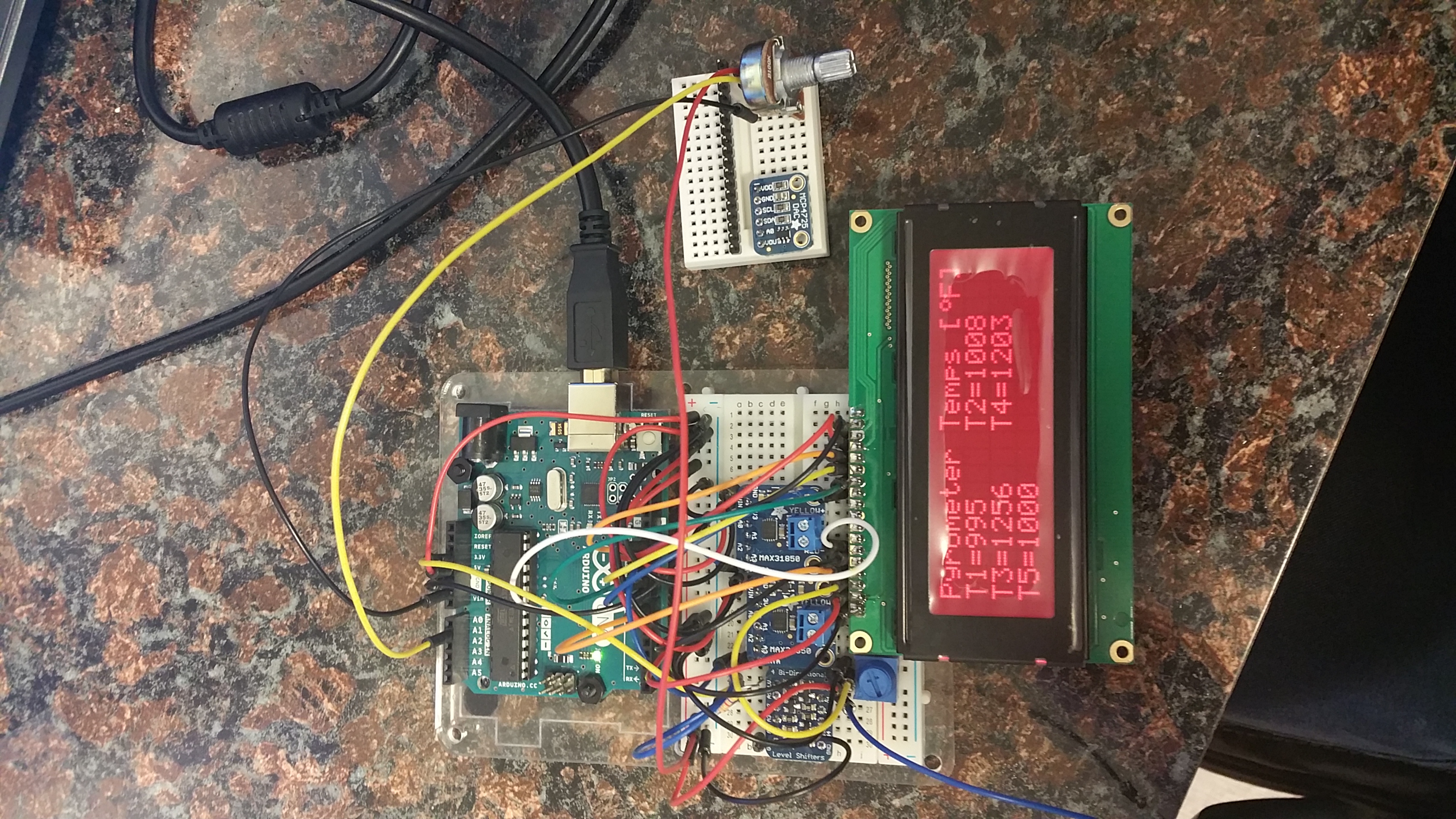

I'm currently developing a solution for us 5 cylinder guys (can be adapted to any number of cylinders, really) for per-cylinder EGT measurement and data handling.
Features:
-5 type-K thermocouple amplifiers
-RGB LCD which can be set to any color you wish and will display all 5 thermocouple temperatures simultaneously
-5 0-5V analog outputs for sending to any engine management or datalogging hardware
-Alarm/buzzer/siren output for an audible warning when ANY of the EGT's exceeds a preset value
-Visual over-temp warning via red LED mounted near the screen - possibly blink the offending value on the LCD screen as an additional indicator
-Peak and hold function for the gauge
You simply cannot find anything out there with this feature set, so I am taking matters into my own hands.
The only hurdle I am running into right now is getting the thermocouples to output more than 1000 degrees Celcius. I think I have a way around it, but it probably isn't necessary. Does anyone see the need to measure more than 1800 F? If not, things will be slightly simplified.
I am open to suggestions for more features.

It's already up and running actually. At this point, I'm just refining things and haven't put almost any thought into packaging yet. I could provide a kit of components at this point for you to package yourself, but that's about it.
I've only been working on it for about 3 days though, so it's just a matter of me spending the time to finalize component selection and get the packaging deaign part going.

You should be tuned for below 1000C all the time, the only reason you should want to read above that is if you are curious to how bad the meltdown was ;) I guess there could be some peaks above that, but that's pretty edge case. I think for the masses 1000C is good and pretty standard.

What do you guys want in terms of packaging for the screen? As you can see, the one I have for prototyping isn't the most compact thing ever. I think a 20x4 character one works well for 5 readings. You can't easily get 5 on a 16x2 screen. I might be able to get a smaller 20x4 though.

The order is in for the thermocouple amps. I'm having a run of 10 produced. Now for some questions for you guys.
I'm still struggling a little bit with lcd choice becuase it's hard to find one with enough space on it to fit all the readings (at least 3 lines and 16 characters wide), but also is small enough to make sense for packaging in a car. It's even harder to find one in a size like that while also not being a hideous color. However, I have found a potential solution, it's just that there will have to be some balancing done with the cost. That brings me to some questions for you all:
Does anyone NOT want to be able to use an lcd to view the temperatures at all times? If not, is there some other alternative you would want to use? (besides Bluetooth to another device... That's for later). I will of course offer a plain amp without an lcd, but then you dont get alarm functionality or a gauge (duh).
How important is it to you to have the correct color?
How do you envision mounting it?
I've found a smaller lcd which can still display the data I want while fitting in a reasonable amount of space (like the coin area in a 200 20v center stack). The problem is that the cost is higher if you want rgb (and thus the ability to make it any color you want ans match our instrumentation). It can also be had with a plain red backlight for a lot cheaper.
I can also get a smaller than normal 4 line lcd. It is available with a green/red backlight which would let us mix any kind of red or orange. This great for our cars. But it wouldn't work well for other cars with different colors. 4 lines isn't necessary either, it's just nice to have. It would be necessary for a v8 or v10 car though unless you wanted the screen to swap between banks of the engine periodically.

Now that I think about it, I can offer any lcd you guys want on a per-order basis because there is no need to make an enclosure to fit the lcd. I don't know what I was thinking. For some reason I think I was thinking I would have to be packaging this with all the other electronics. I'm a big ole dummyhead.
I'd still like to know your preference though. 3 lines will only allow the temperatures themselves to be displayed. 4 lines will allow a header/title/info line at the top of all the temperature data. If you think you have a better idea of how to present the data, I'm all ears. I can do whatever we all want!

I just realized that the display in my picture above is the exact same one that vems uses. Rgb is a huge upgrade to a single color lcd, and the rgb one only costs $25. LOL the profit margin on the vems display is quite large. There is absolutely nothing special about it. You can buy that same exact lcd for $15 and just wire it up the same way they did to their connector.
My solution for the lcd should be a lot nicer and fit in a lot more places than the vems lcd. You could even use it for a vems lcd if you wanted... Sweet! Maybe I'll come up with a slick way to do that for you guys. Sorry to vems and the vendors, but this is too obvious not to do.

I don't have the LCDs in hand yet, but I did just order them. I'll take a picture next to the vems LCD so you can get an idea of how they look and the scale of both. I'll dig up a standard picture of one in the meantime. Either way, I can offer pretty much whatever LCD you guys want. I just wanted to find what I think is the best solution so you guys are informed. It's not easy to find a 3 or 4 mine lcd that isn't the exact same one used with vems. That must be the most common one period.
Yes, it will do the gauge, alarms, and analog output (for use with vems or whatever else you can dream up) all at the same time. What I meant was that if you don't have a need for the gauge and alarm, I will offer an option without those at a significantly lower cost. It'd just be those $60 thermocouple amps, plus the cost of a case to put them in. Or I could just offer them completely by themselves. You just let me know what you want/need.
