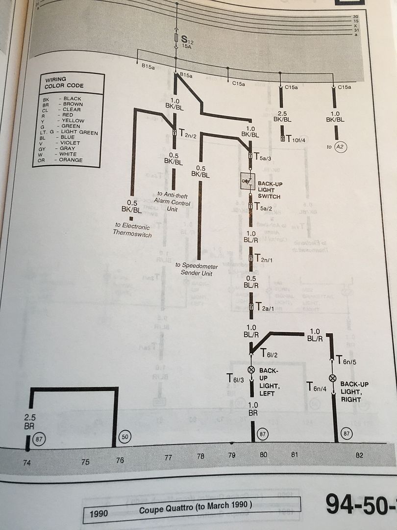

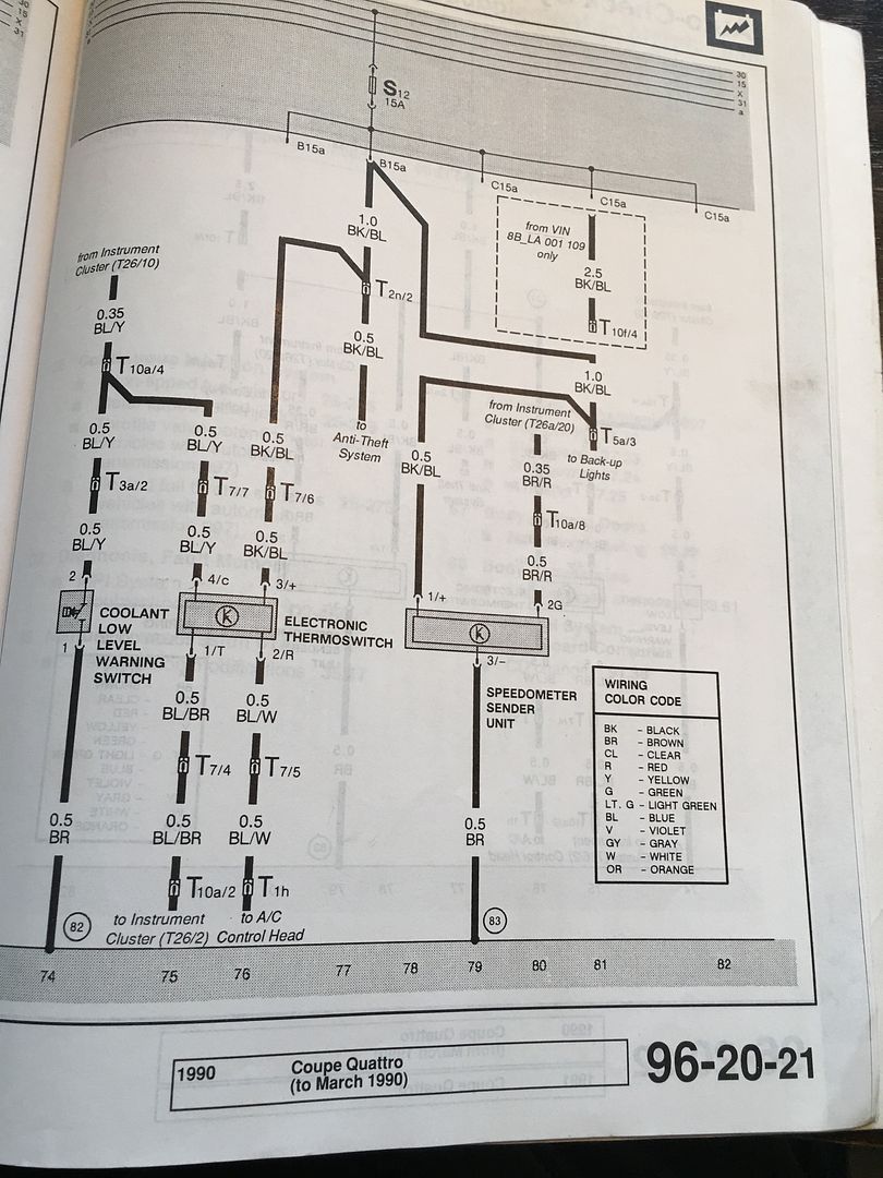

Aren't the T5 and T3 the speed sensor and backup light connectors? Both connect at the transmission I believe. I'll check when I get home
CURRENT
PAST
Grillage
Posts: 863
Location: Cincinnati, OH
Re: 7A harness dissection, VEMS prep
Post by Grillage »
Yep - 5 pin is the backup light connector
The 3 pin is for the speedometer sender unit
Both attach on the transmission
