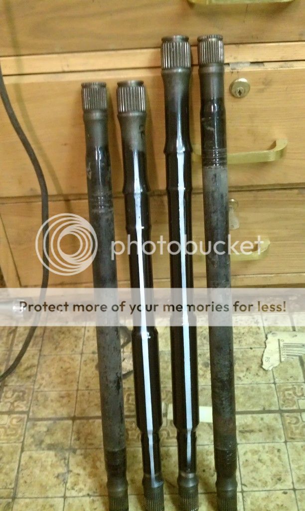

Adam, i have shortened 5000 axles in the rear in my URQ after busting the original URQ shafts(by way of twist). I modify them by cutting them on the factory friction weld. I then press shorten the shaft, press in a chromoly plug, pin the plug, do a 3 pass weld to get it up to the shaft OD, then slide a moly sleeve over the top of the weld that has been turned down. It ends up being REALLY strong. I can usually do it in about 1.5-2 hours which ends up being around 125$ per shaft. Sound expensive until you spec out DSS shafts. I mark my axles to see if they are twisting, and the ones I sleeved to shorten are MUCH stronger than the OEMs. 650wtq clutch drops on 255 R comps without issues. Same couldn't be said for oem axles.
Here is a picture of some I shortened for a guy wanting to run 108mm cups in a 4kq that couldn't find URQ axles.
Other plus is that you wouldn't need the spacer, as I could make the axle to the correct length. This saves 75$, making the added cost of the axle a little more tolerable.
