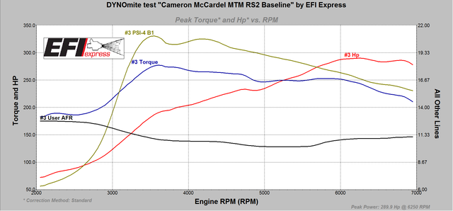

I picked up your car from Haydn's place on Friday. your parts came back from swain the same day. everybody loves a little pornography:
this one came out a bit fuzzy, sorry. maybe its already trying to go fast?
baseline'd the car on the dyno today as well.
next up we'll pull apart the manifold and turbo and start the install process. might take a bit as we are slammed right now but I'll keep ya posted.

Damn, Marc out of nowhere. Awesome! That baseline is not too bad, not very much boost it seems like. But it looks like a very strong place to start from! I can't wait to see the "after" graph... and especially interested on how the QSV performs on this setup. Glad you're here!

About what I expected from the dyno. Glad to see it is so low. Going to feel great with 200 more whp. I bet we can even improve on the spool. Hope the clutch can handle it. The e-brake is nonfunctional as well. Excited to see this progress!

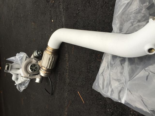

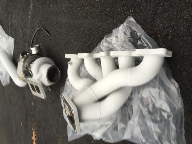

All,
Marc has been a busy bee-
Borg Warner EFR7163 .84a/r TS w/ QSV is installed - Swaintec White Lightning Coated Hotside, mani and dp
Iroz Header/DP installed
Apikol FMIC installed
VEMS is in
External oil cooler is relocated to original airbox location
Up next is the fueling upgrades (E85 w/ Zeitronix ethanol content analyzer, gauge, Bosch 044 in tank) and possibly a new clutch (HOPEFULLY NOT)
BONUS: w/ its' brother the 360hp 3.92L M635CSi (Dinan stage 2 stroker motor), cosmetically all original

From Swain's website:
"The melting point of White Lightning™ is over 3,000°F and there are applications where the coating would stay completely intact at temperatures well above temperatures that can be reached on exhaust parts. However, what can damage our coating or any coating, no matter what the “temperature rating” is would be if the base metal of there is a differential of expansion between the base metal and the coating greater than what any coating can expand."

Car is being dynoed as we speak- should be ~500whp/tq if clutch holds.
