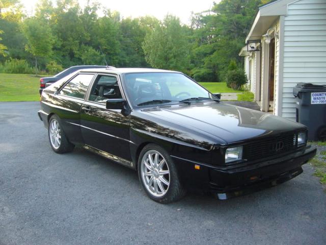

This is how the car started, 1983 Audi Quattro:
I bought it with a blown head gasket about 6 years ago knowing it was going to be a go-slow project. At first I was thinking I'd AAN swap it but knew I wanted an 07k after playing with hank's various small chassis 07k builds at battleborn.

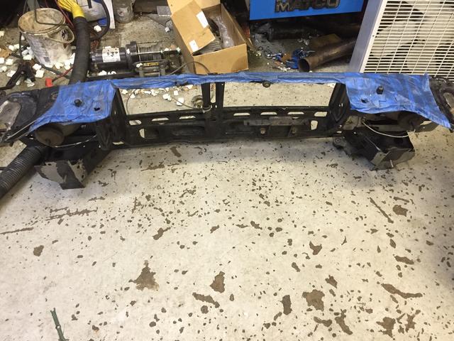

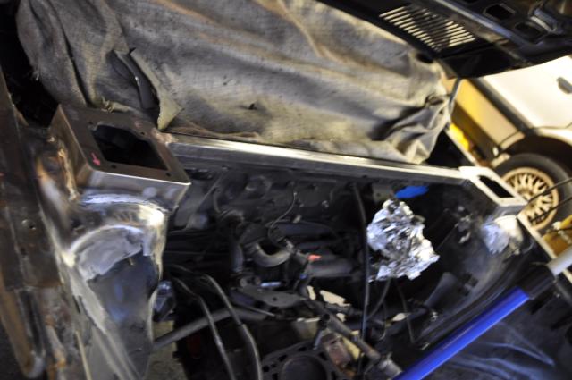

I also wanted to devise a nice removable core support so I cut the framerails and fabricated mounting plates with locating pins so it can hang without bolts for easy alignment

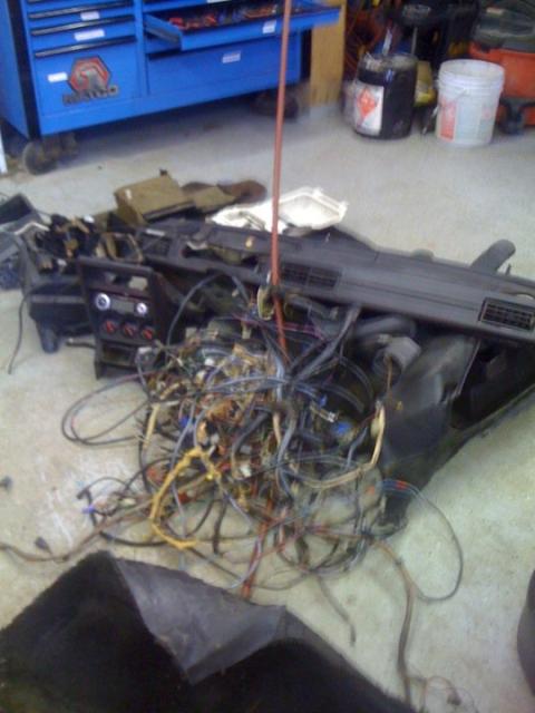

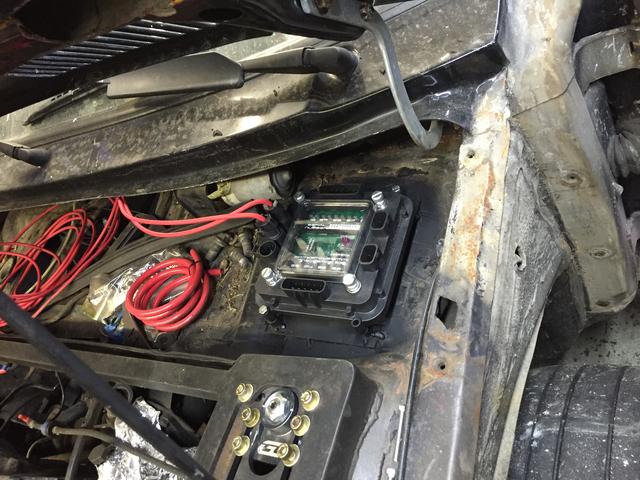

all the factory wiring got pulled out, replacing all of it with can-bus master cell modules

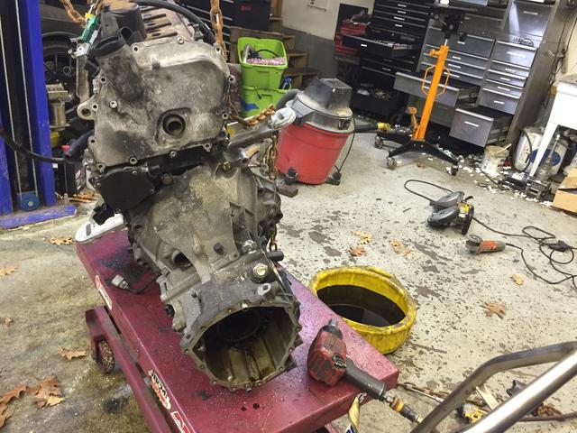

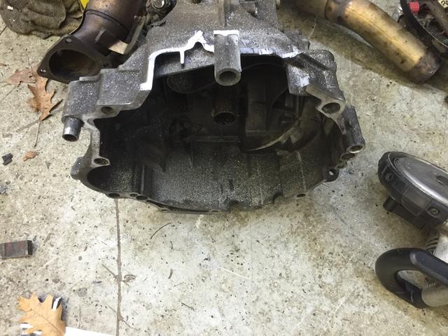

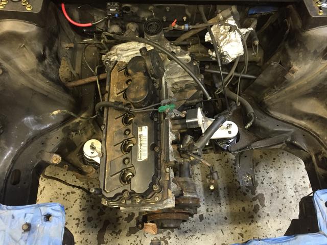

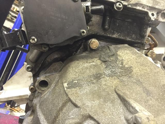

fast forward to this weekend's progress. I finally got around to preparing my mockup motor for mounting in the chassis so I can start fabricating around it (radiator, intercoolers, turbo/EM, etc). step one was preparing an 01e (or part of it). the cuts are pretty easy thanks to Hanks help with a printable template. I still have to weld back in support plates but all of this is for mockup so its coming back out (probably multiple times) anyway.

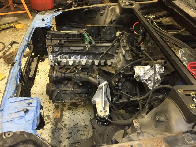

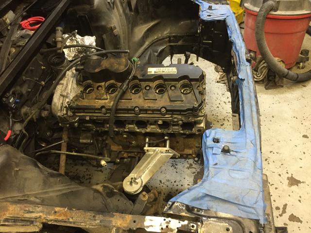

and setting the motor in the bay

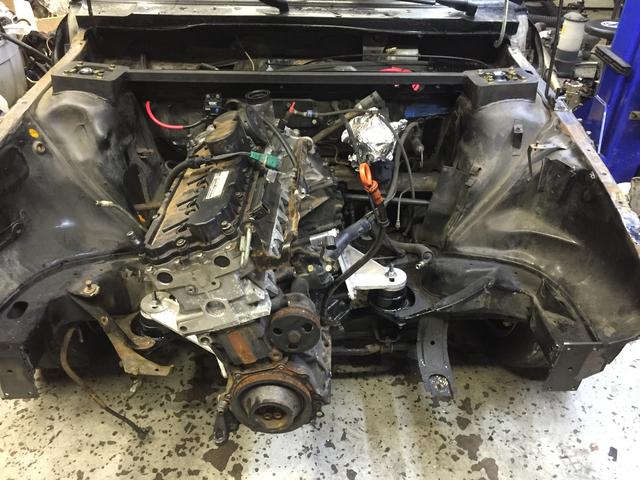

subframe and frontend on. look at all that frickin room!

the can bus stuff is called a "infinity box". (it was called an ISIS mastercell. sucks to be that marketing department!)
http://infinitybox.com/
waytek carries them:
http://www.waytekwire.com/item/80150/J1 ... Cell-125A/
Re: Marc's 1983 Ur Quattro 07k build
How many circuits are you doing? I planned on doing the ISIS/infinity setup on my 968.
Sent from my XT1575 using Tapatalk
Posts: 1586
its a two power cell system plus one master switch cell and one window motor controller. one in the trunk, one in the engine bay, the master and window module in the cabin.

Ah, that ISIS stuff is pretty interesting! ...the wiring that is. definitely tuned in for updates on this.

Wow Marc, I have never seen such a cool system for can-bus. Awesome stuff, I can't wait to see how it works out for you!

Very interesting that Powercell/Can-bus stuff, major upgrade from the nasty early urq wiring.
