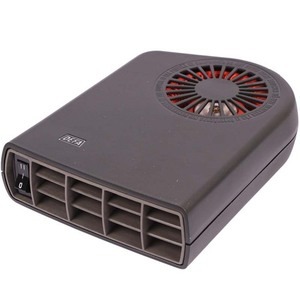

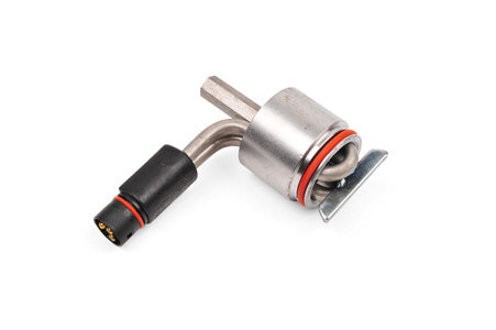

Greetings from Finland.
My experience is from Defa-series
Have 200 20v avant and have block heater p/n 411393
You can buy a loom with a splitter to cabin where you can mount any interior heater you want.
I used defa termini 2100W. Melts snow from the roof -5F.
Most common setup in Finland.
You can also buy webasto or Eberspächer petrol powered heaters, if you dont have long drives then its no good as it will eat the battery. These heaters can be wired to heat interior aswell, they pump the warm water around the engine and you can make it control the blower.

Thanks stin! How hard is it to remove a freeze plug on these engines? I have a 200 20v avant too.

The Defa heater in your first picture looks very close to the one VW used to sell for my 1.8T GLI (Bora) - but they don't offer them any more... any suggestions on the best place to buy the heater and the basic extension-chord connection?stin wrote:Greetings from Finland.
