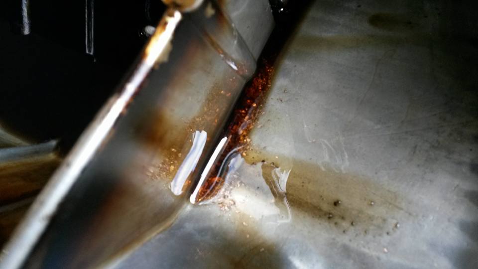

hank iroz seems to thing its me playing the launch control that killed it. when i got the bottom end from marc i pulled the pan and had a peek but i didnt pull any caps or anything because i figured if marc said it was good i'll take his word for it. i feel i can always trust what marc says and im not mad at all about it, shit happens and it was probably my fault. also i figured if its good as marc said there's no point in disturbing the factory torqued bolts and such so i'll just leave it alone. here's 2 pictures of my findings. cylinder 1 was the problematic cylinder. i caught it in enough time that it did not damage the crank. there is a little tiny bit of bearing material on the cylinder 1 journal but i think some emery cloth and gently sanding it off with some oil to kind of wet sand it will get it back in shape. that old trick worked for my pap years ago when fixing old farm tractors that spun bearings and i did it once before in my 4000 and it worked so i'll give it another go.
i managed to get a new bearing set from summit racing for 36.00. their clevite brand which is a sister company to mahle so i would assume their a good quality bearing. i got them from summit cuz their right across the border in ohio so regular ground shipping is like over night to me. thats a little bit of winning i guess.
- rod bearings.
- 10665762_10153022347086771_7192605113271668688_n.jpg (10.32 KiB) Viewed 33276 times
- bearing shavings in the pan.
- 11947516_10153022237016771_6876694926482730591_n.jpg (39.8 KiB) Viewed 33276 times

Re: why am i killing 20V's????
Hanks thoughts are in line with mine on this.
You should have gone the coated bearing route if it's not too late. I had the same prob as you on brand new kolbenshmidt bearings on a rebuild. Was lucky i caught it immediately after a short run, that deep harmonic ping, crank was clean when i opened it up.
Sometime when the block was separated some crap got in the oil passages and found it's way to the crank bearings or was in the crank passages. Also found some plastic dipstick parts in the oil pan... This is all after cleaning: shooting air in the oil passages with the oil pump off and crank off with a suction air gun and gas. Found out gun cleaning kits are your friend for this.
Fwiw my vote would be more on piston damage vs bearings if it's a launch/antilag issue.
