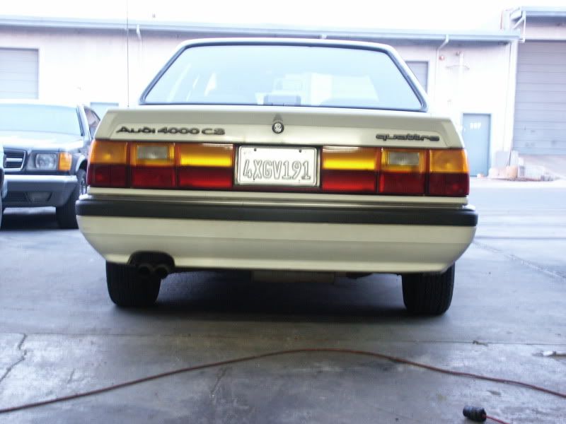

a little history for people who don't know is i started with a plain jane 86 4kq, bone stock, needing a wheel bearing real bad like and a turbo motor even worse. at the time of the purchase i had aquired an 85 KH motor and was contemplating putting it in, but i was so excited about how clean the car was and thought "pfftt, i don't need a turbo motor, i'll just spruce up the suspension and make a header for it, cold air intake, throw some high compression VW pistons in and put a cam in it" weeeeeell the only thing i ever did to the stock engine was stick a 272 blau cam in which gave the car a noticeable bump in mid range torque, but it was still no screamer. i came across a steal of an 89' 200 fwd which was begging to have the engine plucked since it was useless wheel drive anyhow, and my car was lacking in power. i should note now that i traded the 272 cam out for an MC2 cam that has been proven to be a better selection for the turbo engine due to less overlap.
this was at a time when i spent a little time on the internet because it was painfully slow having dial up and i still had more interest in riding my bike and doing things outdoors like riding my quad every chance i got.

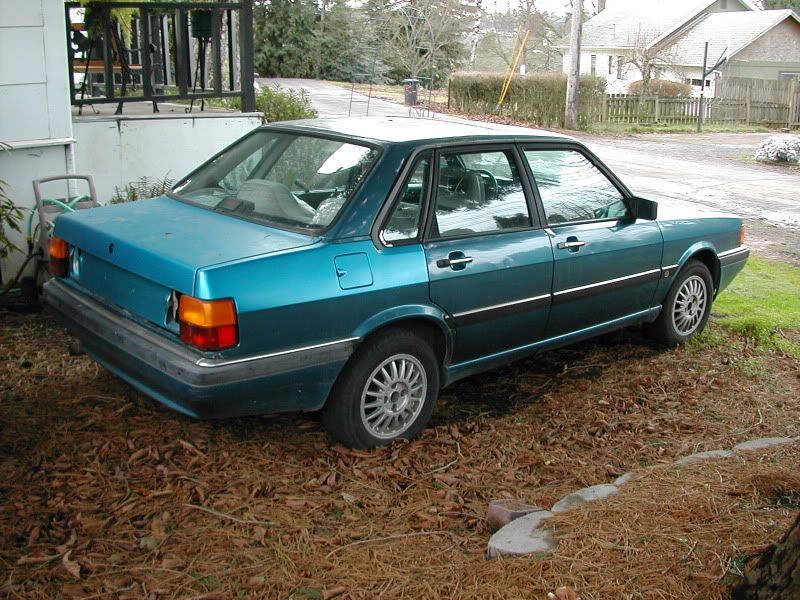

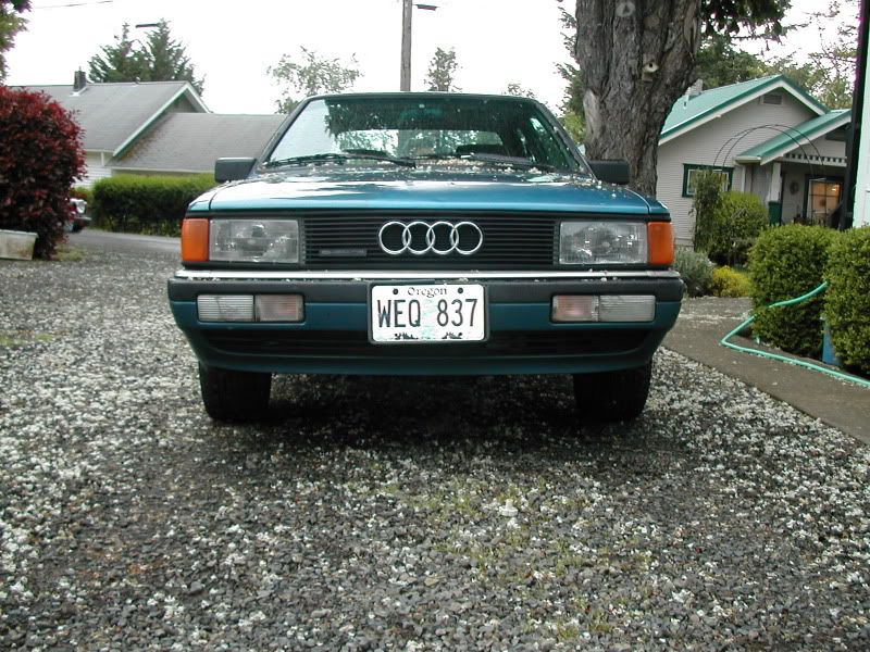

about six months before i acquired my current white 86'(oct. of 2002), i had bought this car...
it was a good starter 4kq. i'd previously never really had any super clean cars so this was nothing new, i looked at it as a project car like i did everything else. but i learned i don't really like doing body work, and the blue one needed a lot, so i put it up for sale and started looking for another one. i didn't need another car, but i wanted one, and we all know what happens when we want another car..... not a single paper or ad goes unread

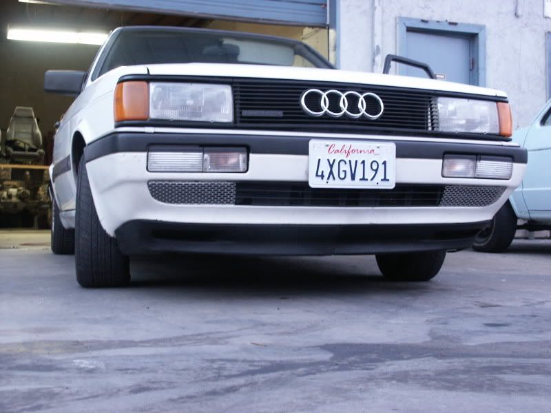

YES! i found my ORIGINAL Alpine 4kq pics WOOOTT!!

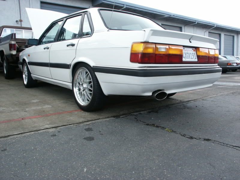

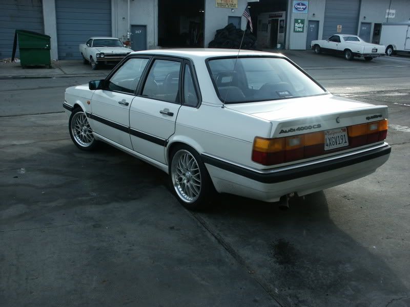

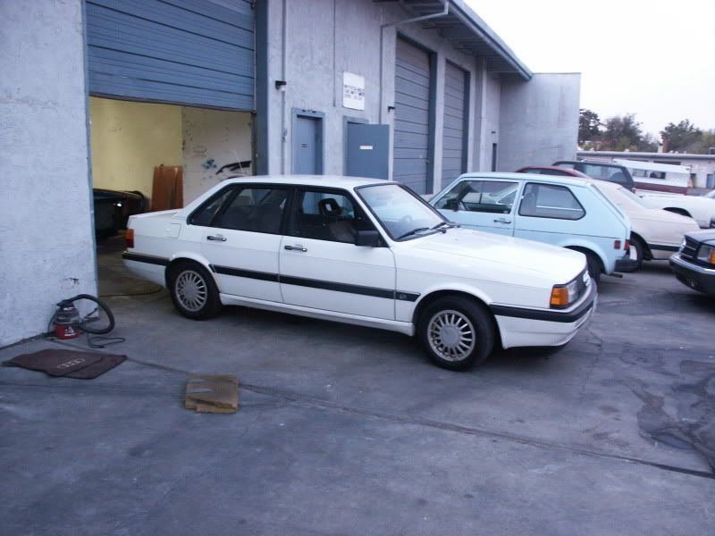

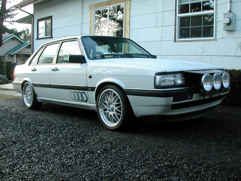

not long after i got it on my birthday, i had ordered my H&R springs and new KYB struts. then i found a set of konig imagine rims and was like "wow, those are haawt" so it looked like this about two months after i bought the car..

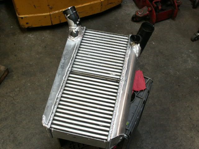

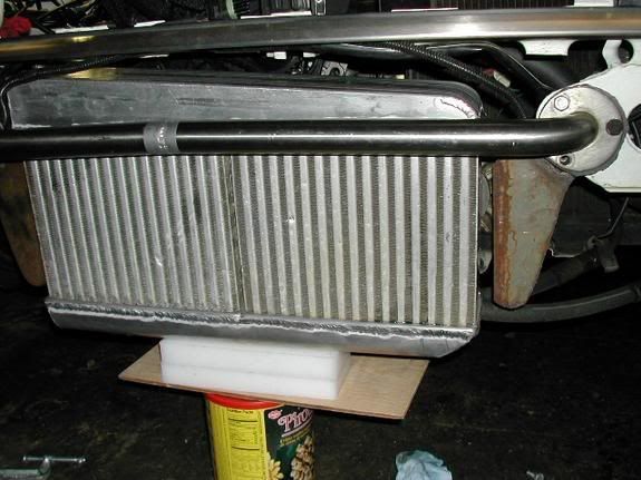

Intercooler

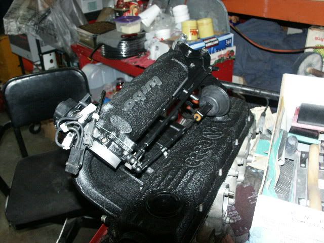

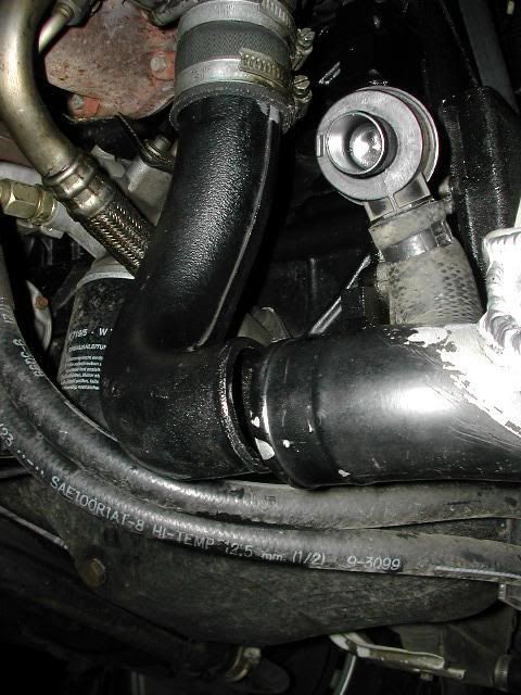

Intake

i finally got my engine in and all the bugs worked out to make the car run decent. it had no intercooler and a tired k26. i thought it ran good, and i guess compared to the cars i had previously in life, it was. as time progressed i got an intercooler installed and dialed the fueling in better. it was always a little sketchy with the narrow band 02. it ran rich for sure, but that wasn't terrible and didn't seem to foul plugs, so it was ok. i was more afraid of running lean and burning it up

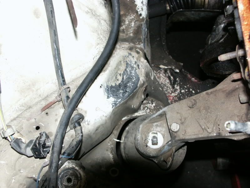

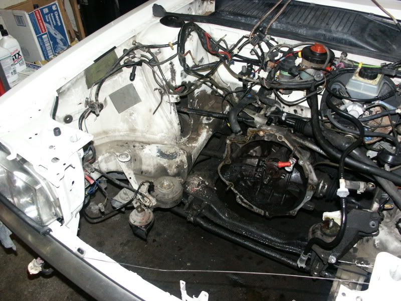

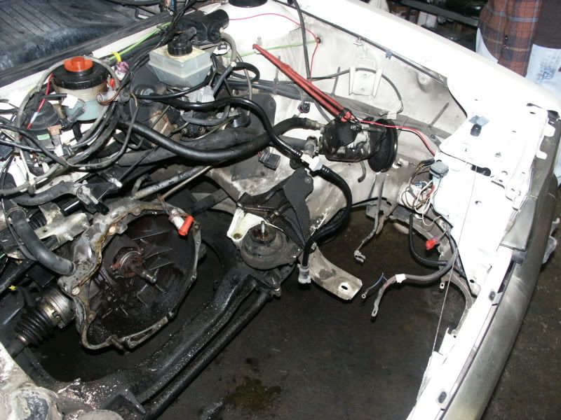

I found out that pretty much every picture i had taken of my alpine car during the 20vt swap, was still in a folder on our old external HD and i hadn't known where it went since, back then we had one shared computer and when it crashed, someone had just emptied the old HD and i never found my pics... so! that was exciting 8) I learned that i didn't take enough pics of the original swap, but meh... take what i can get, right? so, here's a few... i can't believe i can still see the original 20v JT in my alpine car... that was so long ago.
these are all the best

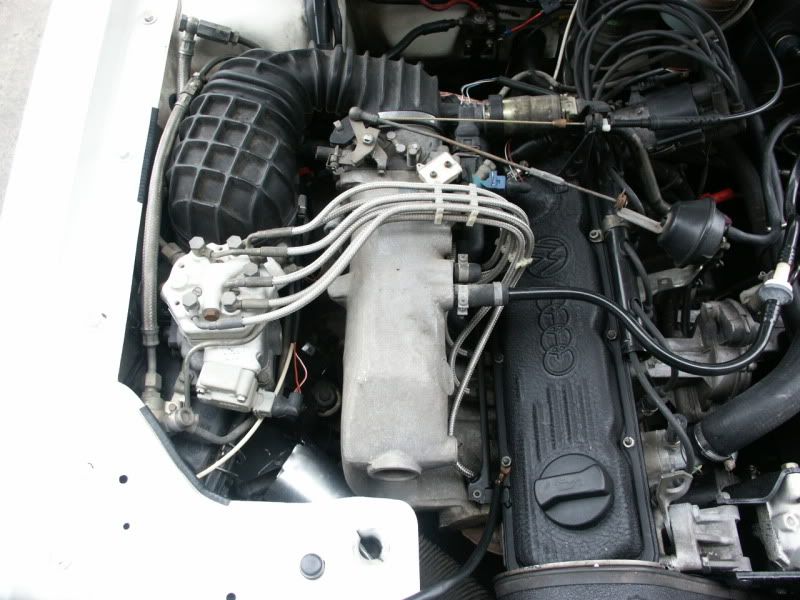

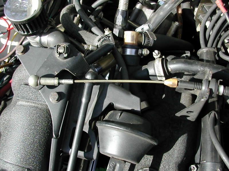

CIS

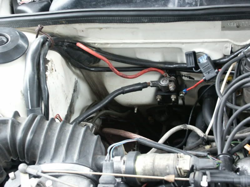

battery tray removed

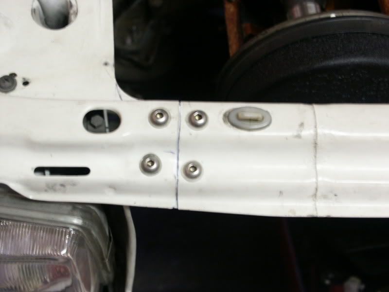

my OG frame rail mod

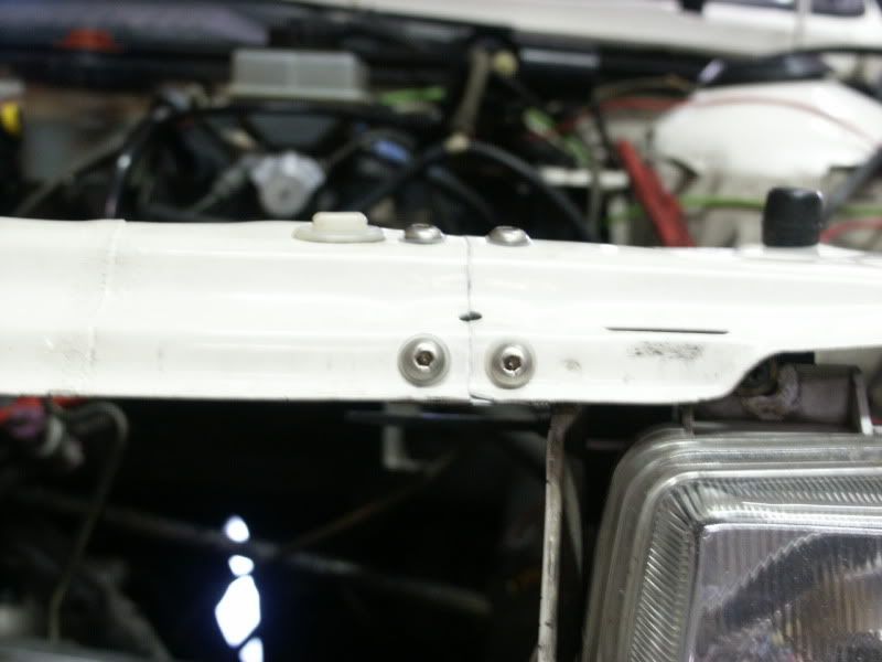

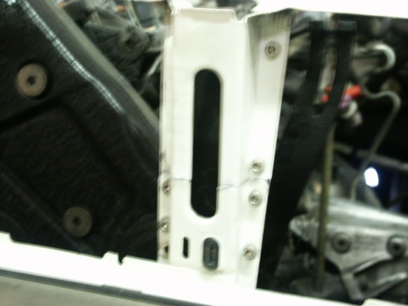

Core support mod

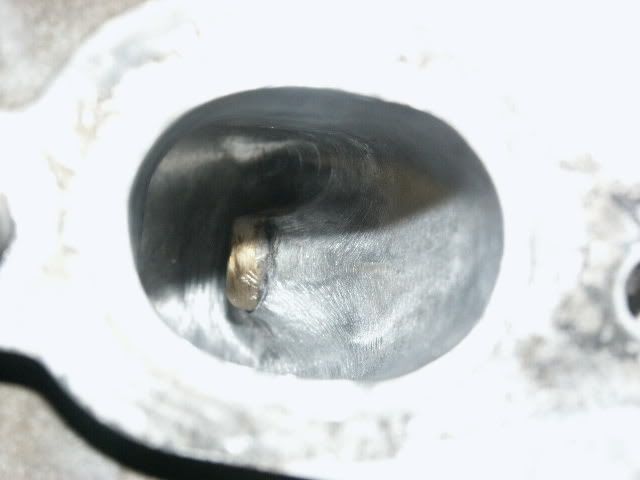

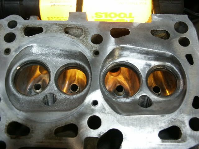

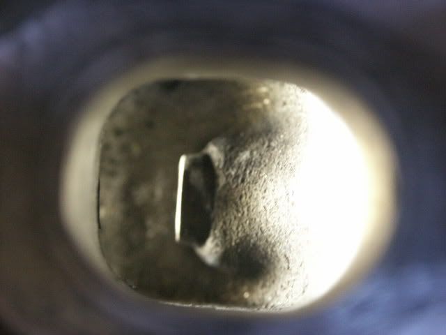

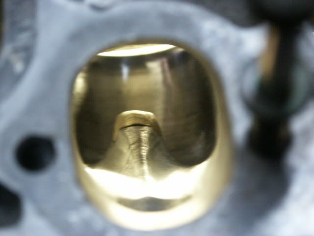

Port work

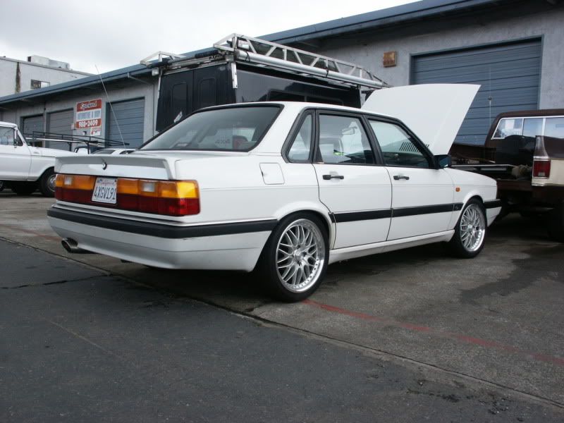

the last thing i changed on my car was wheels. i needed room for bigger brakes and this was the first thing in line to be able to do that. i went with ronal R-38's that i got from our now broken in MG member audilard, darin, (see darin, this place is great isn't it!) so it looks like this..
