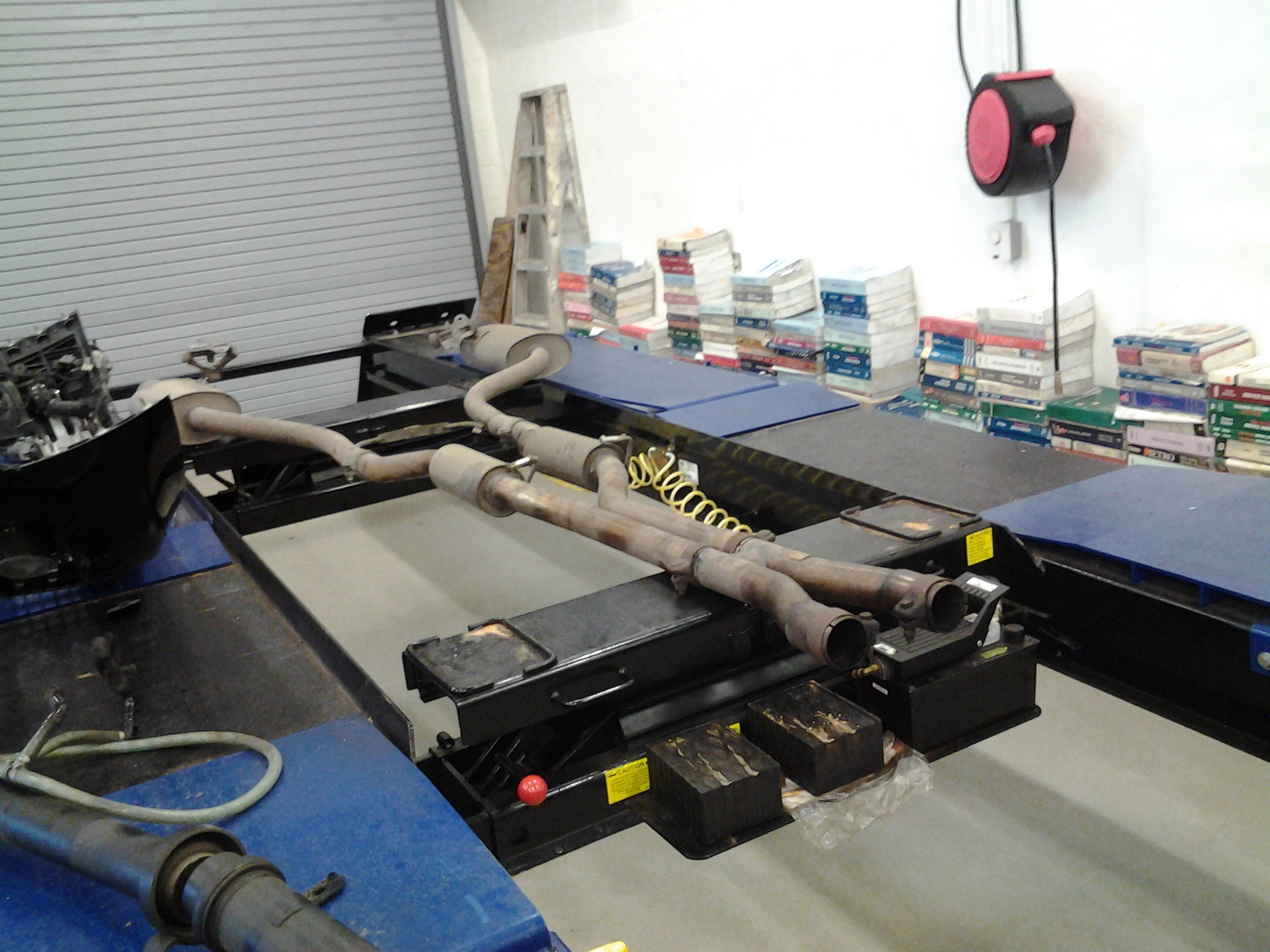

- Milltek catback
- 20150413_120305.jpg (918.18 KiB) Viewed 10766 times

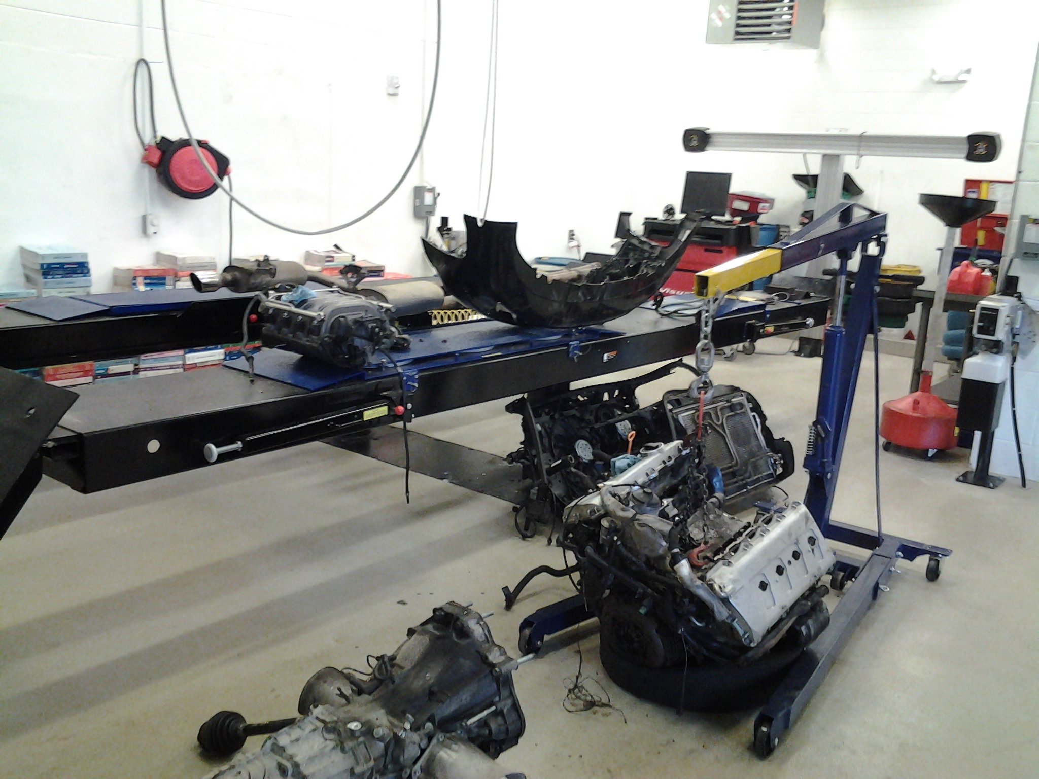

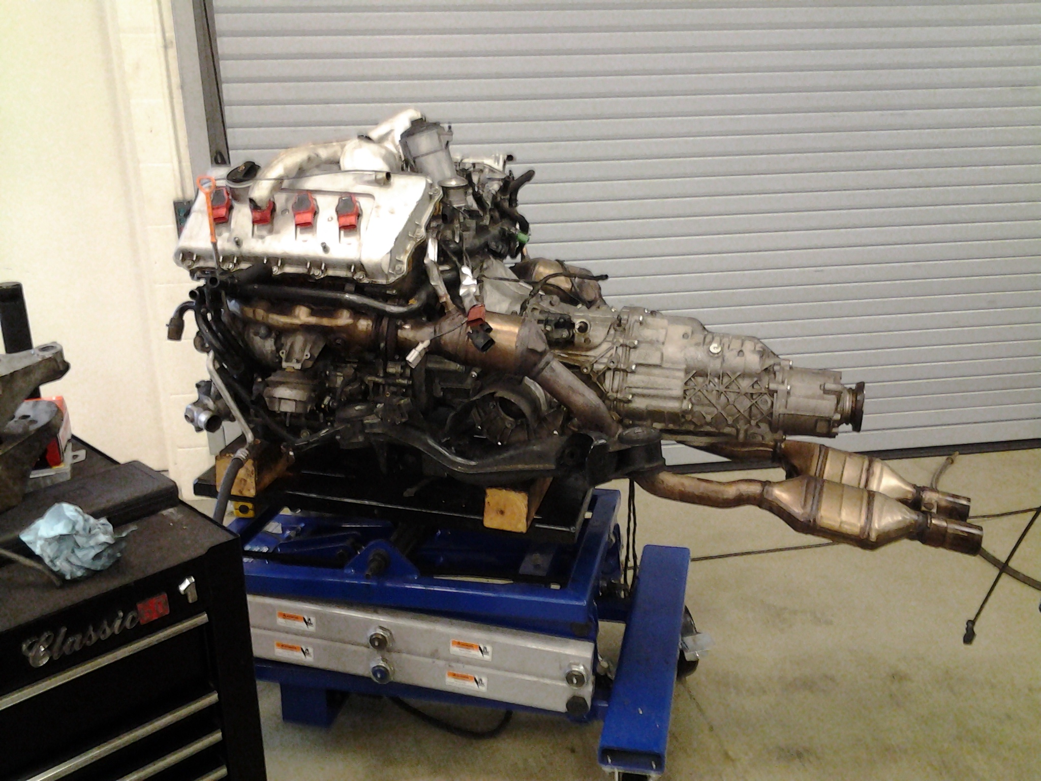

- Good motor waiting on flywheel and clutch
- 20150413_120243.jpg (891.75 KiB) Viewed 10766 times
- 20150413_185315.jpg (972.09 KiB) Viewed 10766 times

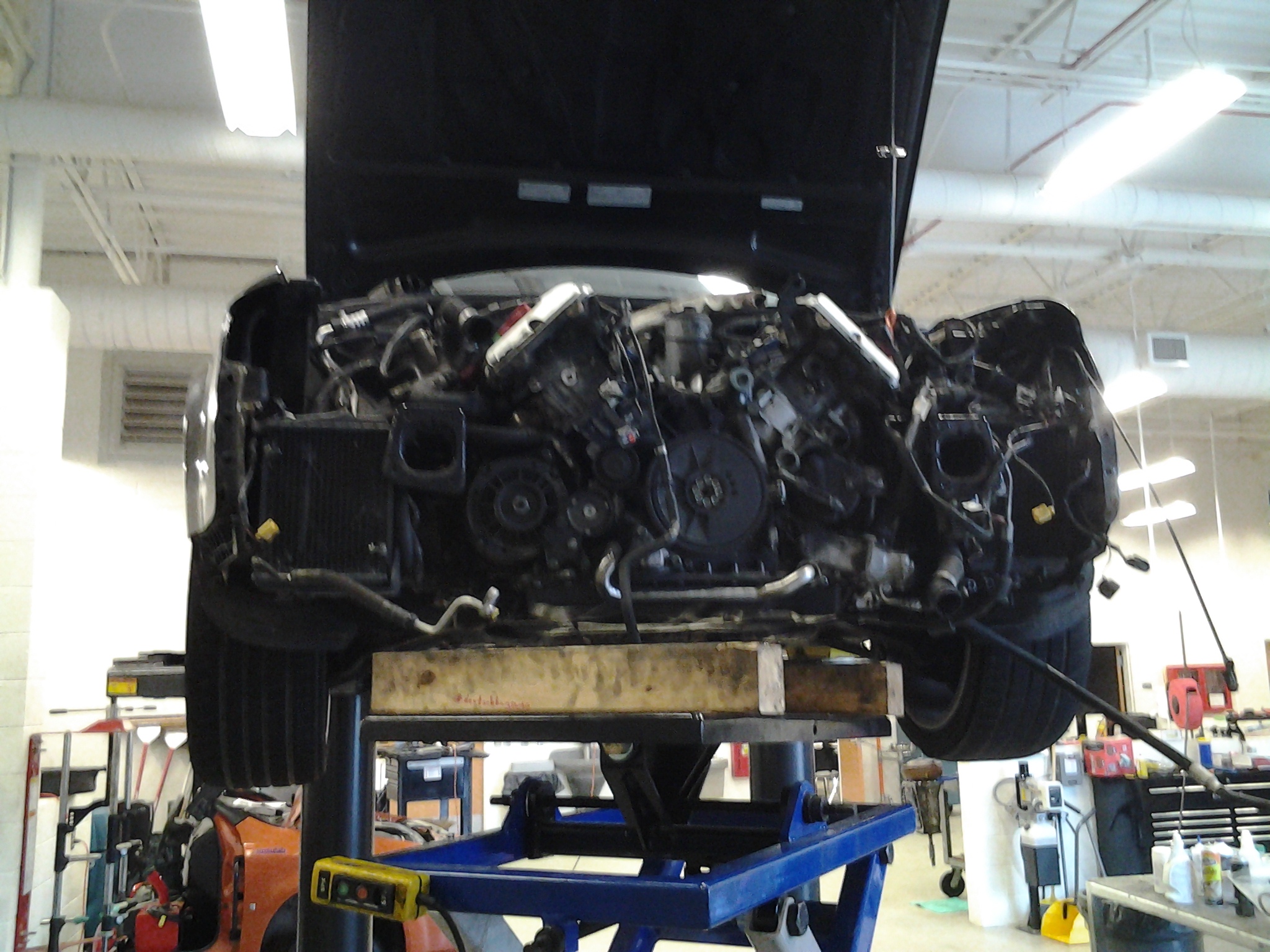

- And shes out!
- 20150413_185325.jpg (963.22 KiB) Viewed 10766 times

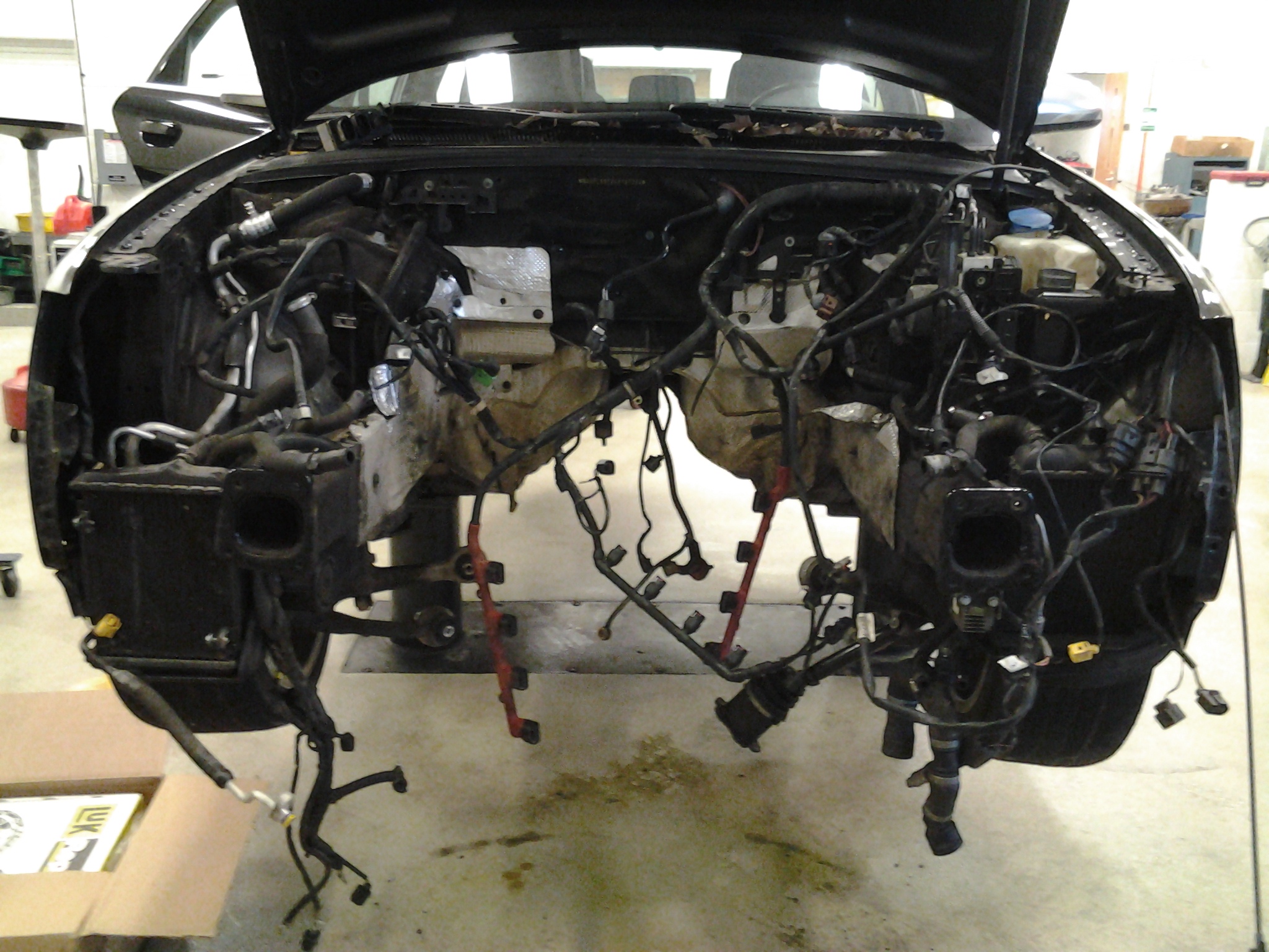

- About to pull the bad motor
- 20150413_120239.jpg (947.91 KiB) Viewed 10766 times
