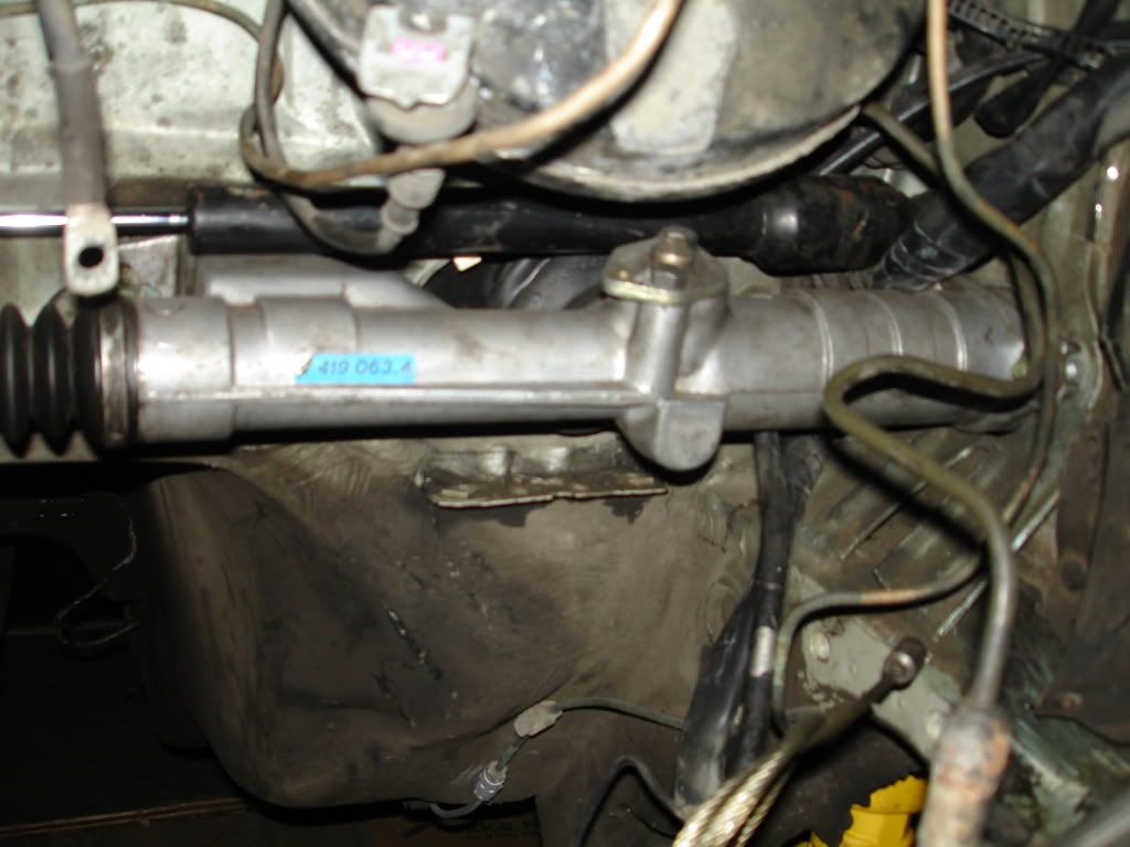

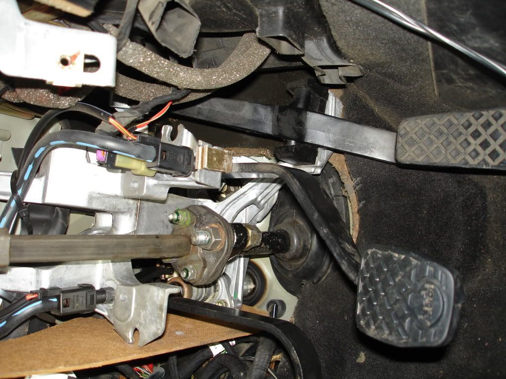

The manual VW Fox rack is installed. It is literally a bolt-in swap. These are the required parts needed from the donor;
The rack of course; I found one with 40k, the connecting shaft to the steering column, the steering damper with bracket(not in pic) and the rubber shaft seal. The Fox seal fits neatly inside the seal on the body like it was made for it.
The left engine harness must pass between the steering damper and the steering rack. I had to use a heat gun to make it flexible enough. I cut away most of the ABS brackets for essential access.
I cut apart and used parts from the flexible coupling on the stock rack. Using 2 couplers if possible, you need the 2 loose spacer sleeves as the others are riveted and inseparable. The steering shaft is telescoping and takes up any extra slack from the length.
When I drive it I'll relate how it feels as far as effort, stability, responsiveness.

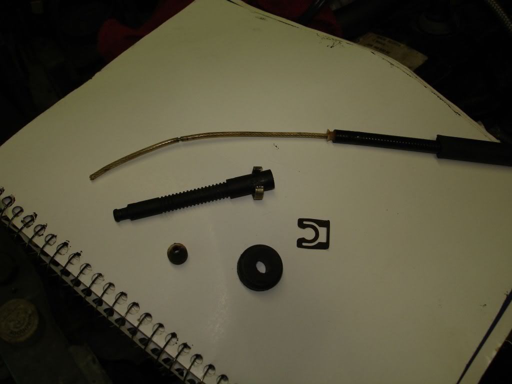

I needed a new throttle cable as the diesel version is a different length and a different end on it. I pondered buying one from the EU but decided to re-engineer the original. First off you can't remove the cable without destroying it; so I modified it in the car.
First clipped off the end; pulled the adjustment housing away from cable easily; didn't have to cut it open; with a perfeclly clean end on the cut cable; I pulled the cable all the way out. I cut the cable housing to the right length reinstalled the cable and set about to put an end on it.
I used a ball end from a cruise control lever. I drilled the piece of the lever out lengthwise; cut a tiny beveled brass plug to act as a compression fitting of sorts to adjust and lock in place the cable in the ball end.
I finished it with heat shrink tubing and a drop of epoxy.

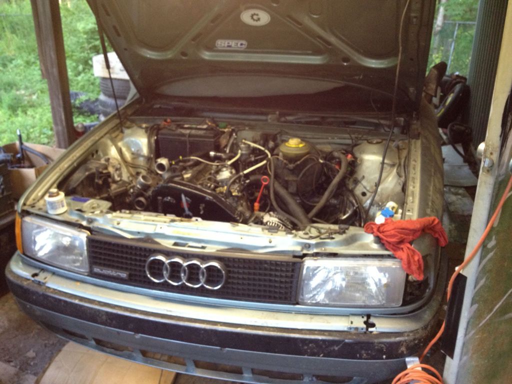

The intake manifold is from an ALH; modified to fit my application.
Car with bumper on.
This is the car 2 weeks ago. It's now with intercooler & lines in place; I'm making brackets for it. The car is full of fuel, oil, and anti-freeze with no leaks. I want to start it and drive it with no idling time so the car must be completely done before I turn the key. It's getting close.

Car with bumper on.
