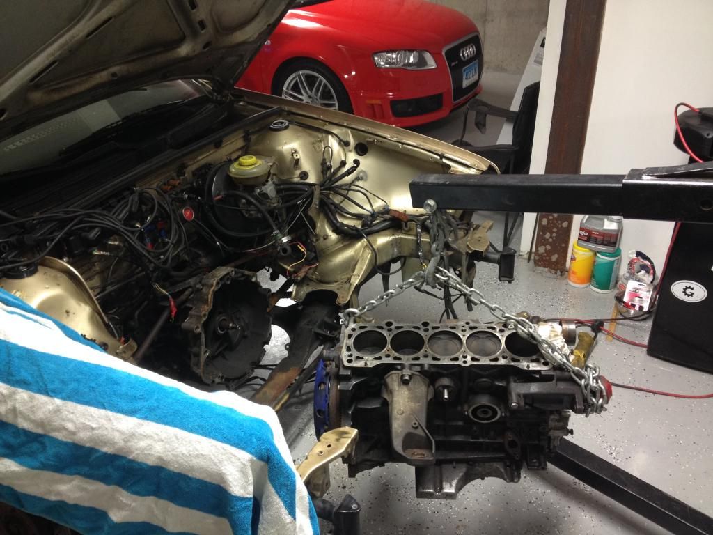

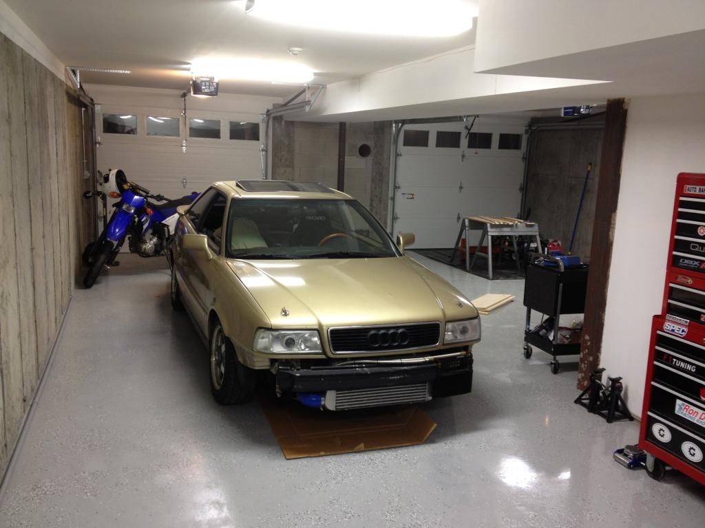

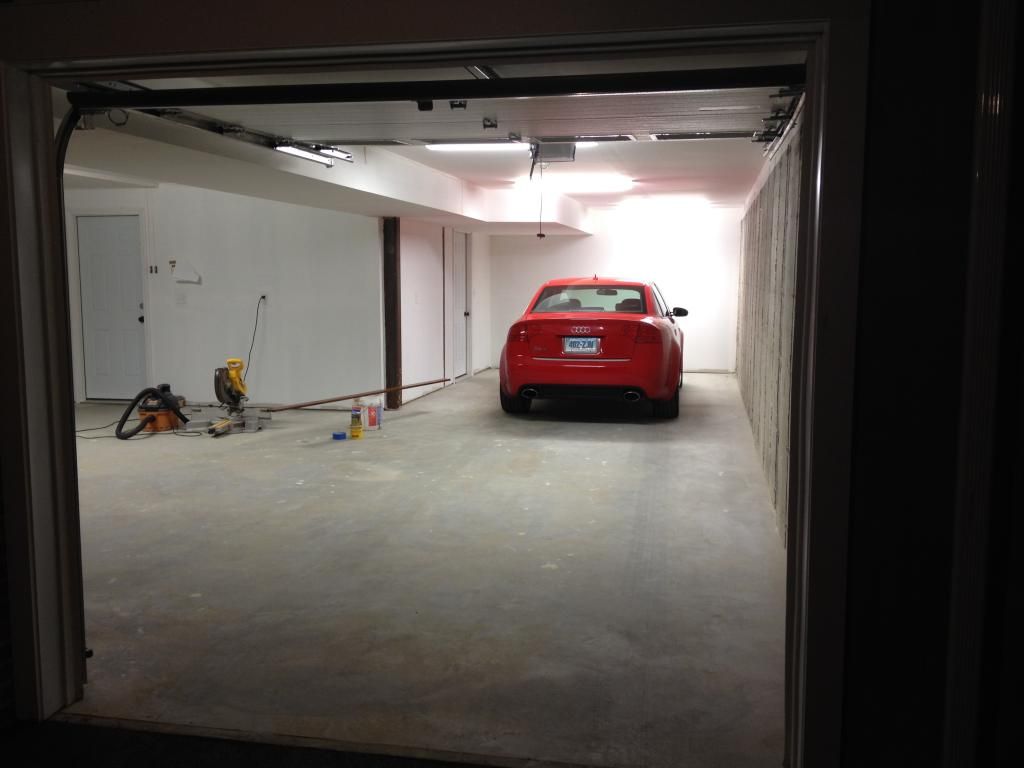

Welcome to my new work area. 3 years back I was renting some shop space 10 minutes from my house. It was nice, but I didn't get much done on my car there, and instead only managed to work on everybody elses cars (including my brothers ABZ A4). After that I had a year of no garage, no tools(in a storage trailer), and no motivation to pull the motor and beef it up for more boost. That was my ultimate goal. Up until now the AAN in my car was untouched. It had a fresh timing belt and head job from Force 5 so I ran it as is, but always dreamed of building it (or my spare AAN block) with new bearings, ARP hardwares, rods, etc.
Once I sealed the floor and moved a bunch of my tools over, I wasted no time at driving the coupe to its new home, and yanking the engine.

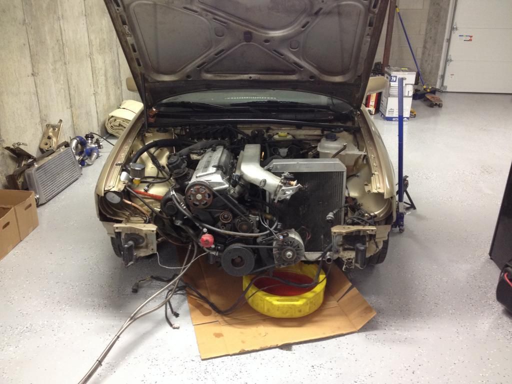

Here's a quick test fit of the SQ replica manifold
Obviously with this setup I'll need a new downpipe, oil/coolant lines, intake/boost plumbing.

Looking good! nice shop space! I find myself working on things alot more now that I don't have to drive to my shop and can work at home.

Nice garage! It makes all the difference. Looks like you jumped head first down the slippery slope, keep us posted.
Re: Chris' Turbo Coupe
Looks great, is the turbine output as close the the inner fender as it looks?

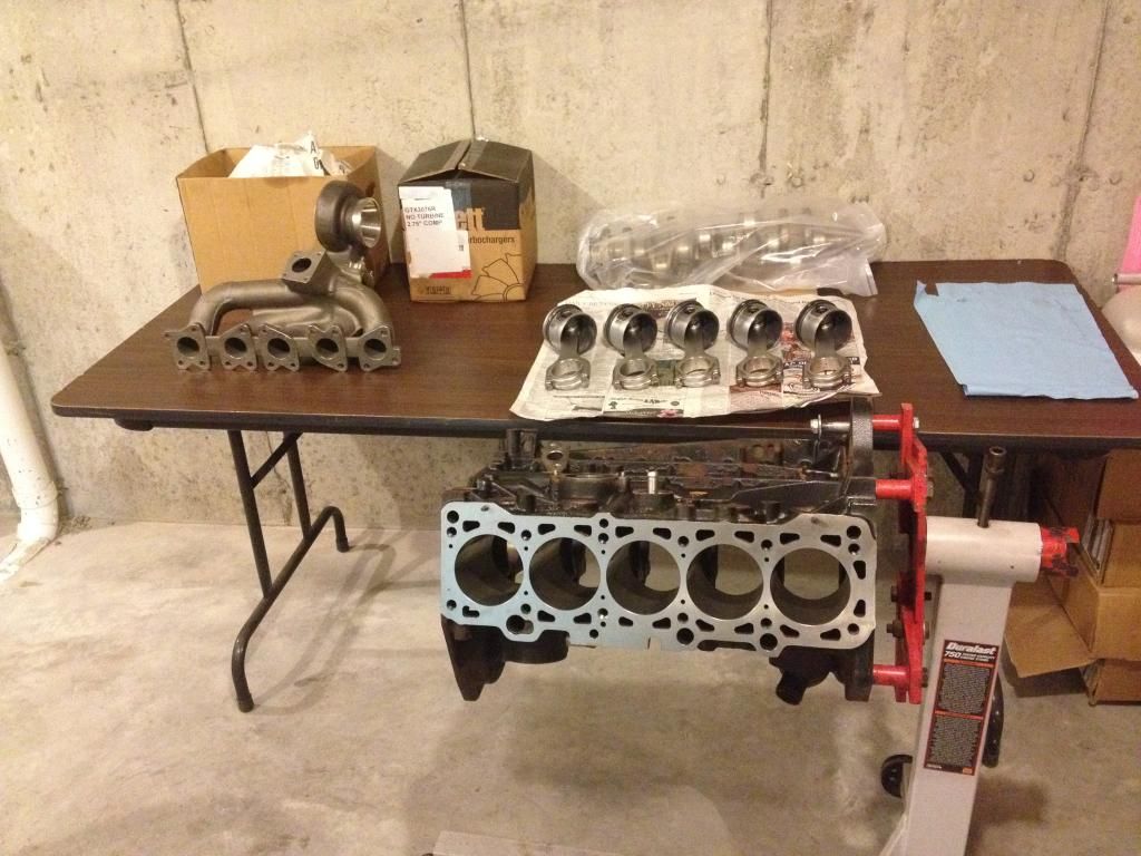

I decided to build the engine that was currently running in the car, as opposed to building the spare AAN I had. I stripped the motor down to the bare block and brought it to Larry's machine shop in Groton. They cleaned it, mic'd it, gave the bores a light hone and decked the head gasket surface. Only issue that arose was balancing...
I dropped off my clutch, flywheel, crankshaft, front pulley, new H beam rods, stock pistons, rings, and clips to be balanced. Since the only information I had on this subject I learned from reading topics here and on other forums, I was hoping Larry's would know what to do. Shortly after dropping my goods off, I get the call from Larry's saying he didn't know how to properly balance the crankshaft and that it would be better off leaving it ,since it was only a few grams off. They did claim to have 0 balance the rods and pistons. I say ok.
Looking at the rods and pistons I couldn't see where material was taken off to balance them. I feel funny going back to Larry's and asking them to show me where, but how else am I gonna know that the work I paid for was done?
Also I had my pistons labeled to the correct cylinder when I dropped them off. When I picked everything up, they were no longer labeled and I have no way of knowing which bore to put which piston in. Larry's said not to worry since they were all pretty close and all within spec. Should I worry about this?

Mcstiff wrote:Looks great, is the turbine output as close the the inner fender as it looks?
Yes it is very close. In the picture, the header isn't fastened tight to the head so it is pulled away maybe a half inch, but either way it's very tight. I'll snap some better pics when I have the engine in the car again and things bolted up properly, but it looks like I might wanna cut and reangle the V band outlet slightly. It is a mystery to me that 034 sold a downpipe that bolted right in. Looks to me that there is little to no room for a down pipe to bolt up the way it is now.

Bottom end is now assembled! New rods, rod bearings, main bearings, main studs, piston rings and replaced the oil check valve.
Next step is to modify my windage tray to fit with the new longer ARP main studs.

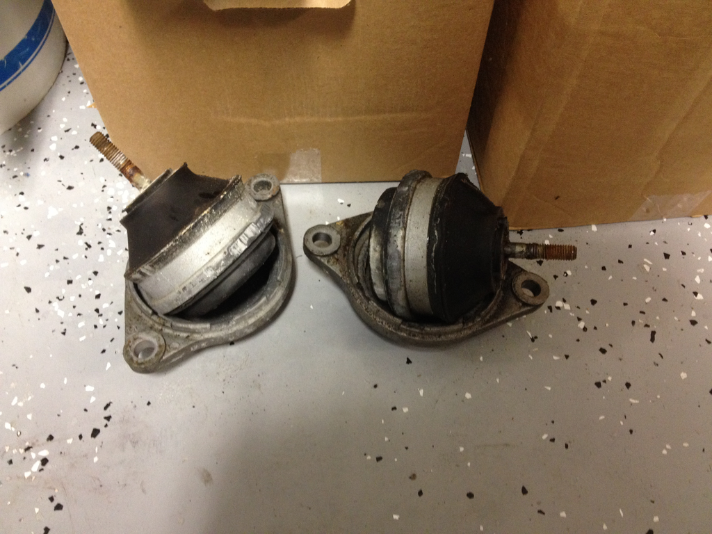

Thanks for the tips guys. I'm picking up my cyl head today after work and can continue bolting things together. I'm excited to put this back in the car, but I just thought up another problem. I bought these low quality engine mounts from 034 that seemed to loosen up not long after installing them. I couldn't beleive that both of them came out of the car looking like this..
What are my options for mounts?
You're not alone... same thing happened to me after 7500km.
Get in touch with Jared at HPR for some quality mounts at a fair price. He goes by Angry Taco on here and MG. You may already know him as the 20v troll.
My 034 mounts didn't separate, they collapsed. I also ordered a set from Jared.
Right now Jared is swamped, so if Mark has them in stock, I would order them from him.
