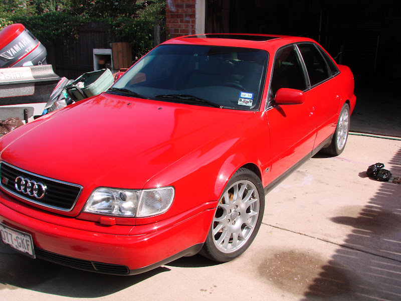

95 S6 Tornado RED / Ecru
133k
Texas Owned NO RUST
Stromung Unknown Gen Installed in 2006
OEM RS2 Maninfold

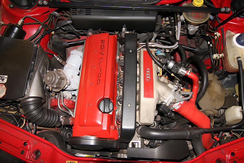

In the endless pursuit of power I swapped in an RS2 Turbo, OEM RS2 Injectors, and VEMS

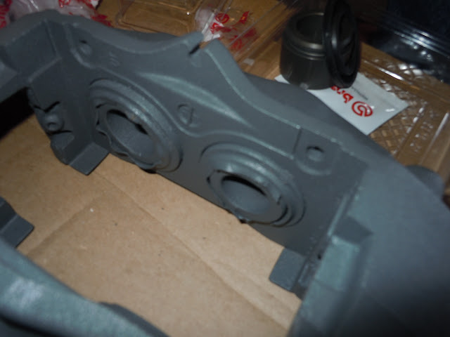

Time to get crack'n on my BBK setup that's been collecting dust on the "bench"... Only air was used in this process for removal of pistons. Nothing else was needed to pry the dustboots off or removal of seal...
Enjoy!
Before
Pop One out using air...
Piston with old dustboot
3 pieces
to be replaced with these
Lube & replace... 1 down 7 more to go
Vise grip & Bolt
Old seals actually looked good but I replaced them anyhow
1 Done
Both done
Right before final tightening...

Pipes are in

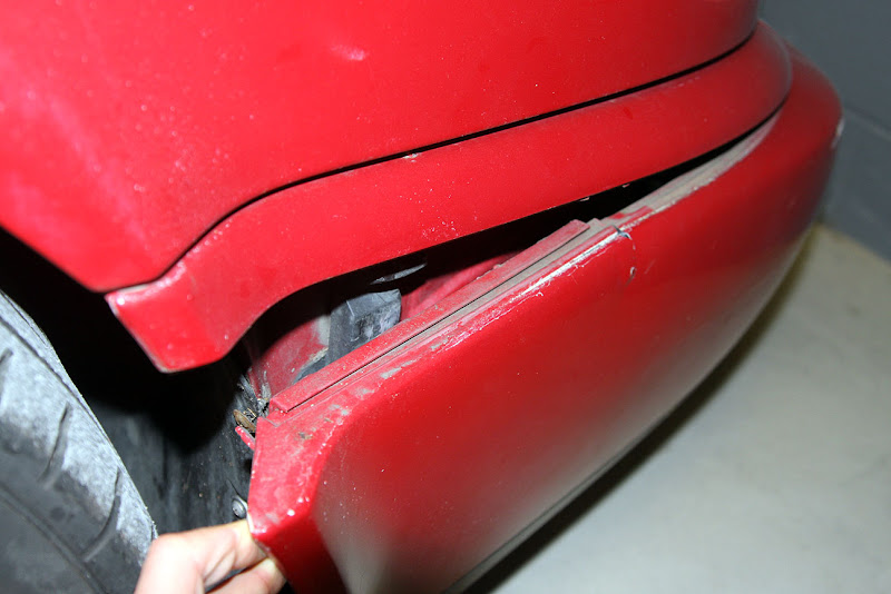

Aparently the previous owner of the bumper had an Apikol FMIC based on the existing trimming...
No Trimming!
Plenty of room!
Next time I'll use 2.25" on the outlet to intake...
but this isn't anything that a little trimming won't fix

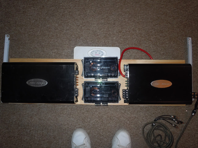

Plotting out a sliding amp rack
What's it weigh?
Not bad at all for over 1700 RMS watts of quality power IMO
