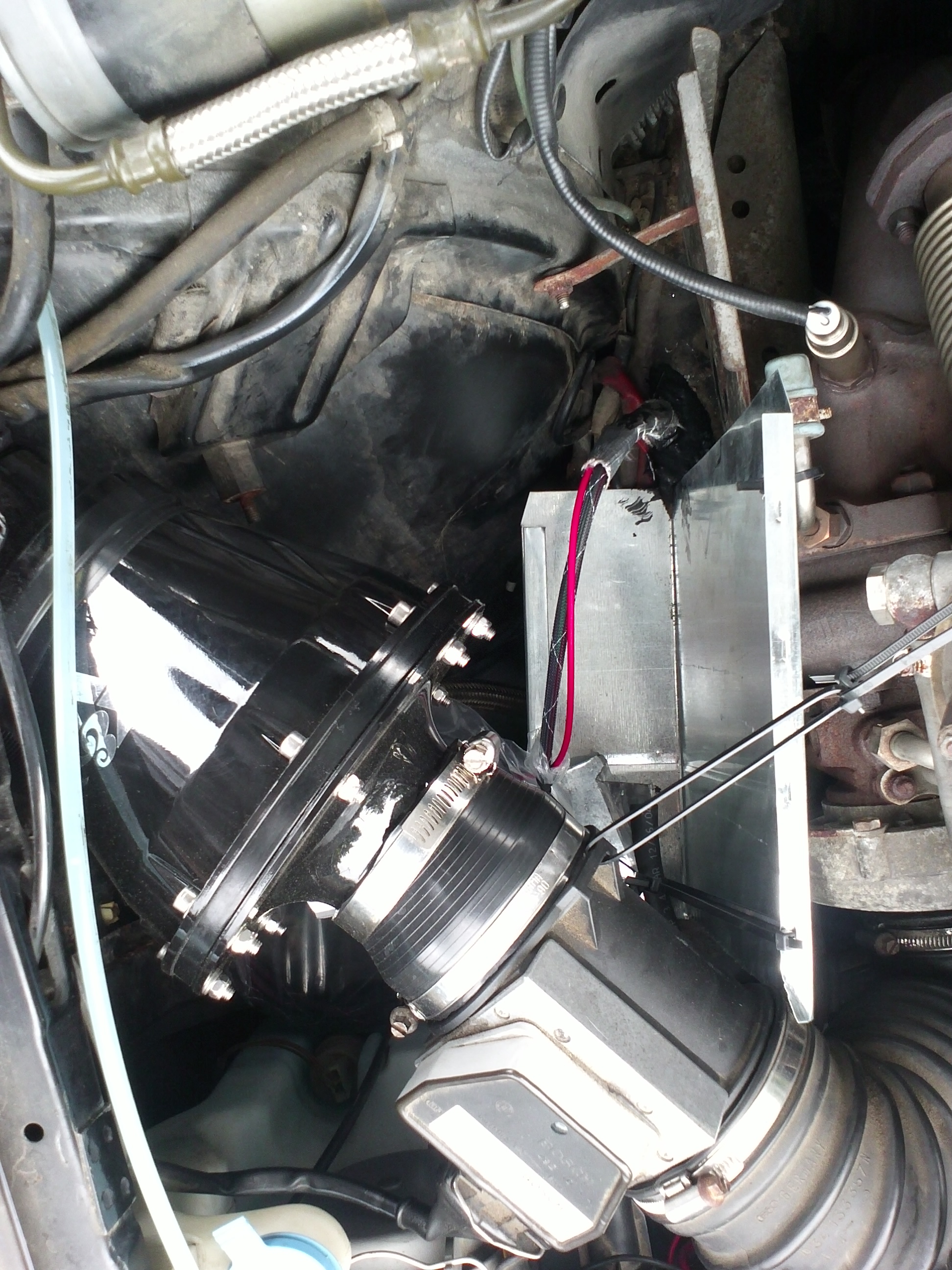

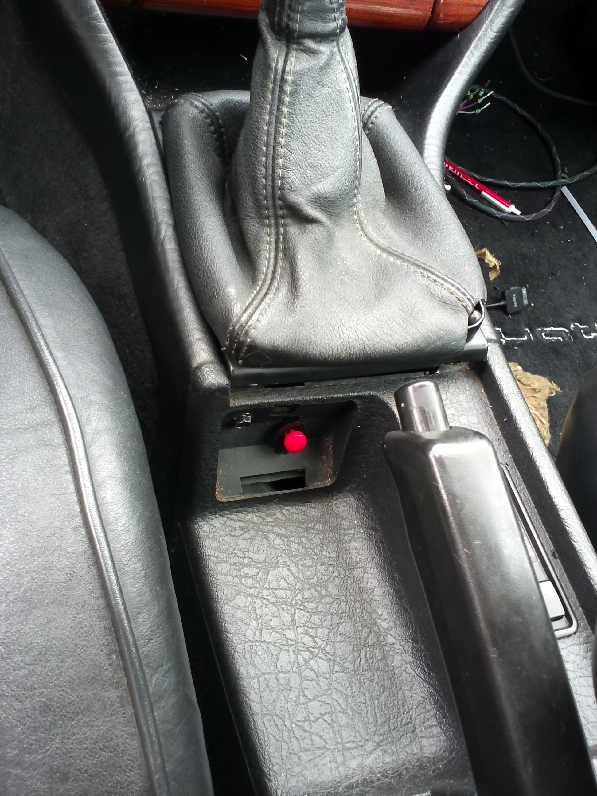

- MMS_PICTURE_1405733919317.jpg (3.16 MiB) Viewed 67524 times
- IMG_20140719_115128.jpg (1.22 MiB) Viewed 67524 times
- IMG_20140719_115038.jpg (1.27 MiB) Viewed 67524 times

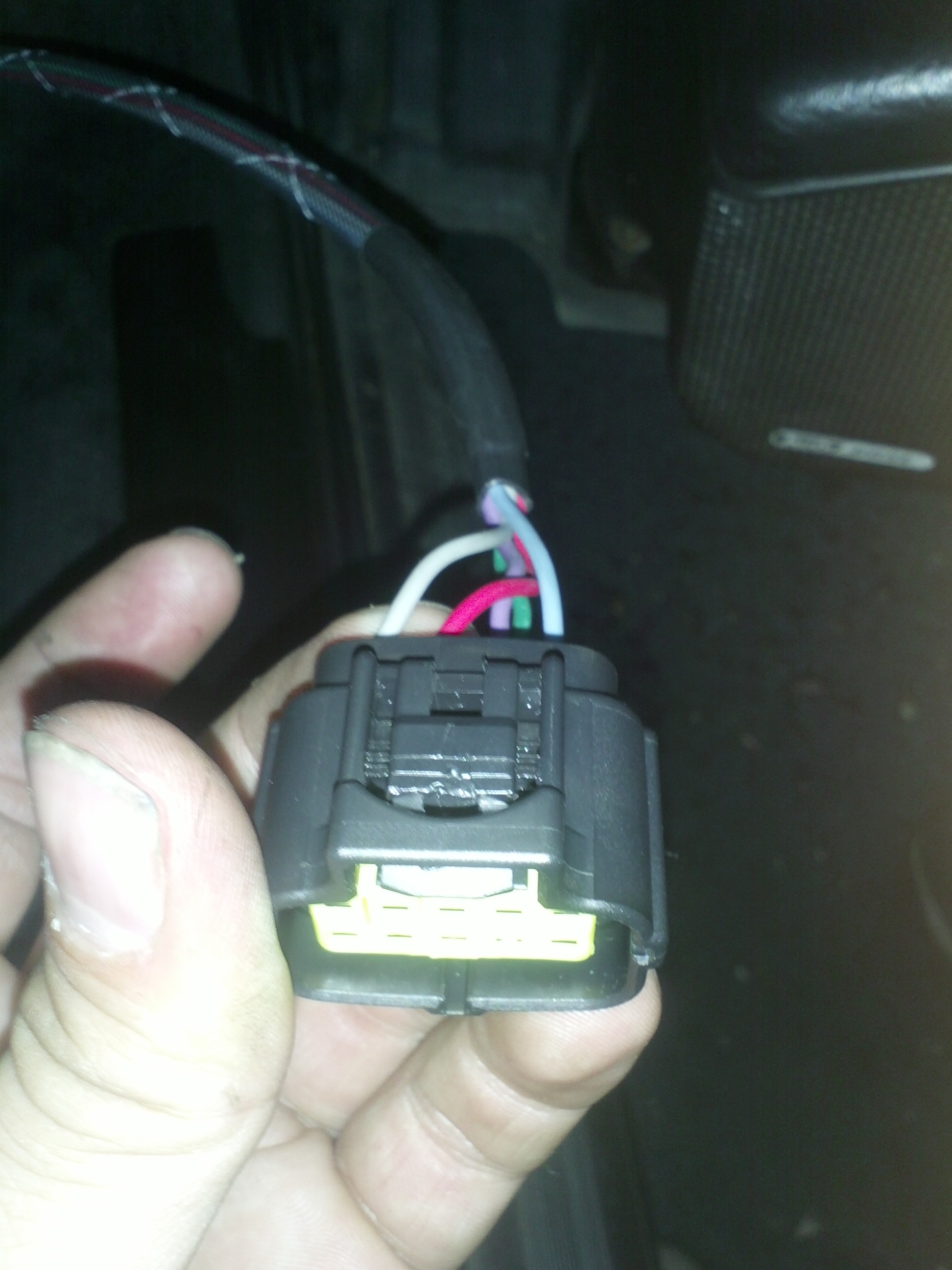

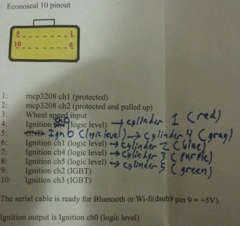

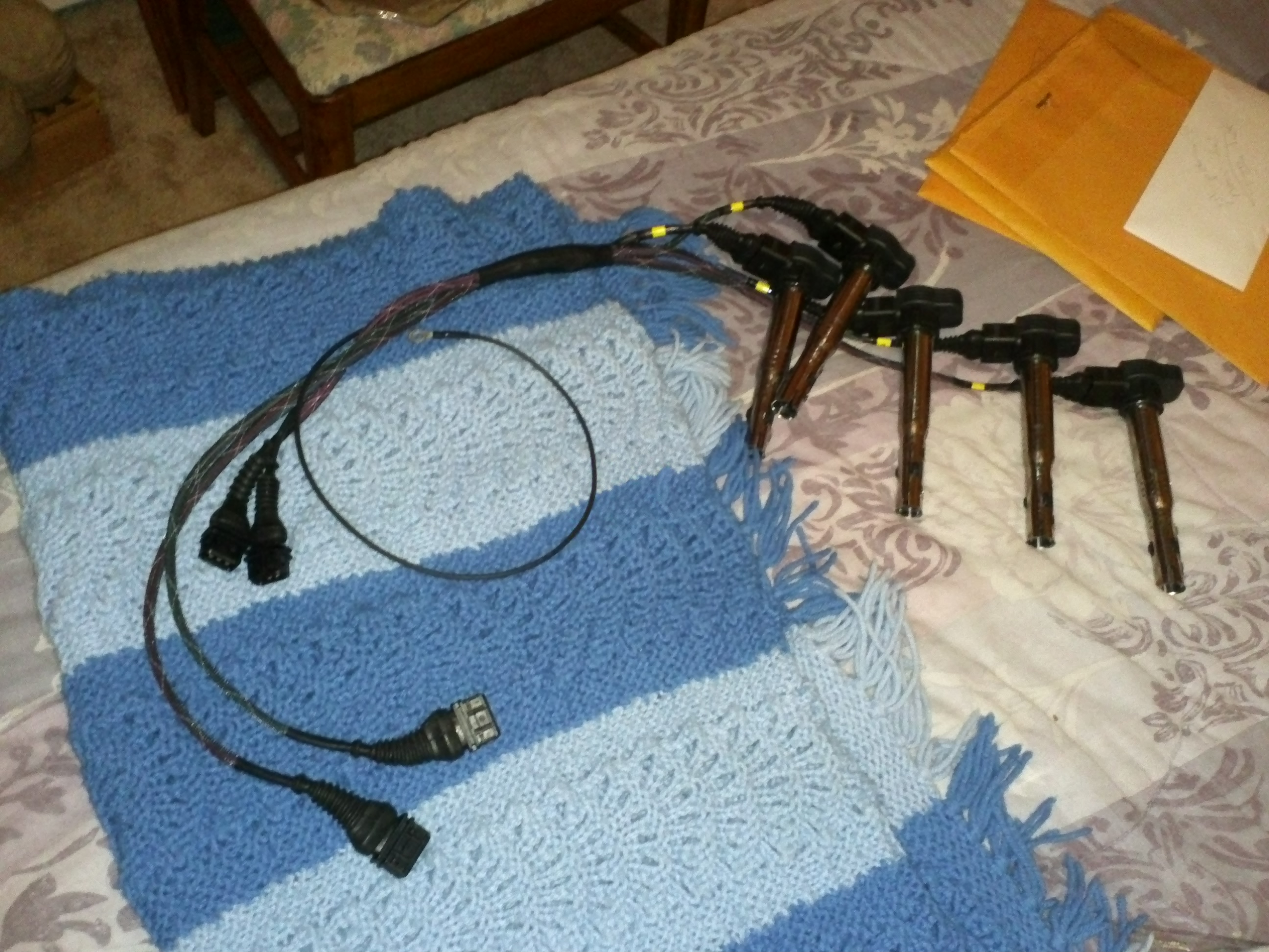

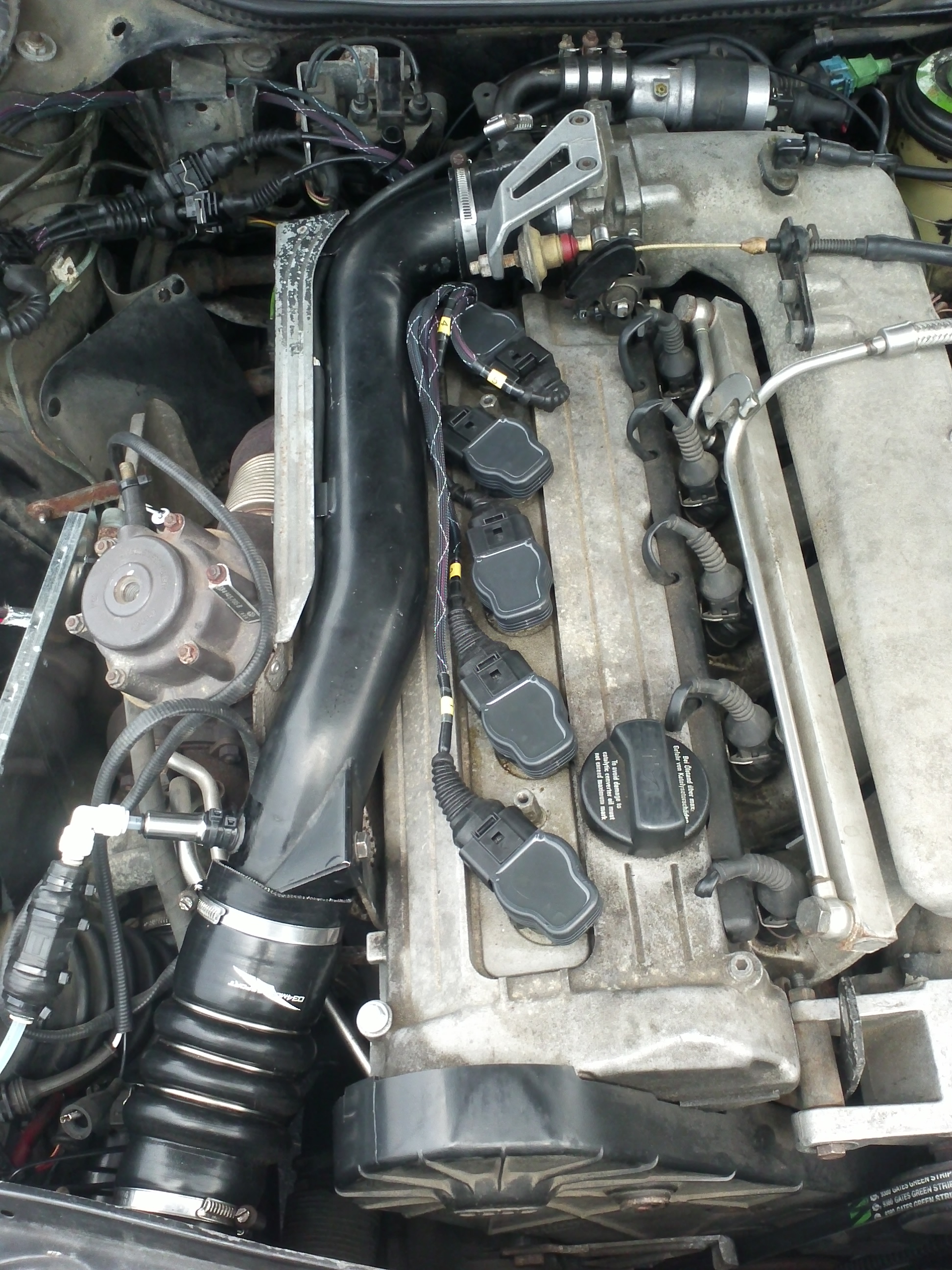

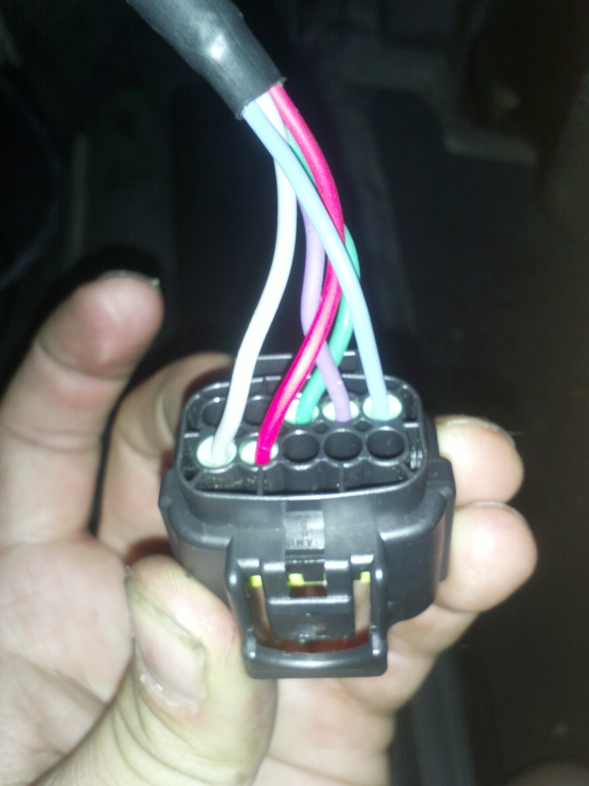

I connected everything for COP including installing coils over old plugs until its up and running. I'm confused on this 10 pin plug on the interior end of the 3B COP conversion harness though. I only have like 5 wires to populate it with but the strange part is that I don't see anywhere in the pictures or reading about the PNP ECU having a 10 pin plug. Not sure what i'm plugging it into. The other thing i'm wondering about is the conversion harness has 2 3-pin connectors with only 5 pins populated between the two of them whereas the ones they connect with have all 6 pins populated. I think I read that their order doesn't matter since they are just power supply wires for the 5 coils?? I connected them up anyway. Apparently, I'm only supposed to leave the original huge 3 pin connector for the factory coil unplugged too.

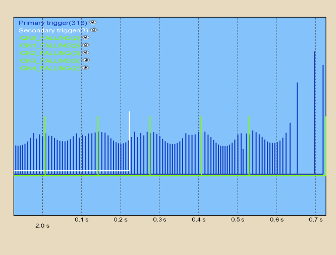

Ok so Im not getting spark. And it wasn't just because I didn't have the fuse in the COP conversion harness lol cuz I checked it even after putting that fuse in. I have fuel on the plugs but no spark. Here is a png of the trigger log. I think it looks right. what do you all think? I swapped the pins on that VR sensor before attempting any of this and also calibrated the O2 sensor I so graciously received
. Anybody else encounter a no start with the conversion harness? Theres no instructions but I remembered most of what Marc told me over the phone. I used the 2 pin factory O2 power plug for the 2 pin connector on the COP harness and the rest was pretty much by the pictured plug for putting the pins in the main plug for the ecu. HALP! Thanks
- first_trigger_log.png (27.28 KiB) Viewed 67158 times
Not enough secondary triggers. Did you reverse the polarity of the trigger pin sensor??
I haven't seen those green ignition bits before. Maybe somebody can chime in.
Looks like those ignition events are about where the secondary reading should be. I am confuse
Hey Phil, yeah my only guess is those are related to the COP conversion harness. I requested that he ship it preconfigured to run the new coils. I included some pictures of the coil wiring and instructions I was provided. yes I swapped the green and red wire so that the red wire was in the middle like the website described. To the photos!
BTW, I grounded the conversion harness directly to the smaller of the two ground bolts on the intake manifold and ran its relay's power wire all the way back to the battery under the seat.

I'm pretty well convinced I wired the wideband right since the calibration went off with out a hitch. Here's a better picture of instructions.

Do you know what those grounds on the conversion harness go to? That could be introducing noise to the system from the coils. I had TONS of ground issues when I first got mine done. I was on Econoseal so I had a lot more diagnosing to go through seeing as it was my own (shitty) wiring.
Lol ya I feel ya Phil. I'll upload a pic of my 5k's unprofessional wiring I did. Lol it all runs out in the open from the back seat to center console. Its shady as f##*¡
ya there's only one single ground on the conversion harness and it says to attach to the ground bolt. The instructions are only for the s4/s6 so I feel like I'm treading unknown waters using the 3b with COP conversion. I will look at that tomorrow. I think I'll check for voltage first Hahaha to see if the relay is even getting it. Thanks
Ok I just confirmed I have voltage at the harness (at fuse holder) during cranking only. Saw about 11 volts but I didn't have a full charge from the after work diagnostics. I'm done for tonight...
