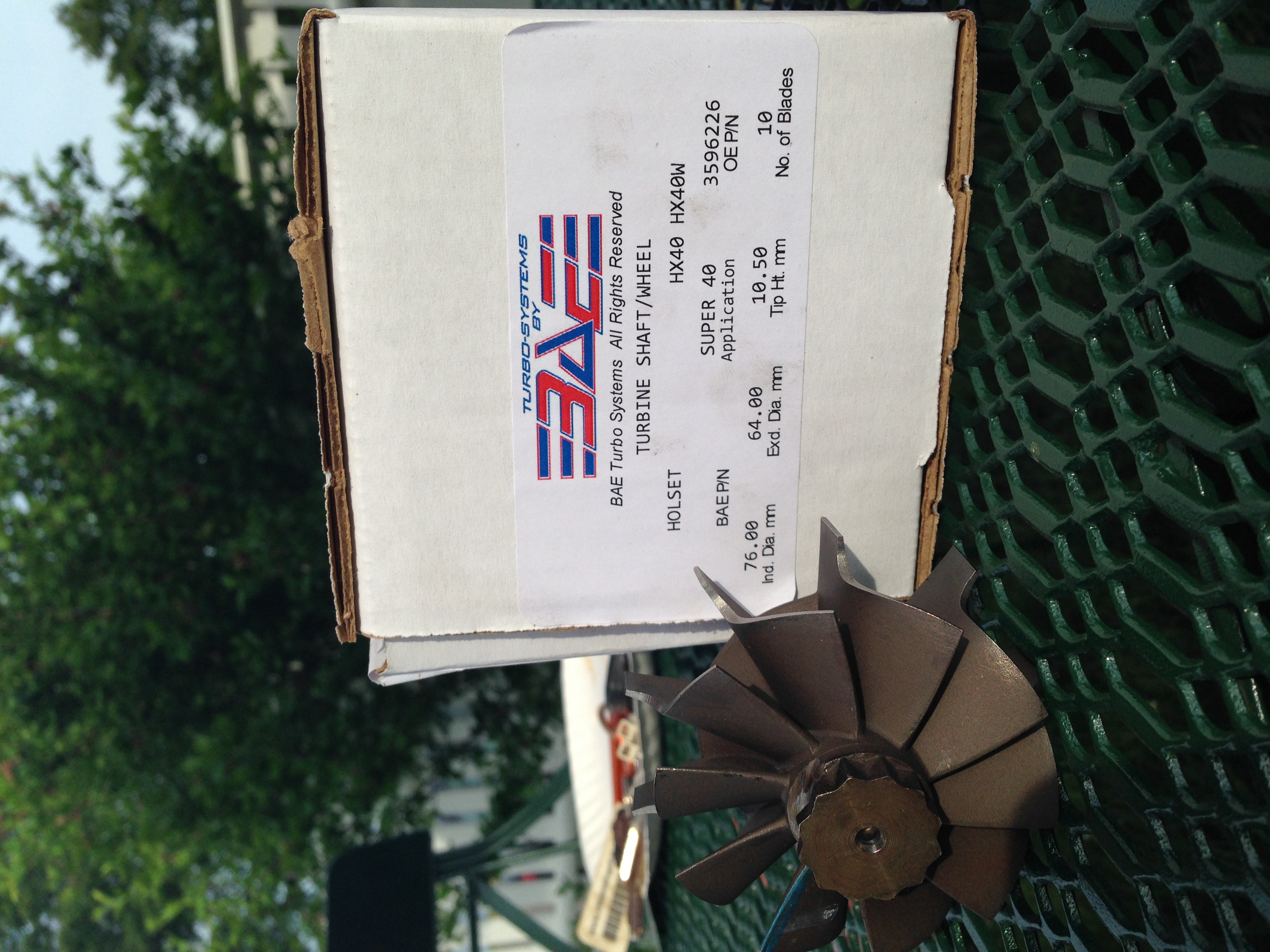

I knew I wanted more as soon as I went MTM1+, and I had gone through numerous phases including Garrett/KKK hybrids, then played with the idea of a k26 housing PTE, but finally settled on an HX35, its cheap, there are plenty of t3 manifold options out there for it, and it would put me right at the limit of the stock internals. I found a good used hx35 CHRA on ebay out of a 1995 cummins dodge for cheap money. (casting marks from USA, no Chinese junk) I picked it up, with a rebuild kit, and intended to find the proper non wastegate housings after rebuilding the CHRA. When it arrived, I was heartbroken. the seller packed the part poorly, and the USPS played kickball with the box, leading to a destroyed turbine. At this point, and after consulting some big turbo Audi dudes, my direction changed and I have converted theHX35 to a 10 blade super40 turbine wheel with a 60x86mm 7+7 blade billet compressor wheel...it really is a work of art...
destroyed HX35 Turbine
photo 1-3.JPG (2.07 MiB) Viewed 52480 times
The destroyed HX35 turbine

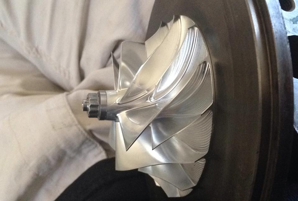

The new Super40 10 blade turbine
photo 2-1.JPG (1.59 MiB) Viewed 52480 times
new Super40 Turbine

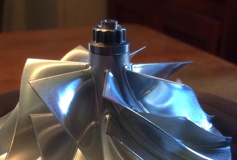

Billety goodness
Billety goodness
photo 3.JPG (108.62 KiB) Viewed 52480 times
Billet 60x86mm work of art

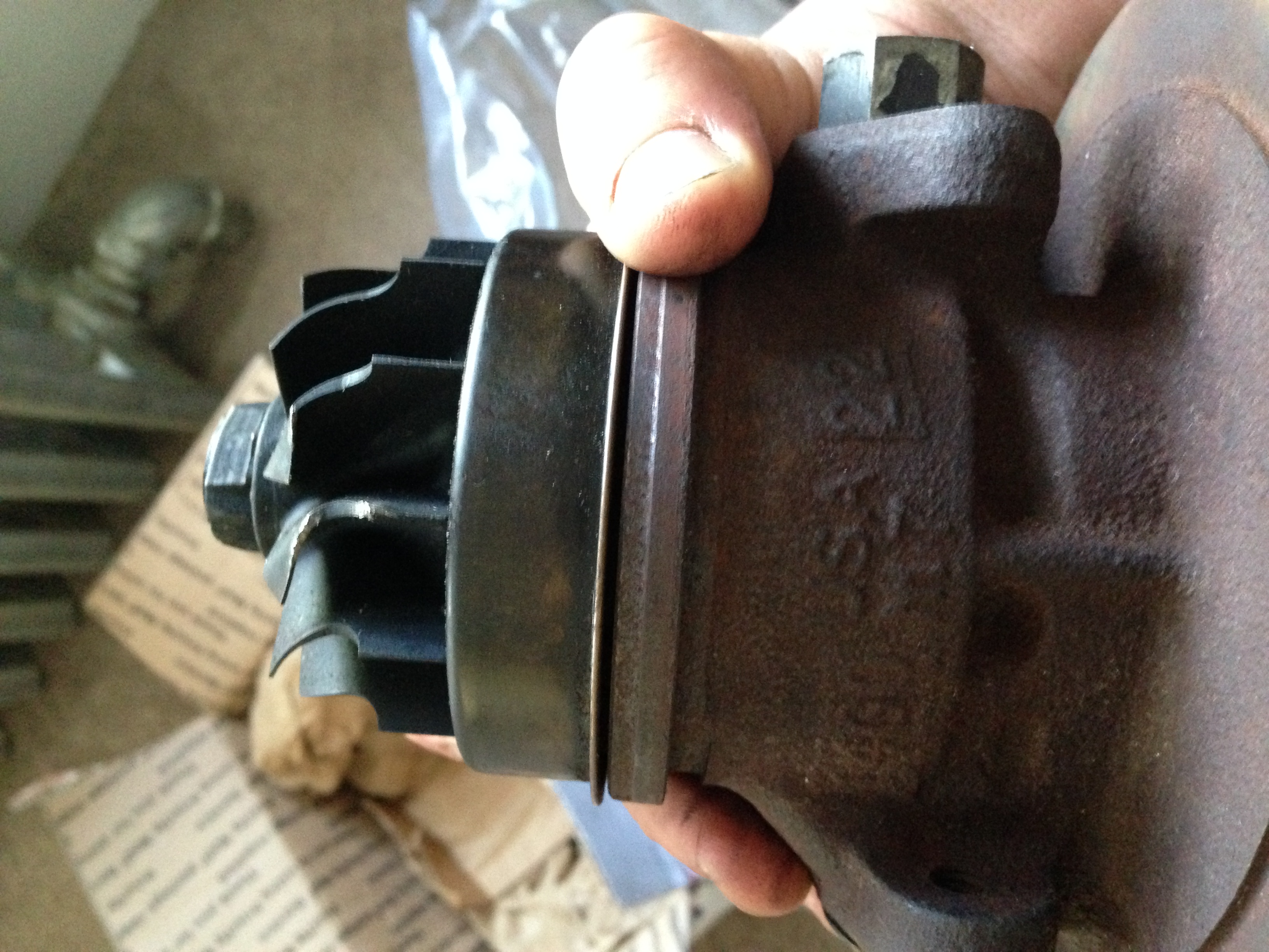

needs a little machining
photo 4.JPG (115.65 KiB) Viewed 52480 times
The backing plate needs a little bit of machining before she'll fit the former HX35 donor

Quick update, the more eagle-eyed of you may have noticed the huge overlap of the billet wheel on the backing plate of the HX35, and ive been beating my head against a wall calling around looking for a machine shop willing to bore out the backing plate to fit the new 86mm HX40 compressor. Nobody wanted to touch it, so I took some time after work to play with the 60 year old lathe in the shop I work at. I hadn't ever done anything this precise before, ever... and I taught myself how to align the CHRA even though its a bizzarre shape. (I'm more used to working on black iron pipe...) An hour's worth of sweating and telling myself I ruined everything ensued... Here's how it turned out. (no pun intended)
At this point I was very much thinking "what have I gotten myself into????"
Though I am not disappointed with the finished product.
Re: LucidMatt's billet HX40 Super URS4: The planning phase
Well done!
Awesome! I have always wondered what would go into that machining operation. Did you use a 4 jaw chuck? I should do this.
lucidmatt
Posts: 186
Post by lucidmatt »
3 jaw chuck, navy surplus lathe, no idea what brand or builder it is, but it has to be at least 2 tons of machinery. its really a beautiful machine.
Those are the best lathes (WWII era). How exactly did you chuck it?
lucidmatt
Posts: 186
Post by lucidmatt »
hand tightened the chuck, disengaged the electric motor clutch, very delicately pressed the cutting tool against the backing plate while hand turning it until the face of the backing plate made even contact with the cutting head over a full rotation. Pulled cutting head away, tightened the chuck down all the way and engaged clutch, ran it to look for any play or wobble, reset it and repeated until it was perfectly level, then commenced to use the cutting tool to widen the dish. Im sure its not the "textbook" method, but it worked flawlessly.
