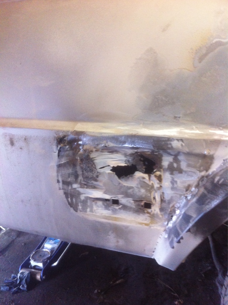

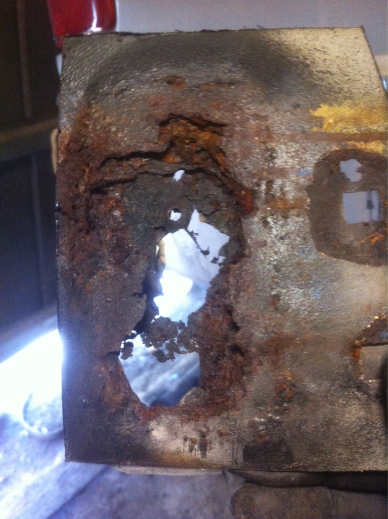

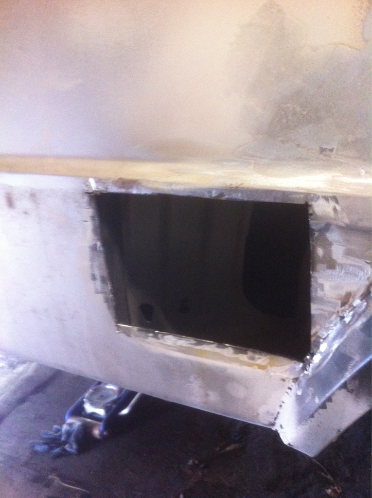

I've been plugging away slowly, I really hate body work. Found an old patch Panel today, body work done wrong.
There was rusty mig wire sticking thru the panel and a 1/4 of bondo on top, never sealed at all.
Re: Steve's 86 4kqTdi
Post by vt10vt »
Yeesh can't say I haven't done worse tho ;) I hate body work too but it looks like you're at least pretty good at it! Digging those wheels too

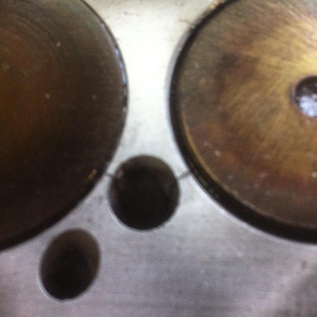

I started cleaning the head in prep for port and polish, found this.
All 4 are cracked, 1-2 are the worse I'll be pulling the valves to see if I need a head.
Yuck
I have two ALH heads. One with messed up valves and one with unknown valve damage (where the crank broke in my tdi swap). I'm sure you can find some closer but let me know. Pay shipping and they're yours.
Sucks about the head cracks, but I love those wheels! Nice looking car, and props on the bodywork. Looking forward to seeing how it looks all finished up :)

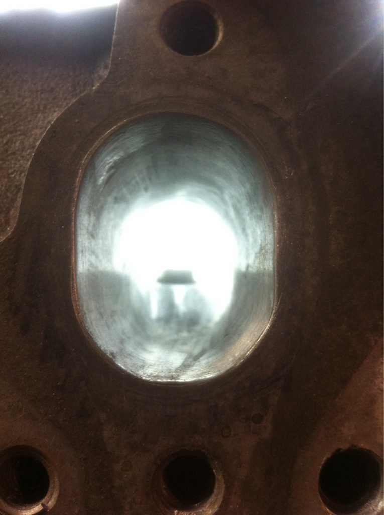

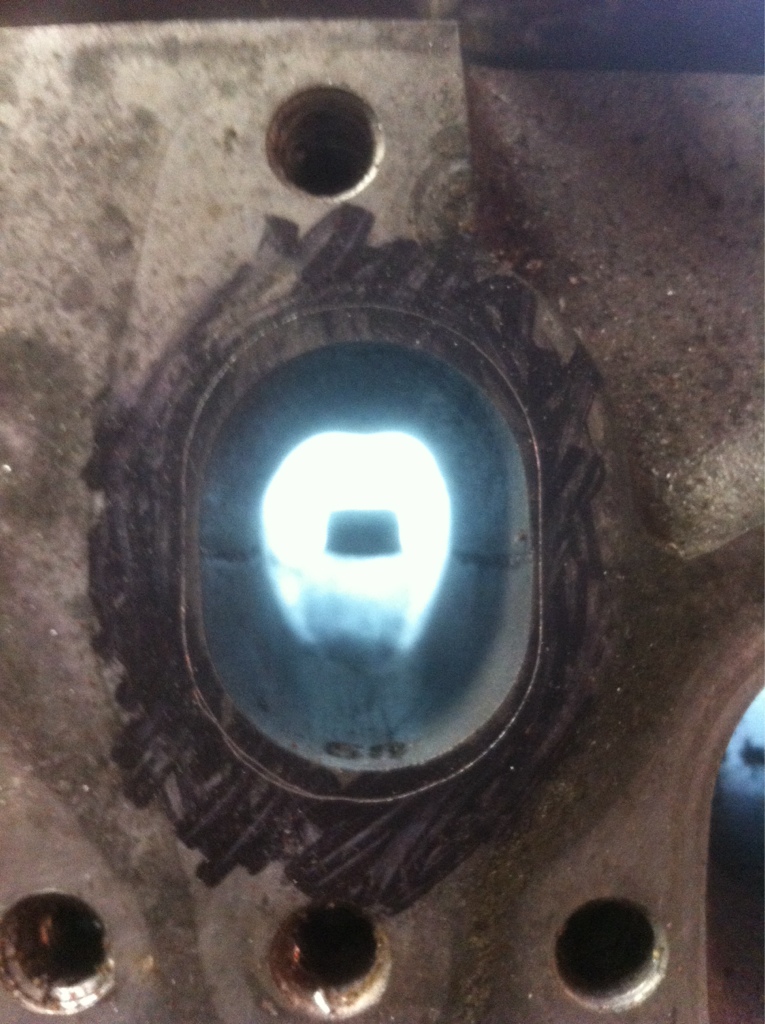

Practicing on the broken head.
Stock exhaust port
Rough gasket match lots more work to do on it.

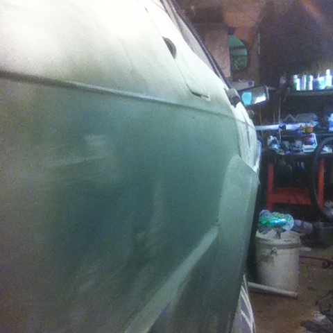

Pass quarter almost done, some detail sanding and final coat of plastic should finish it off. Next I'm going to tackle the rear pass door handle...
Lookin' good so far - really dig the subtle touches

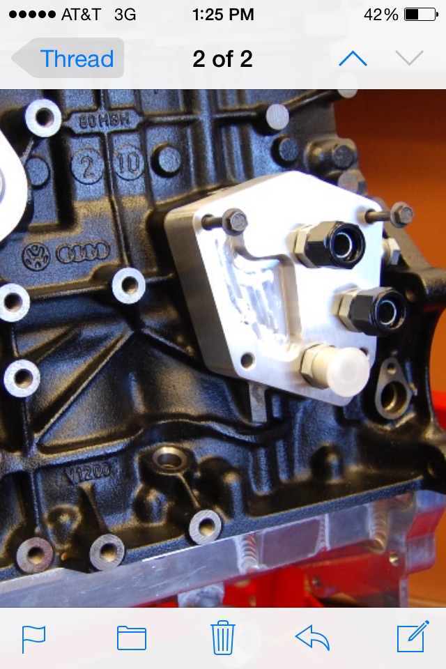

Ordered oil filter relocation plate from Ina today, it will allow me to use stock motor mount location.
scubagli
Posts: 604
Location: leeds ny
Post by scubagli »
It arrived today, very nice piece, has oil in/out, crankcase breather as well as turbo feed and oil pressure ports and a one way valve to prevent turbo feed from draining back.
NICE piece!
