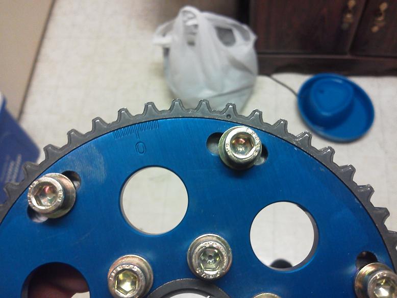

Has anyone ever run into an adjustable cam pully that the adjustment marks didnt line up with the mark on the outer cog? Well here is what I got in an eBay auction from a guy in Canada. Im not sure, But Im thinking, maybe the outer section was switched with a different pulley? is that even possible?

Can you flip the pulley around? Are there markings on the back of that cover plate?

I did take the outer ring off and look for exactly that. There are no marks on the back of the plate. The front of the outer ring is machined to fit the plate. There is no way to flip it around.
Re: 20vt B3 (The Black Bandit)
That looks like a 20v style belt too.

That is odd, but not a show stopper. I would just inscribe a mark on the adjustable portion so that I knew how much advance or retard I was dialing in once the timing was set. It would be interesting to see where the dot on the gear lines up when on top dead center with the crank. You gotta wonder what position is correct.....the dot, or the adjust slashes.

Just make sure the cam is lined up with the crank. 3 full rotations before cranking
Hank, I'm using the super torque belt setup from the ng if that matters. Eurospec says that their pulley is designed for the late 20v setup.
Quattro87, as soon as I make sure the dimple on the back of the pulley, and the key line up correctly, I'm going to make a new dimple at the marks.
Good advice jarred, thanks.

I checked out eurospecs website and your cam gear is completely different from what they have pictured. Either its an older version or its a cheap knockoff.

40v4kq wrote:I checked out eurospecs website and your cam gear is completely different from what they have pictured. Either its an older version or its a cheap knockoff.
The seller said he has a few if these that he purchased a number of years ago.

They were probably accounting for the old crusty rubber dampener to spin on the crank pulley. This is just compensation to keep at TDC reference marks :)

Dan, not sure where you looked, but here is te page I found. The one shown for the Audi 20v is exactly like the one I purchased

And there is no way to rotate it to where it lines up?
Nope, it only turns as the slot width. And the the dimple being practical at the bolt...
