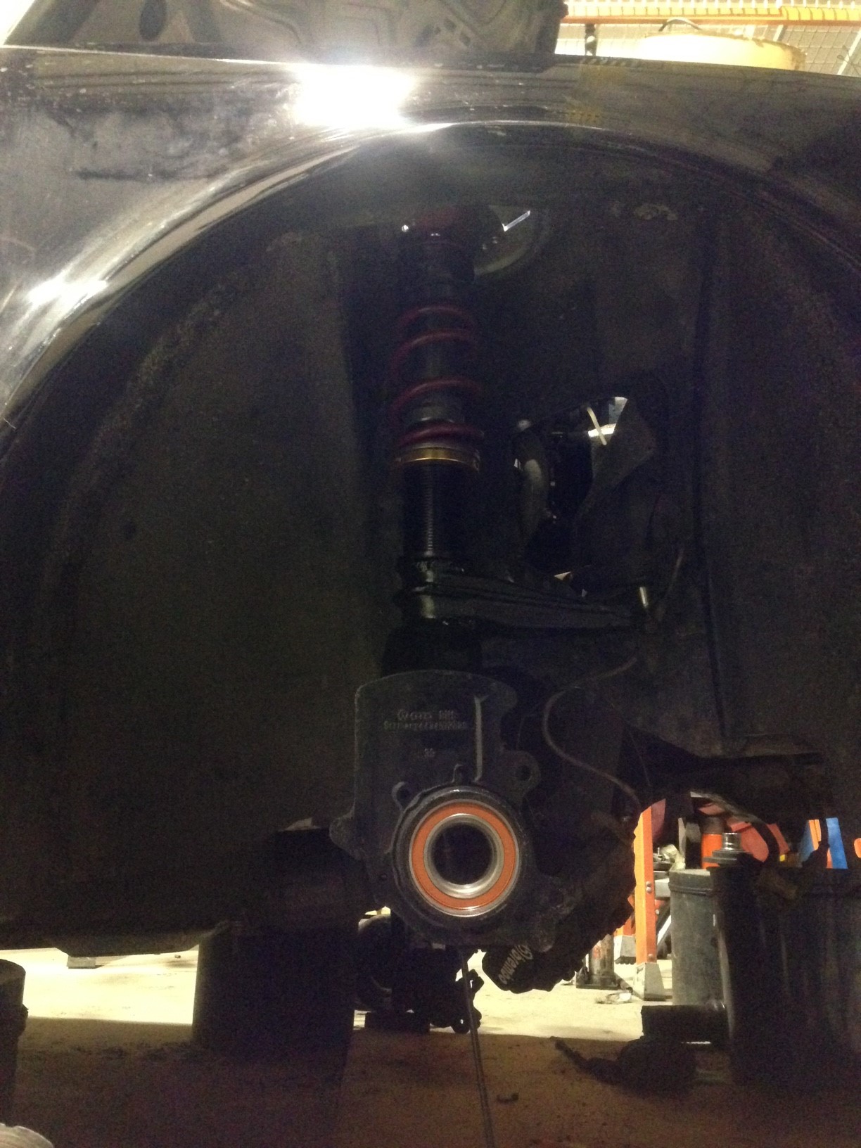

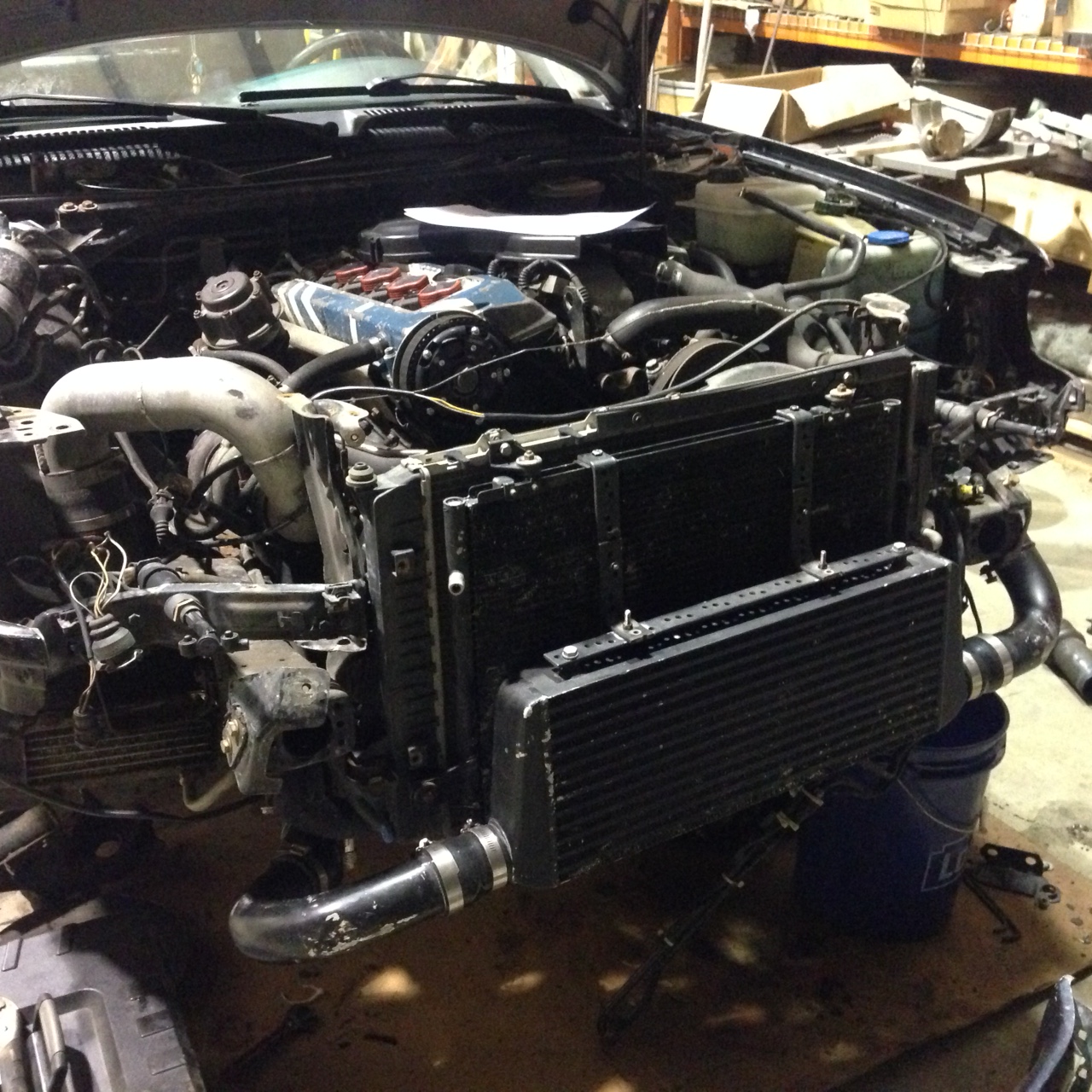

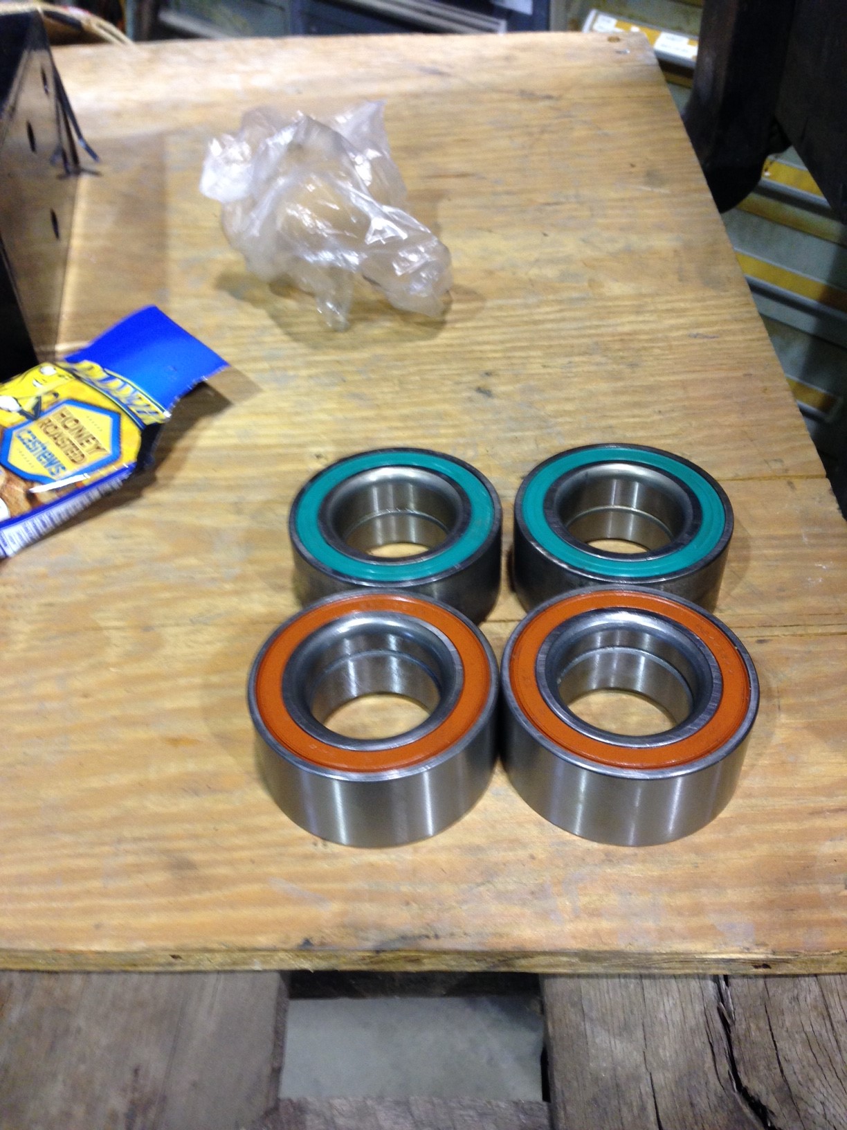

Another busy night burning the midnight oil... Got two OEM axles in hand that only need re-greasing, I got the final pipe routing for the FMIC completed, I got the wrong bearings pressed out and the correct wheel bearings pressed in, and the uprights test fit. The most stressful task at hand now, besides waiting for new swaybar bushings (the subframe ones not the LCA ones), is cutting the euro bumper to fit this IC. :wah: Here's what took place last night.

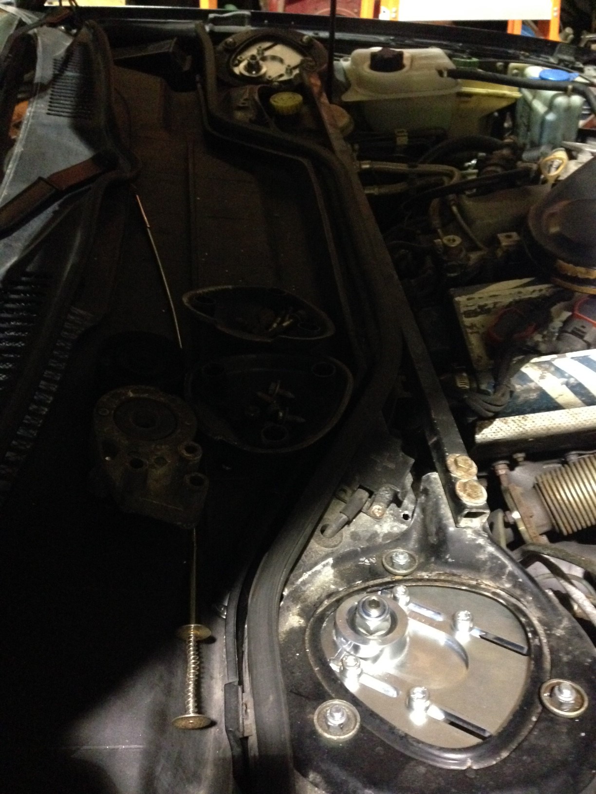

Nothing huge tonight, I got the bumper rebar trimmed back, before I start trimming grilles or anything that affects the look of the bumper, i've ordered some silicone bends to try to remove the need for the aluminum bends that are getting in the way... Got the correct axle in my possession, cleaned everything out, repacked them with moly, and installed new boots. I found a tiny bit of play in one of the thuppu camber plates between the bearing and the housing, so I need to get that sorted out. Small details remain to be sorted out, but the big picture is looking excellent.

I have a definitive answer for my fellow euro bumpere'd s-car crowd considering fitting a FMIC. FOR THE LOVE OF GOD, DONT.
Ive called an all stop on the FMIC project before I hack the hell out of this bumper. Ive already gone too far and am having heart palpatations. I had figured the setup I bought would have gotten by, since it came off a euro s6 with A/C. There is a minute yet MAJOR design difference in the lower grill section, the s6 is almost plumb while the s4 has a gradual rake to it, meaning you start cutting into the material that makes up what you see from the front of the car very quickly. I'm trying one last ditch effort and ordering some more silicone hoses to remove some of the bent aluminum piping. For anyone wanting to upgrade from stock, use an AWIC. FMIC is NOT worth this amount of heart ache.

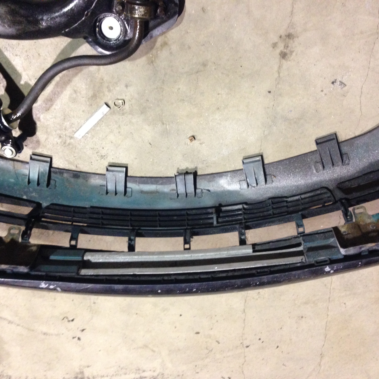

Slow updates lately... parts hold-ups, finessing everything into place, MORE unforeseen issues (rust holes in power steering hardlines can suck ma bag.) I'm finally about a day's worth of work away from rolling into the alignment rack. I got the solid subframe bushings in, the subframe in, the steering tie rods are in, I finalized the intercooler piping and clamped everything down solid, and the euro bumper is finally 90% fit, and it still looks like it should! all I can say is talk about fitting 10 lbs of shit in a 5 lb bag... but here is the fitted modded bumper. I still wouldnt recommend doing what i did!
