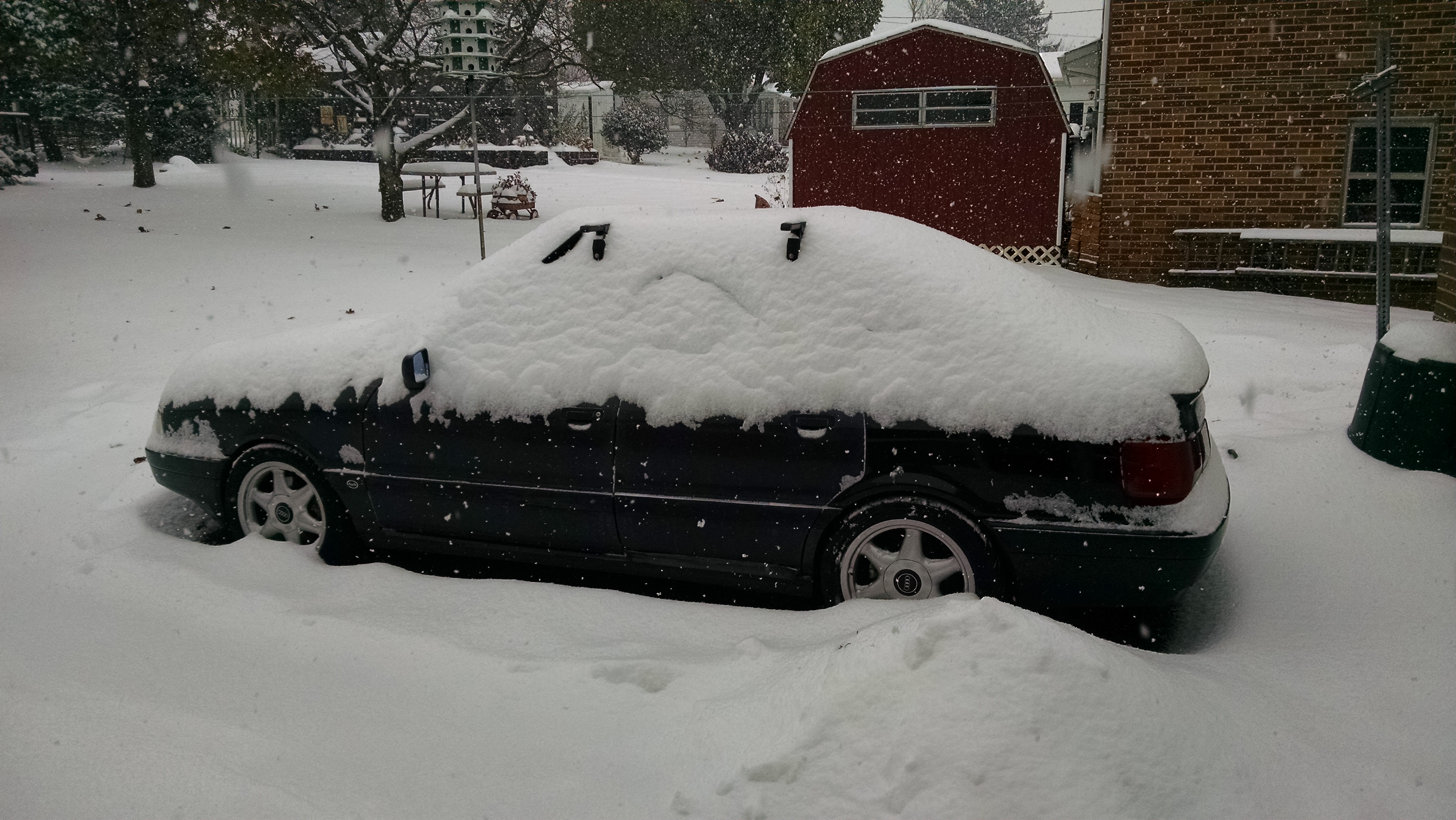

Getting our first snow of the season here in South Central PA... I really expected it to blow right past like all the early storms normally do, but I was wrong! I haven't fixed the CV boot yet, and didn't bother to change over to snow tires. Once again, no playing in the snow for David...
- IMG_20181115_134243777.jpg (3.29 MiB) Viewed 95340 times
