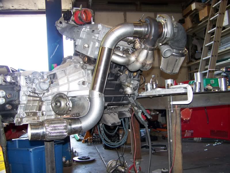

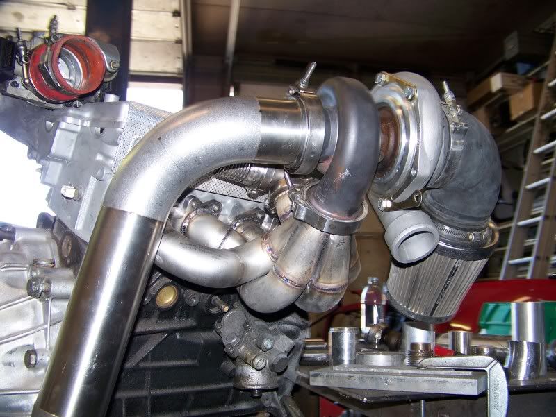

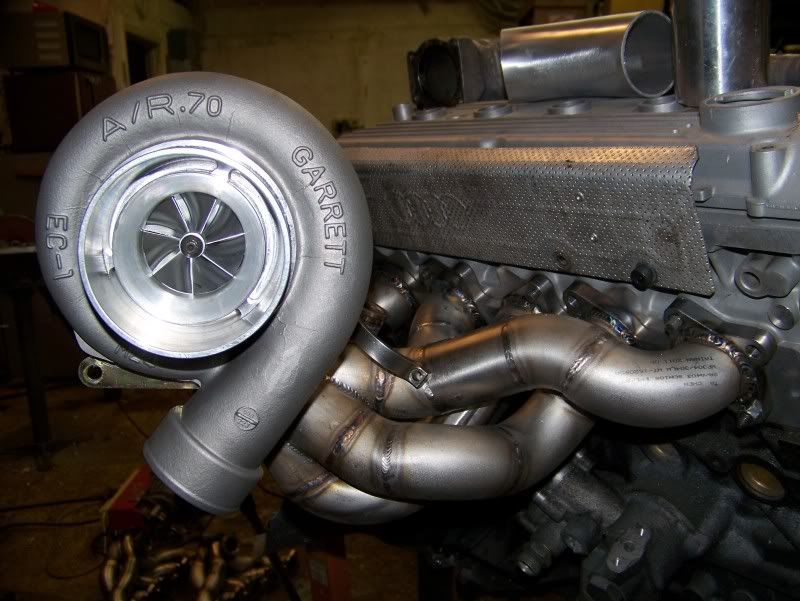

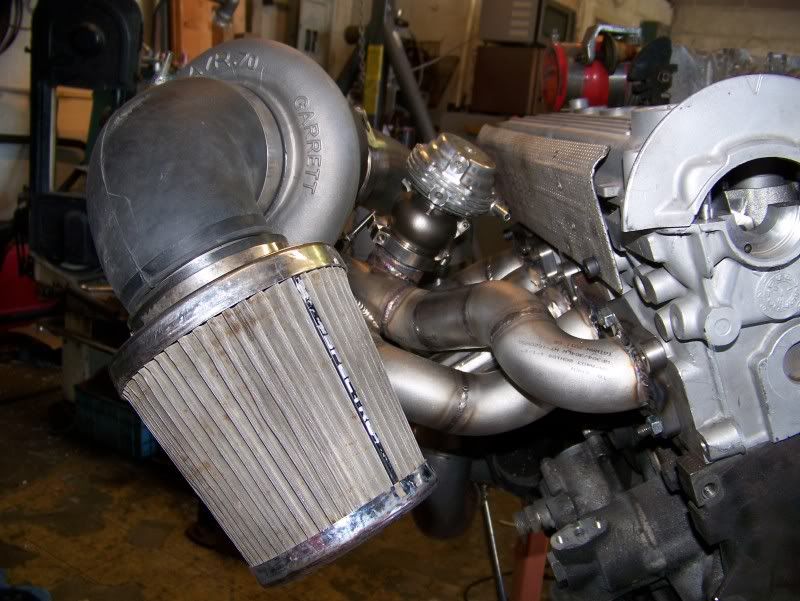

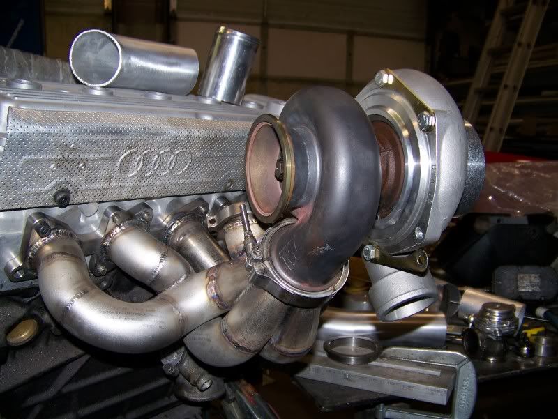

Like I said before, the trip to the Lab was productive. I felt like I couldn't just keep waiting on the EFR Borg Warner turbo and still have a fighting chance of making the Vegas GTG. Because I have His Urq that will eventually be a more track oriented car, I made the decision to go with a Hank built tube manifold and downpipe and run the HTA billet wheel 3076 turbo that I had already purchased for the hotrod Urq. The only time it has seen is when I let Hank and Jim Green dyno it on Jim's car down at 034's place. Just enough time and heat to take the shine off of the Tial SS hotside housing. Once the decision was made, Hank and I put in some long hours in between family stuff to come up with something that would work.
Hank, thankyou for your time and effort this last few days.
Here is the tube header and the header being mocked up for a downpipe build.
Downpipe welded wiith charge pipe being fabbed.
Placement of 38mm tial wastegate. I went the 38mm for the low profile and because I don't plan on running a really big turbo that would have a hard time being controlled at low boost levels with the smaller wastegate. If need be, when the swap is made to the hotrod, there is still room for a 44mm wastegate and that build will have a forward facing custom intake manifold on the other side that will free up space the the bigger wastegate.
