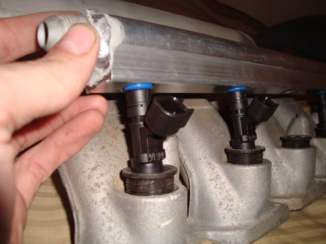

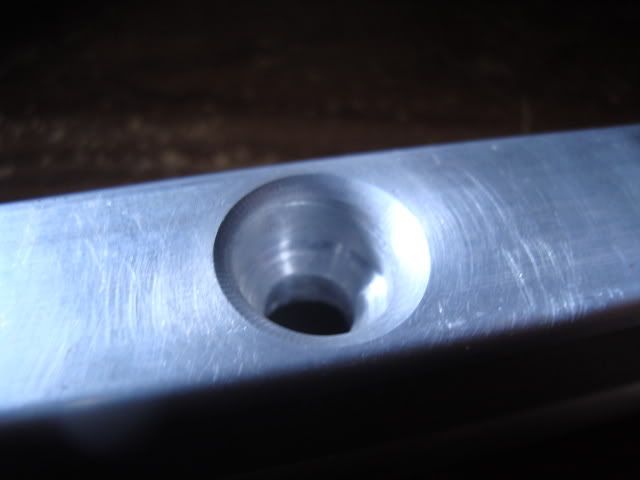

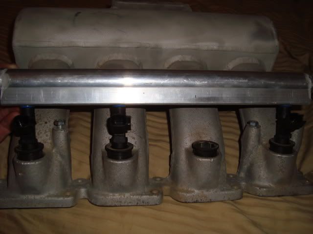

my bud made me my fuel rail this past week. got some -8 male ends welded to either side, and had the injector holes made. looks pretty, seems to line up perfectly, and now its on the top of the 'things to powdercoat' pile.
speeding-g60
Posts: 2152
Post by speeding-g60 »
dont forget to weld the tabs on it to hold it to the manifold.... after its put into the cups after they are screwed into the manifold. :)

helll to the ya. i just gotta get things final fitted on the motor before i do little odds and ends like those tabs.

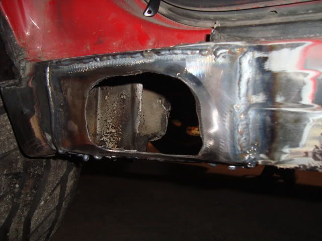

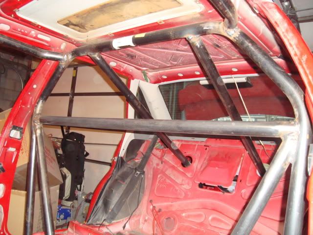

im still alive update. car was gone for a bit getting the cage welded in. now its back, i gotta paint the cage, then itll go off to my buddies shop once hes ready for paint. then final assembly. holler.

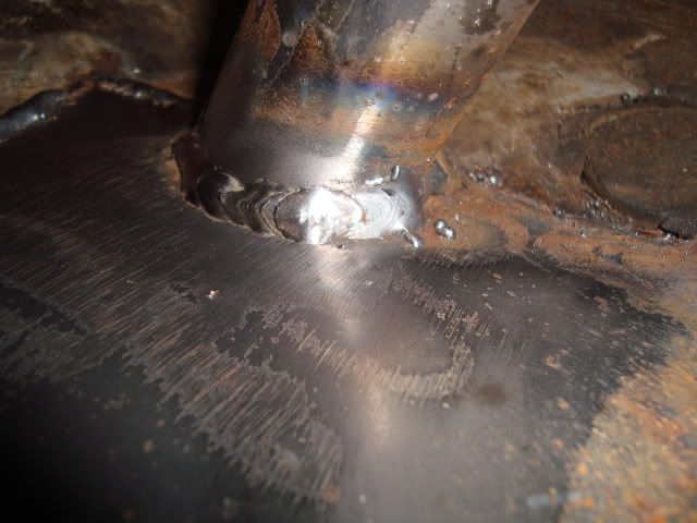

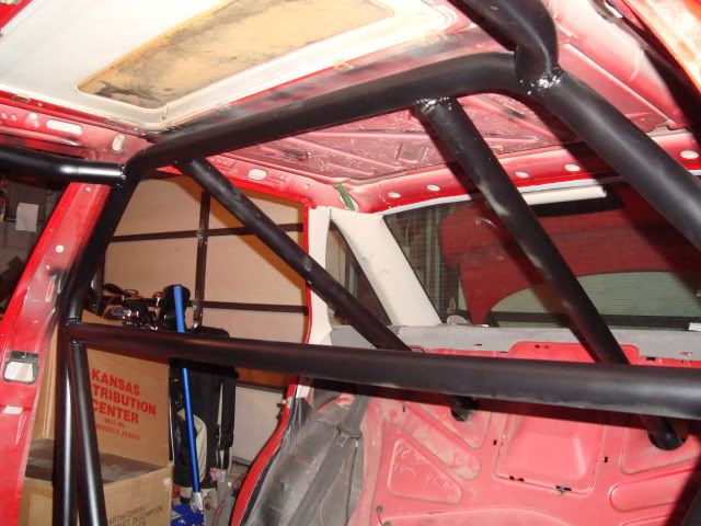

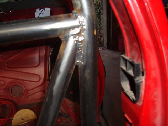

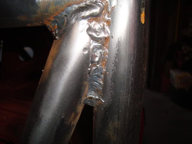

few pics of the welds, and the wire harness that i made as well.

take a wire wheel on the grinder and knock all the little crap you can off. maybe a chisel if needed to knock away all the little BB's.... and right after you grind the welds with the wire wheel, paint them.
that weld, where the hoop comes down and the "D" bar goes inward to the floor, in the last picture, that weld is a bitch, huh.... hard to get at.
aned welding the floor plates is the suck, too.

took a wire wheel to it already. then immediately primed it and just got done painting it, lol. pics later. i just didnt do the floor pieces yet because i have to do a bit more welding on those before i final spray them. i do wish i went with a tubular front end at this point in time though like you did. the friend who was welding it asked why i didnt cause...."what happens when you hit the wall with this thing since you cant drive for schit and you wreck everything in the engine bay, but inside is fine"...to which i agreed with him but added that my ass will be in the car, not the engine bay. and i also think ill be replacing those aluminum tie rods that i made with steel ones, cause im not trying to have those break on me.

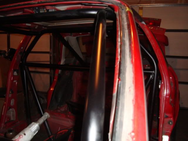

painted low gloss black.
psychorallyfreak
Post by psychorallyfreak »

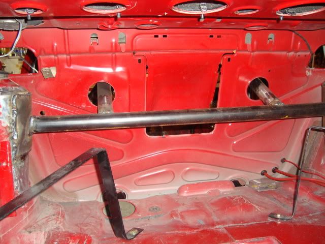

Those rear bars should go to the strut towers.
Zerb
Posts: 858
Post by Zerb »
i actually wanted to bring those bars down to the frame rails in the back. but i opted not to. those bars attach to a a bar that runs from strut tower to strut tower.
psychorallyfreak
Which isn't really gonna do a whole lot of good, since the bars don't work very well with bending loads.... Hence the need for triangulation.
Zerb
Posts: 858
Post by Zerb »
interesting. i ran this by a few others that have built cages and was told that this should work out just fine.
RSCoupe
Posts: 217
Post by RSCoupe »
psychorallyfreak wrote:Those rear bars should go to the strut towers.
:stupid:
They are to far inboard. Also, the other end is a little far from the corner junction. It would have been best to have them tie into the corner of the main hoop, where the upper roof bars come in. As is, any load transfer from a crash will really bend those bars, leading to failure.
The main thing to remember when building a cage is that all the main bars should be triangulated.
Mark Siggelkow
'90 CQ-R - NASA GTS-4
'12 TT-RS (Wife's DD)
'00 A4 1.8TQ (My DD)
'62 356B (vintage racer)
Zerb
Posts: 858
Post by Zerb »
well, this was my first attempt at a cage ever....so i guess you live and you learn. one thing to remember here is that im also just building this car to go fast in a straight line and have a few spirited drives through the backroads of mid-upstate NY, not going to any type of sanctioned road course events. im aware safe cage building is safe cage building, just throwing that out there though.

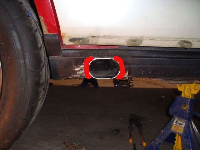

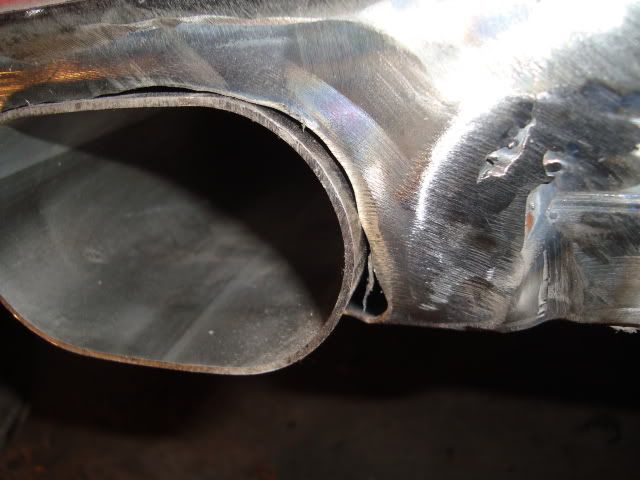

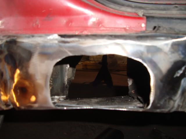

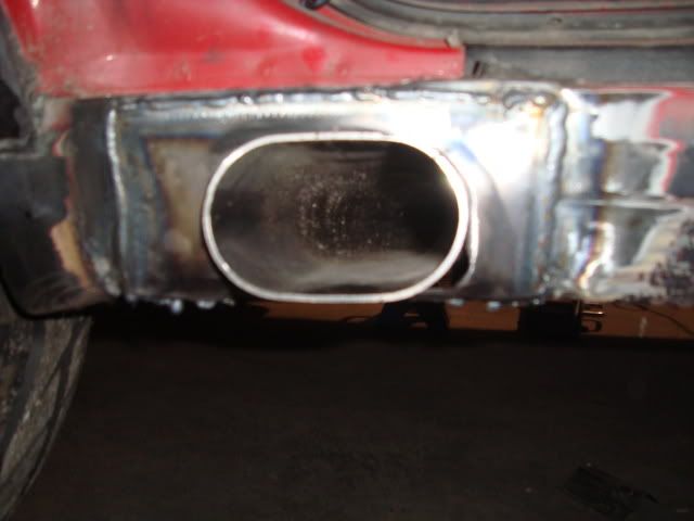

so, i did make the exhaust go out the rear of the car...but after seeing haydn's project thread and then finding some cool oval tubing in the exhaust book at work the other day. i had to go out the side, and through the rocker.
here's the preliminary pics, i'm going to fill the front in (the red in the picture) with sheet metal, grind it all flat and be done.

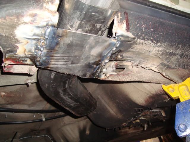

Zerb
Posts: 858
Post by Zerb »
few hours later update...
Longitudinal
Posts: 107
Post by Longitudinal »
Is that oval tube going to be the passage the exhaust pipe passes through or the exhaust pipe itself? If the latter, it is way too close a fit as it is.
