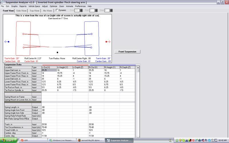

PxTx wrote:Very cool! Visual aids reallyed helped me grasp things here. I can't wait to see where this is going! :woowoo:
yeah, me too! i can picture a certain amount of stuff in my head, but this helps bring the concepts together.
and yes sam! i actually downloaded the trial of that program last night. i need to get a bunch more measurements to work with it 8)

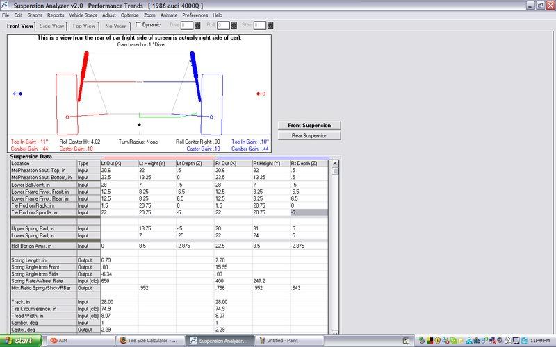

ok, stock 4kq geometry... with a 4.02" roll center, and camber gain of -.44*
2" lowered 4kq... with a -.35" roll center and camber gain of -.22*

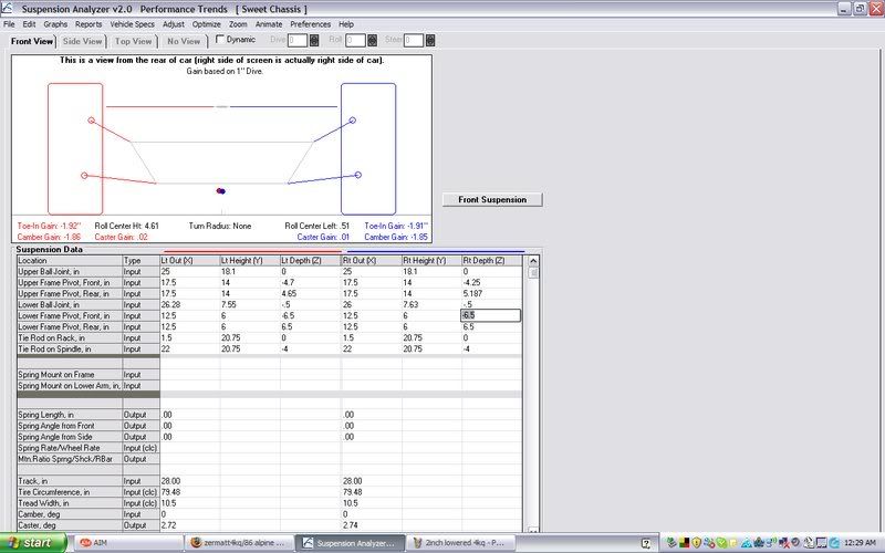

5.5" UCA with all stock location lower control arm, and spindle, just adding the upper control arm... roll center of 9.85", and camber gain of -3.32*
8" UCA, with LCA inner mount point moved up 1". puts the roll center back at 4.61", with a camber gain of -1.86*
i'm going bed, yikes my head hurts. but i do gather that the last scenario is a pretty ok one...

ok, i think i'm getting somewhere!
this last revision is getting me these #'s...
static 11.5* negative castor
dynamic 12.6* negative castor
static camber at 0
1.7* camber under 2.5" straight up and down compression
outside wheel progresses to -7.5* at full lock under 2.5" of suspension compression
inside wheel gains +3.7* at full lock under 2.5" compression
toe changes are .20" toe in under 1" of dive,
or 1.1* of toe in at 2.5" compression
and 2* of toe out at 2.5" above ride height, which as far as i can tell, translates into a littl toe out under hard cornering. in conjuction with the castor and camber settings, the inside tire is getting 2+ degrees of positive camber keeping the tire flatter instead of just dragging the inside edge along the ground and wearing it down to the cords.

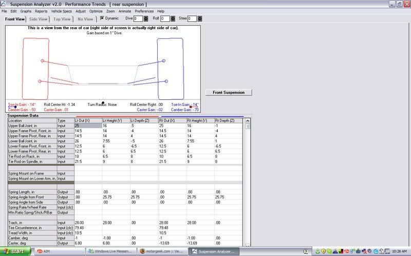

i also did a little fiddling around with the rear suspension as it's much simpler
2.5* negative camber under 2.5" travel
-1.3" roll center which should help with understeer (higher roll center in the rear promotes understeer)
if anyone see's any major flaws, i'd really love some input. otherwise i think i'm the right track here and i'll start gathering some parts soon to let the building commence
