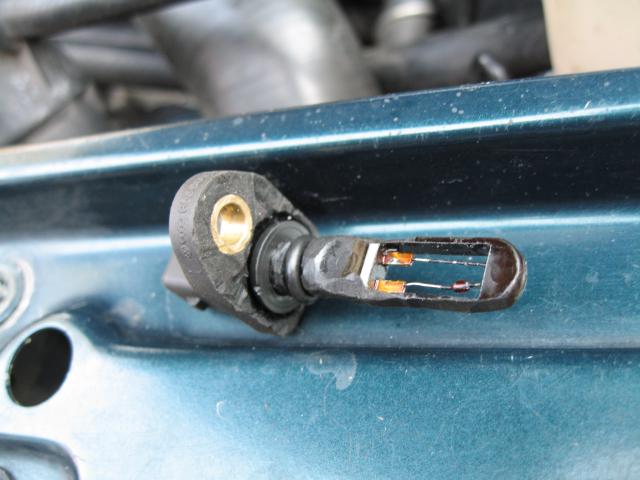

Spent some time today cleaning up the car, I figured 'winning' the dirtiest car award at the last Hartford area GTG was the last straw (hey, in my defense I had just installed the 3071 and 60lb injectors, I had tuning to do!)
So while I was at it, I fixed a small air leak around the 1.8t IAT sensor I'm using. I opted not to drill out the hole in the intake manifold so instead I altered the sensor to fit in the smaller diameter hole.
To do this, I trimmed plastic along the side of the sensor and cut a deeper grove for the o-ring and used a smaller ring to suit. I also swapped over the o-ring on the back face of the sensor and a matching grove to hold it:

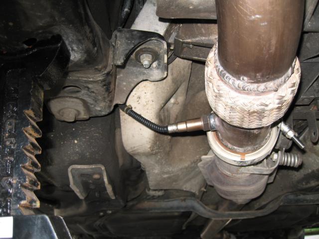

Ok, another update on the exhaust saga.
I made the final tweak to the downpipe on Friday. Before:
before:
after
I forgot to take that pic without the bolts in, but anyway they lined up without any forcing unlike before the re-weld.
I also took the opportunity to relocate the wideband o2 sensor to the bottom of the downpipe where it will lead a much happier and cooler life
So now onto working on my boost controler.. The settings I have work awesome up to 24psi, and then when I try to raise it up _something_ is going hawire. Boost spikes to 30psi and stays there, and I lose communication with the ecu :wtf: (yes, the cable is fully seated when this happens).
