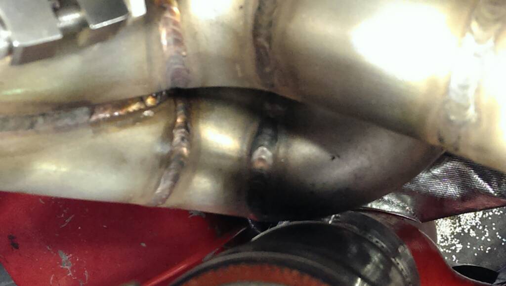

Re: A tale of Rubí... BPV to BOV
So I go get some simple silicone and aluminum pipe for my compressor to FMIC situation and I always end up walking out spending more than expected... Not a slippery slope, more like a ski diving...

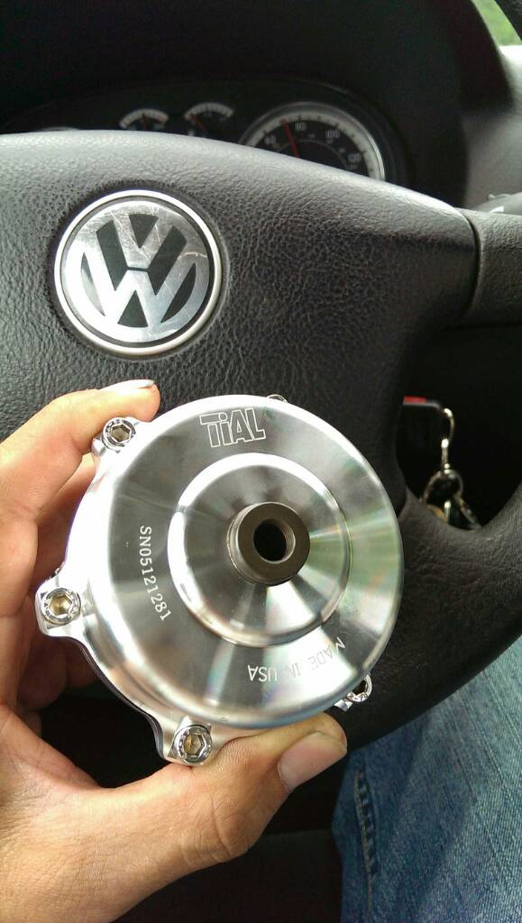

mushasho wrote:... Funds, time & effort going toward going solid pipe from compressor to FMIC...
And the Tial BPV..... :D
That was the "funds" part... the "time" part is happening right now... searching like a mad man for undercarriage pics of FMIC piping on cars with non-stock location turbo's...trying to figure out things like:
...a) should I route behind the radiator or behind the headlight :idunno:
...b) why's everyone trending on moving the BOV to the intake side of the motor :idunno: ect...
Re: A tale of Rubí... Start up, Sperry and M3's... Pending:
I don't understand your a) question... but I chose to keep the intake piping away from the heat of the header and route it on the fender side of the frame rail. Gives you a ton of room.
b) having the BOV as close as possible to the throttle body is ideal
I hope you don't mean the pipe is going to actually be solid (no flexible joint). That is just asking for trouble.
loxxrider wrote:I hope you don't mean the pipe is going to actually be solid (no flexible joint). That is just asking for trouble.
It will have minimal silicone coupling for flexing... Just need to get rid of this temporary situation...
