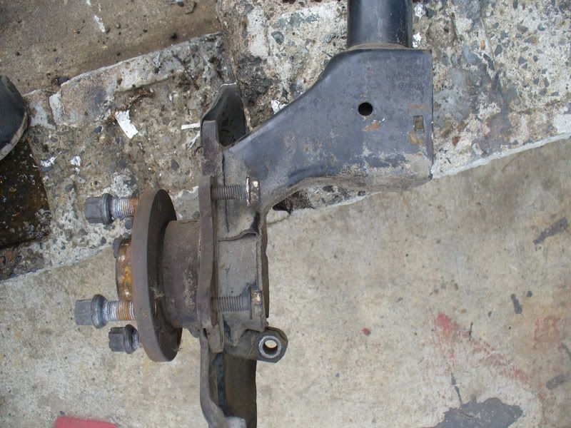

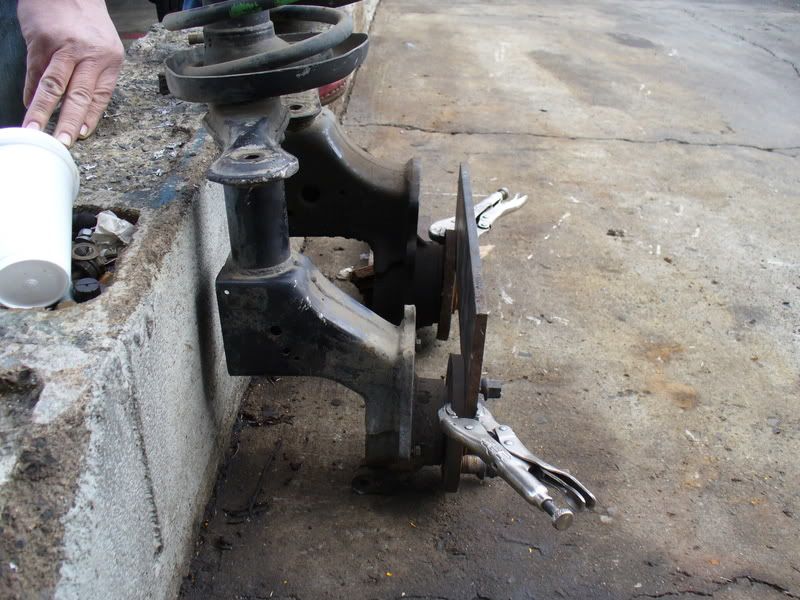

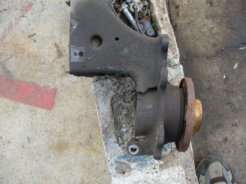

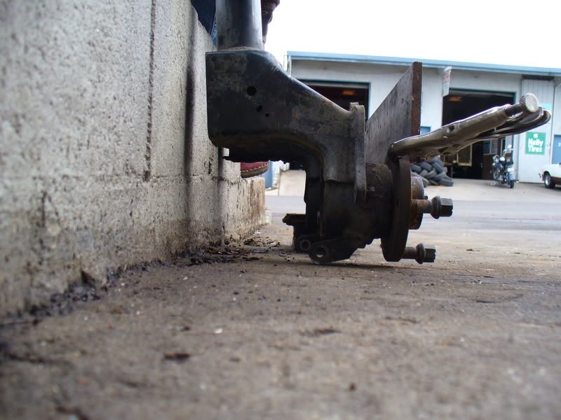

small update. i finally got two struts in a position that i could compare them side by side. this is for the five lug swap (that's for the search function ;)). i have a 5ktq front strut, and a 4kq strut. overall it looks to be about 10mm difference in how far the 5ktq strut will push the wheel outward. luckily, i think my B3 strut already has 5-10mm over the 4ktq strut, so i should be pretty close in the ball park with achieving my goals in tire fitment :)
measurements are as follows. (keep in mind these are as close as i can gather with a standard vernier measuring caliper)
-----------------------------------------4kq---------5ktq
hub face to strut tube centerline - 162mm 172mm
hub face to lower ball joint center- 70.5mm 75.5mm
strut tube centerline to bj center- 78mm 88mm
hub face to caliper mount face- 53mm 56mm
pics...
4ktq strut side profile
5ktq side profile
