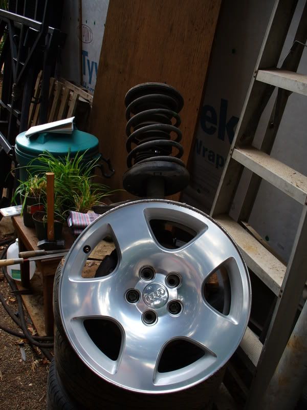

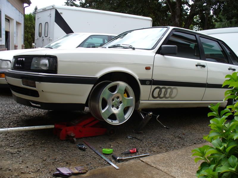

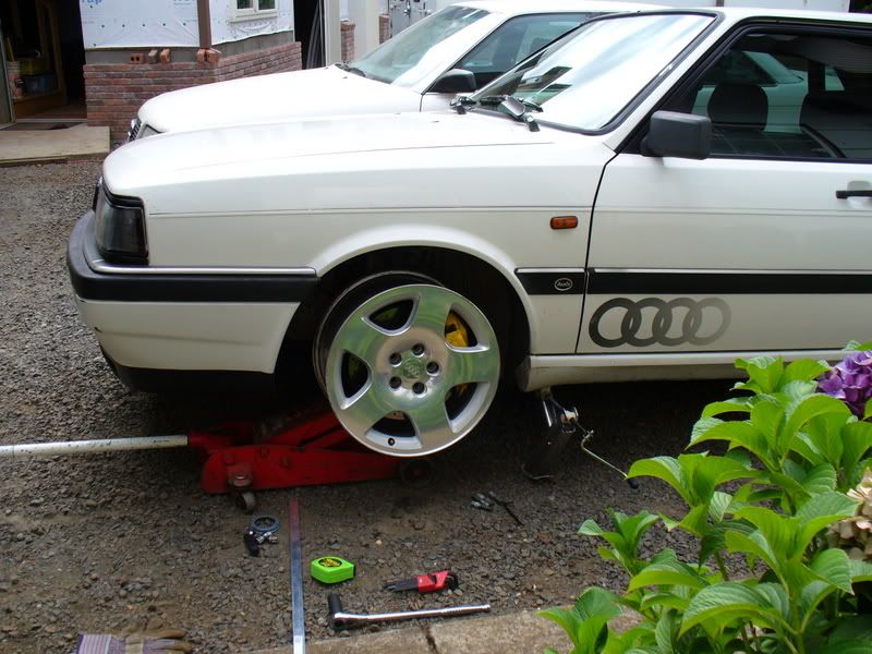

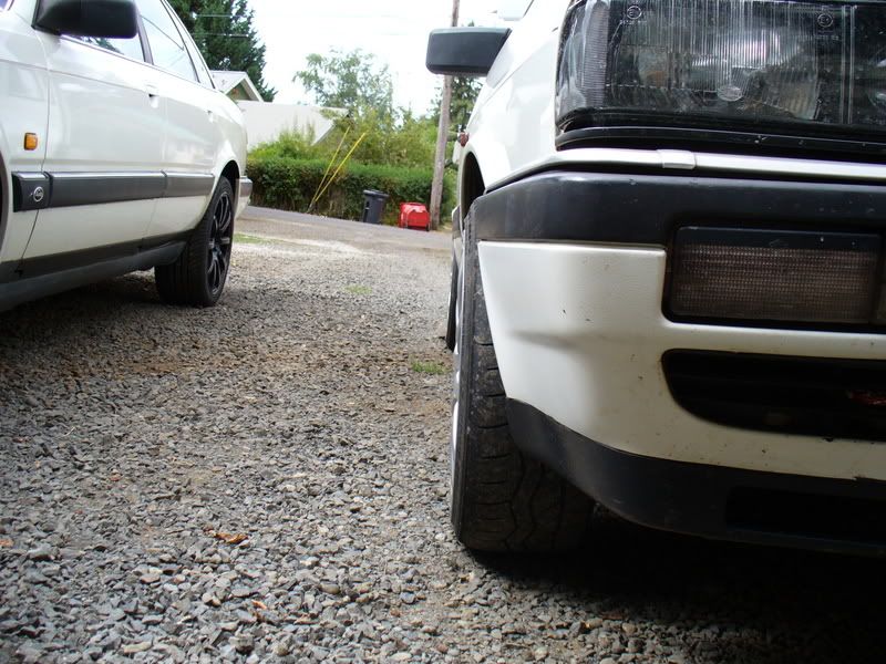

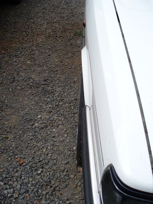

okie dokie! yesterday i picked up a couple of OK shape A8 wheels. spec are 17x8 ET48, which as you might know will set the wheel very far inward, allowing for wider wheels without wider body work. i hitched up one of the wheels onto a spare 5ktq strut assembly i have here and the measurements look great on it. i then removed the wheel on my 4kq (which has 90q struts on it) and mounted the wheel on the hub. first thing, is that it ever so slightly touches the 996C calipers. it could be fixed easily with about a 3-4mm spacer. the good news is that the wheels stick well within my fenders, like maybe a 8-10mm more than the ronals, that's good for tire clearance, but not so much for caliper clearance... the double edged sword i'm working on here
here's a few pics

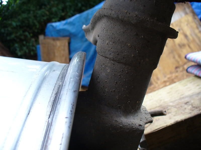

bout 10mm of space, more than plenty
3" is how tall the sidewalls are on the 235/40/17's on my v8q, so i figured it a safe bet to work with.

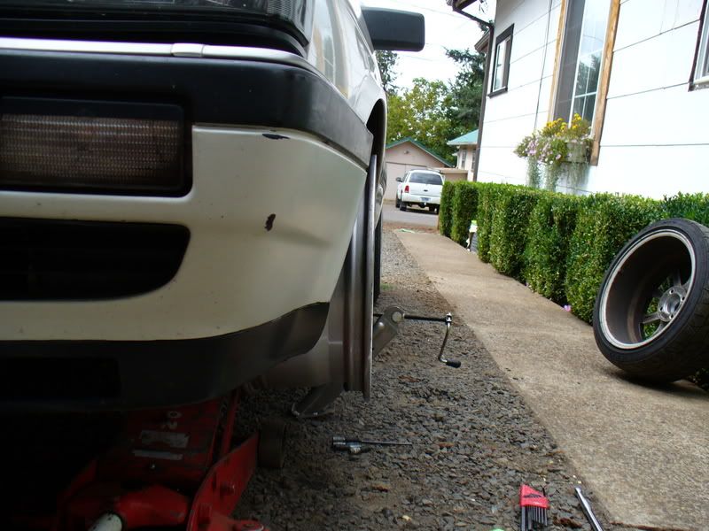

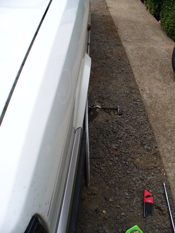

ronal side. you can see the rim actually protrudes a little past the fender lip.
A8 side. still tucked inside a good deal.
hmmm... i think those'll look yummy
worst case scenario is that i'll have to bail on the 6pistons (which i'm going to try my absolute best to stuff in there) and live with the marginally ok 4piston calipers
also, like i've said before, i'm not opposed to lifting the car a half inch if needed for more clearance tirewise. it's not an impractical move in any way.

yeah, but are they ET48? probably more like ET35 ish which opens up a whole 10-13mm more clearance. if these were ET43's, i'd clear my current brakes no prob, but would need about another 5mm of clearance for the 6pistons. i'm wondering if the 6piston face can be milled down slightly *rubs chins* literally, every couple mm's of clearance here helps. i want these 6pistons on in the worst way

Looking at these two pictures, won't you have tire rubbing issues at the end of the steering arm? Looking at the first picture, the steering arm goes beyond the inside plane of the wheel, where the tire will be.

in my earlier post i said i'm planning on new steering armsRSCoupe wrote:Looking at these two pictures, won't you have tire rubbing issues at the end of the steering arm? Looking at the first picture, the steering arm goes beyond the inside plane of the wheel, where the tire will be.
