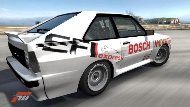

Hey Marc...look what I made
Re: Loxxrider's 200 20v: Running Awesomely again :)
ignore the broken tail light...I was having a little too much fun on the way to the photoshoot spot
ha, sweet! forza?
ya Forza 3. If you've got the game, its for sale in the marketplace if you search loxxrider. I know you want it!!! lol
