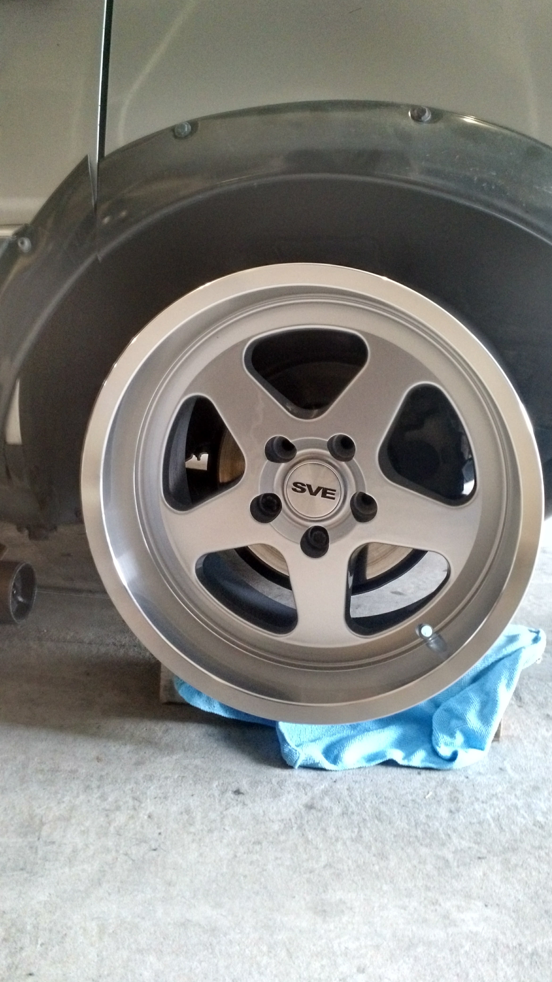

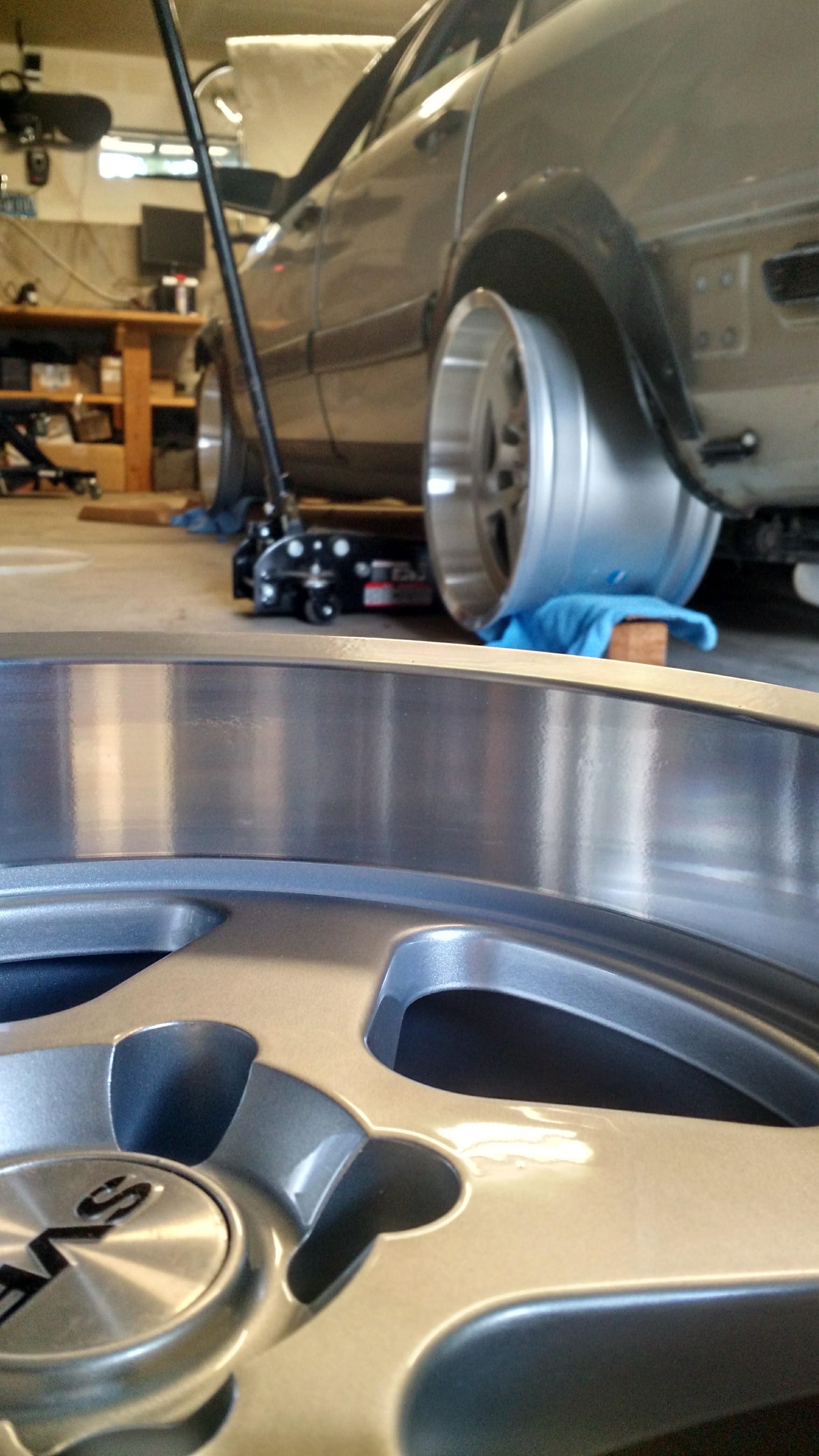

StanceNation Son.
- IMG_20170413_181525.jpg (973.1 KiB) Viewed 59443 times
- IMG_20170413_181551.jpg (1.08 MiB) Viewed 59443 times
Re: Phil's 20vt 5ktq, "TurdQuat" EFR7163
I wanted to run these x10's so badly... settled on 9's since I didn't have the fender, but I'm REALLY pumped to see this on yours!

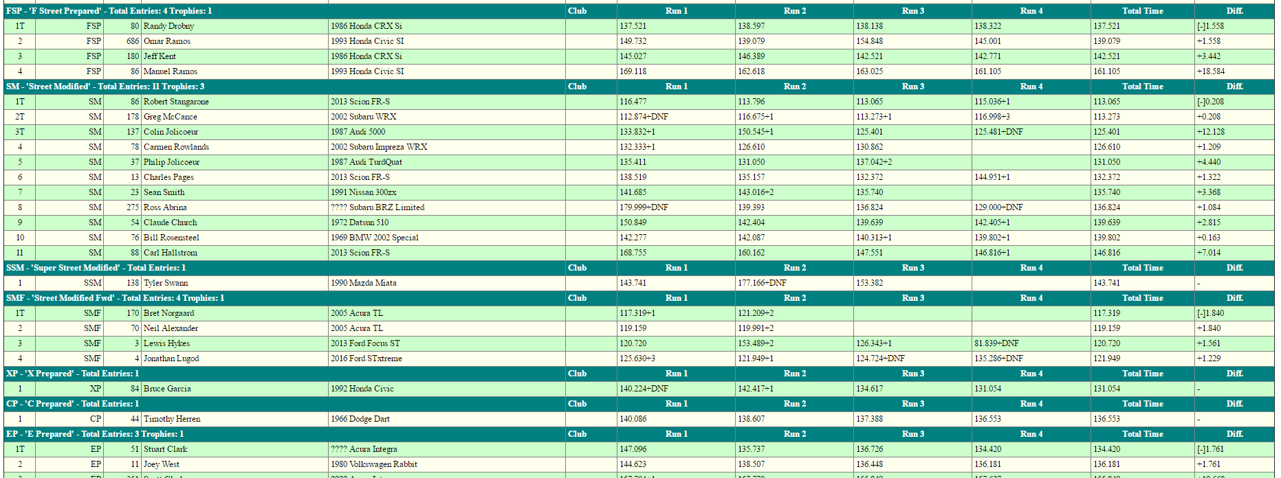

Some times from Saturdays runs.
I'm pretty sure I would have beat Colin's best time on my third run, but I fucked up at literally the last 10 feet and hit a cone and came to a full stop for what felt like a solid 5 seconds.
Final run the car in front of me broke down and tried to coast to the end of the course, which made me catch him and get a re-run. My brakes fully disagreed with running a final re-run and decided to practically catch fire.
