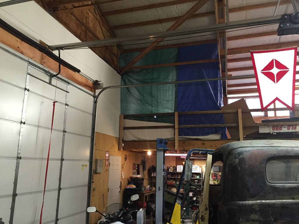

Todays project, something ive been meaning to do. Build a "paint/dirty room" so I can not have to worry about grinding dust and paint getting on stuff I have in the shop. Need to get a fan and some lights, and some flame proof blanket and I'll be good to go!
The outline

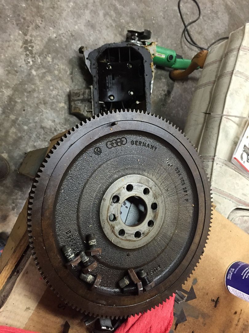

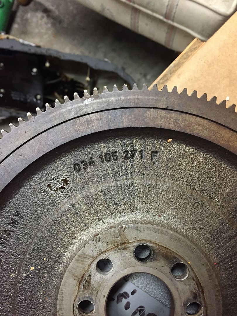

Looked at the flywheel, wasnt really paying a ttention when i stripped it down.
looks to me like a stock single mass, 3b, for the 016 trans.

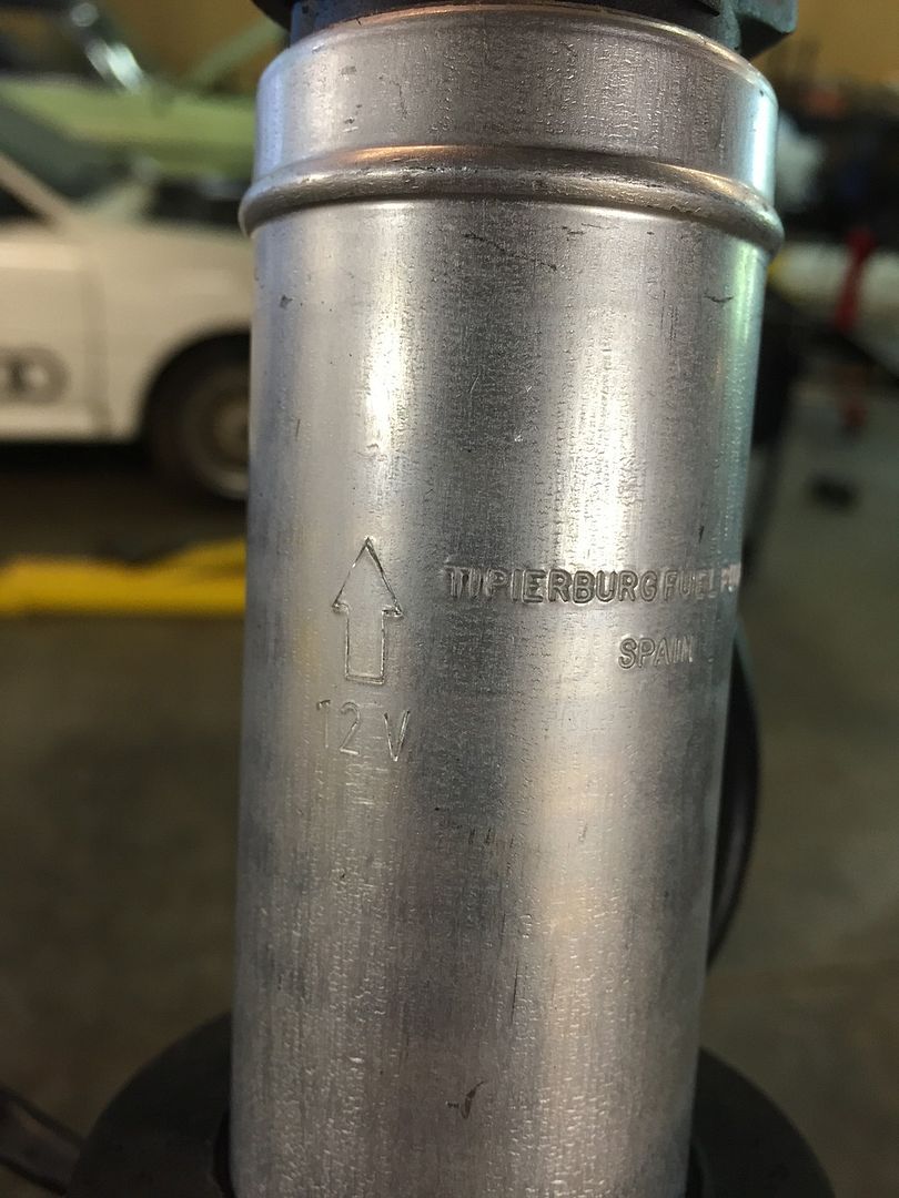

Pierburg fuel pump that came with the car:

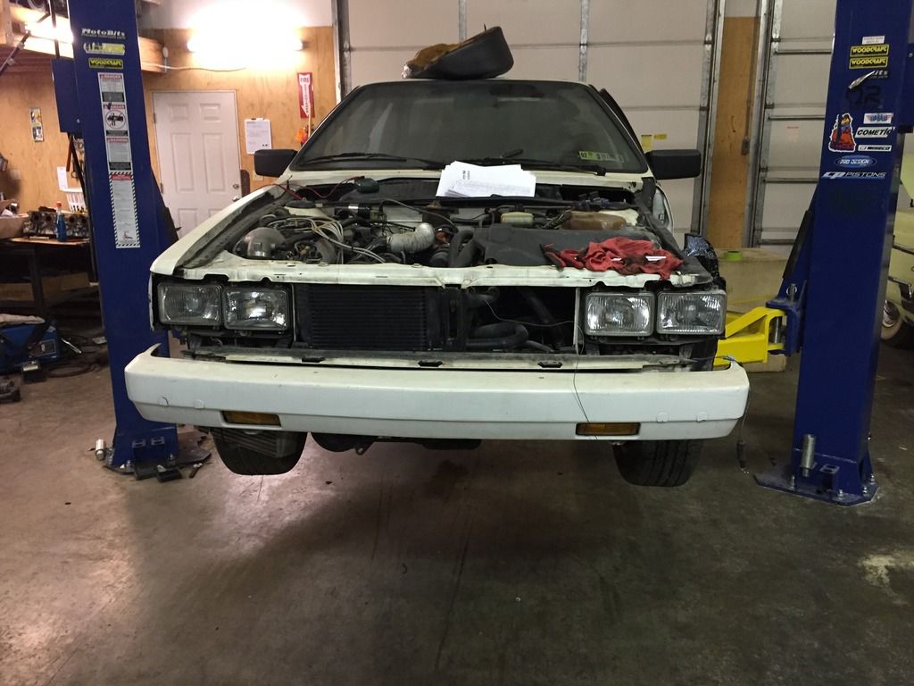

Going to get started today on getting the engine ready to come out the bottom so I can get to cleaning on the engine bay and what not.

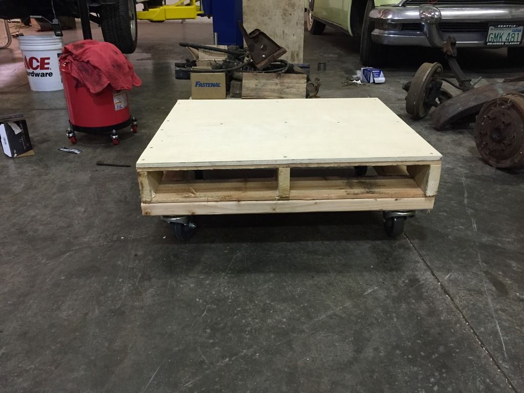

I cut it at the cat, looks like I should be able to squeeze it out.
Made a nice little rolling pallet setup to drop everything on to.

Started getting the CIS out of the way, Radiator out, disconnected drive shaft. Now I'm stuck on tie rods, Seems like there is no way these are coming off. After disconnecting all the fuel lines I didn't feel like using a torch right there but I did everything short of that (with what tools I had).
