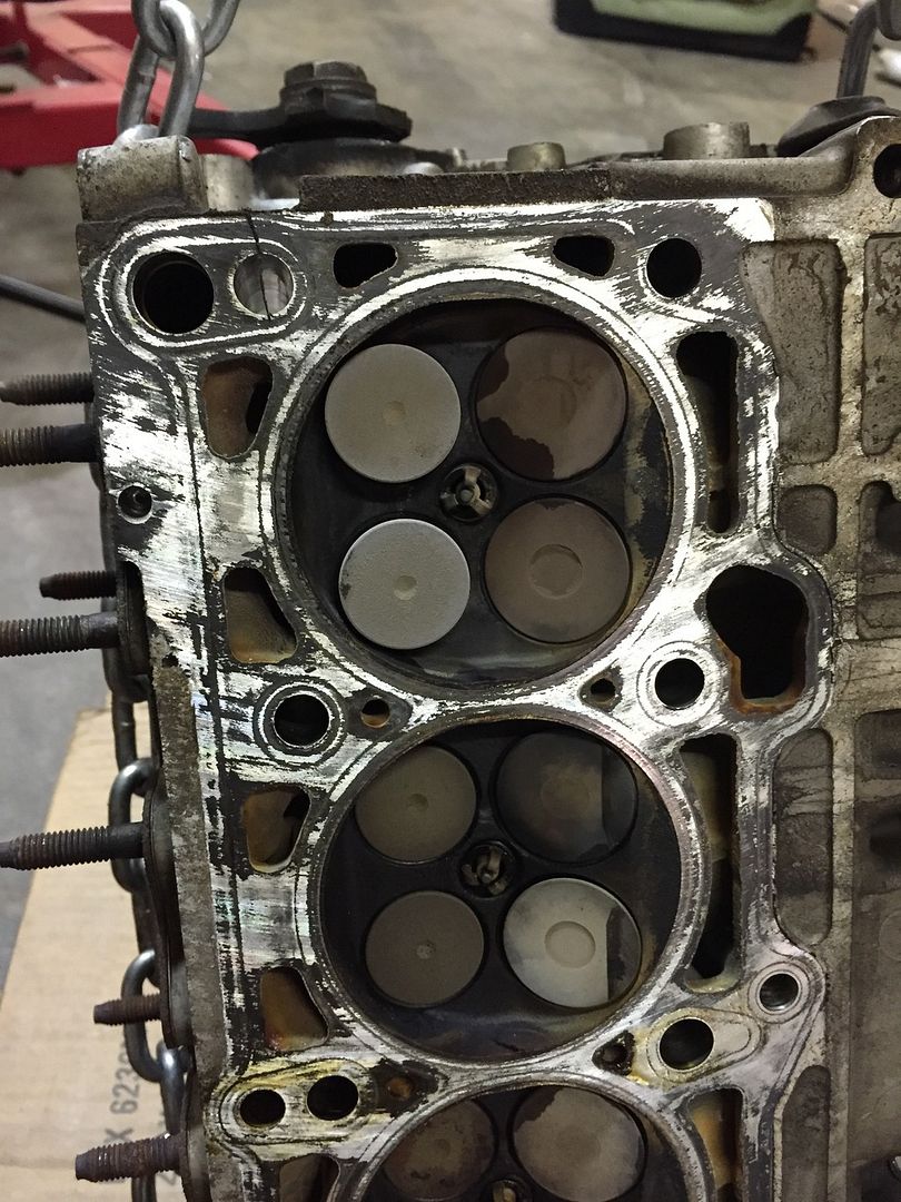

Good news is I don't see any damage from contact from the valves on the pistons. Should be real obvious, right??

cyl 2 and 4 look like they might have had impact. see the intake valves how they have the line? thats what they look like when they hit the valve reliefs on the pistons.
Dave
Posts: 415
Re: 1983 URQ: project unicorn : Pic heavy
Post by Dave »
like this; Image

They do have that little line. So what's the protocol then , leak down test?
Dave
Posts: 415
Post by Dave »
ehh it doesnt cost much to replace them and feel confident about the motor.

Dave wrote:ehh it doesnt cost much to replace them and feel confident about the motor.
Ok. Good call.
Lightweight? Oversize or stock? what do you guys think. Ferrea?

Is it me, or is there a crack in the head at the top left in this picture:

It looks like a crack but it's actually a piece of gasket. I do see a couple small crack near the spark plug holes on #2 and #4 cyl. Pictured below:
http://i1180.photobucket.com/albums/x41 ... vtoamo.jpg
http://i1180.photobucket.com/albums/x41 ... bdolu1.jpg
This is my "spare" AAN head that Issam at INA worked really hard to get me (no joke, thanks Issam!!!)
http://i1180.photobucket.com/albums/x41 ... lyiy1a.jpg
http://i1180.photobucket.com/albums/x41 ... zprhvw.jpg
http://i1180.photobucket.com/albums/x41 ... pzm0lp.jpg
So if I remove some of the carbon and don't see any cracks by the spark plug holes, I will take the AAN head in and have a leak down done on it.
I found in the QW urs4/s6 FAQ that Audi says "Cylinder heads with cracks between the valve seats or between the valve seat and spark plug threads may be reused without reducing service life, provided cracks do not exceed 0.5 mm (0.020 in) width or when no more than the first threads are cracked".
Upgrading the exhaust valves is almost a no brainer. My head was basically new (10,000 km) but Hank convinced me that $160 on some Ferrea valves was cheap insurance, considering the alternative costs associated with dropping a valve. During that discussion I asked him about the valve sizing and his take was that for the power range I'm shooting for it's best to keep the velocity high and stay stock size. I think you go up when you cross the gt30/gt35 threshold.
