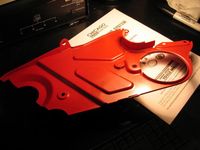

a4kquattro wrote:nice diy solution :)
I paid the $20 for the dealer part tho, call me lazy 8-)
for what part?
the timing belt backing plate.
Alloutofdonuts
Post by Alloutofdonuts »
for what part?
lol...whew! you thought the dealer had one of the tensioner dealies you just made from scratch? My mind said no effing way, man. LOL. Pretty cool and innovative stuff you got there though.
Posts: 1586
ah, I see. The goal was to change tension without loosening the water pump. I thought you just couldn't get the 20v backing plate.. since they are different than the 20v backing plates.. Nevermind then 8-)
Mark, You don't happen to have a part number?

I dont have etka infront of me at the moment, but I'll check when I get back in the office (or someone can beat me to the punch..)
quattro87
Posts: 1000
Post by quattro87 »
Did you get the front cover also?
Posts: 1586
quattro87 wrote:Did you get the front cover also?
yep.
And the 3b wiring cover cause I liked the look 8-)

whew, yes i used my 7a backing plate but added a hole in it for my new tensioner and just had to be anal and seal it up nice. thought you were going to say you found a timing belt to work. after me going through about 400 gates part numbers i was kind of hoping i had not missed one. :P
just getting back to this,
034 109 143 B

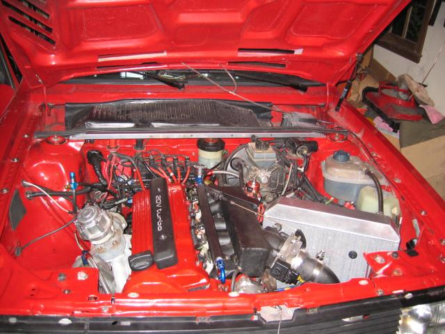

i started my IIc / mod mc2 short block/7a head CQ
Post by pkw »
i did not make my aug 19th date for starting so i could relax and i did some of the other small things, and well, it was just time to start it, so i did. i did not run it for long because of the lack of coolant. start-up went well. :woowoo:

an update. the only thing i was worried about with this build was the car being too sluggish off of boost.... not a problem. i am sure the low, close gearing and it being lighter weight than a big bodied audi all help. the ENGINE AND TURBO ARE A GREAT COMBO. this car is much better than a 5ktq which is where i pretty much draw the line. so, in summation i have a very strong bottom end that is stronger in some ways than the high dollar combos folks are building. :woowoo:

stock bat location, ac, 7a intake and TB & rad... (also my own flavor of coil on plug and injector inserts)
Attachment ( 5896 ) : enginePL.jpg
