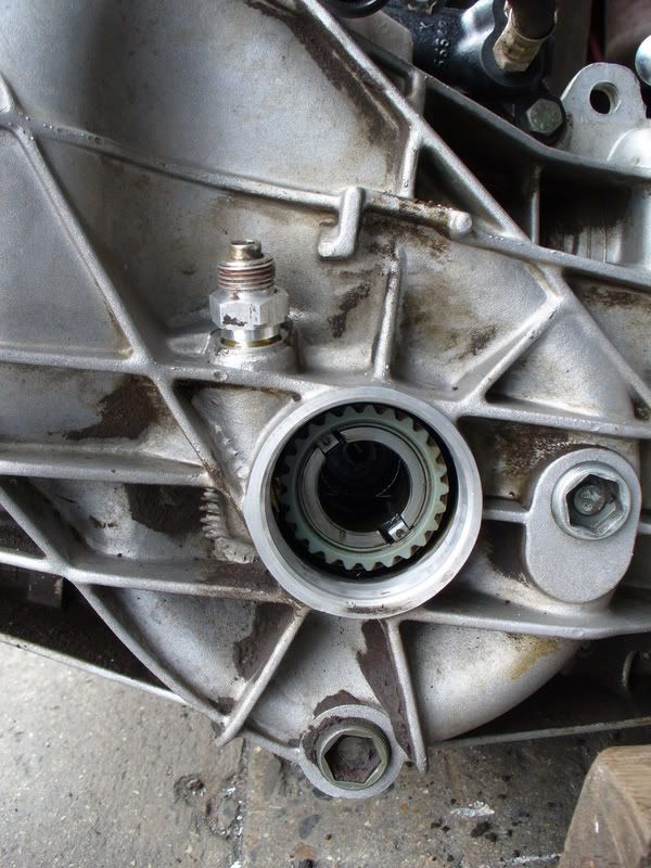

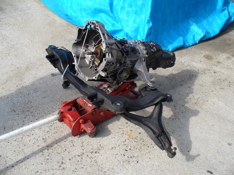

ok, the biggest break of the week here. i'm putting in a 20v 200 transmission which has the electronic pickup for the speedo... so when i pulled the speedo sensor out thinking it read the toothed gear down inside, i found it didn't :( then i started looking at the way it sat inside the tranny when i had the axle drive cup out.... hmm, looked at the old 4kq 016... hmm. so out came axle seals and BAM the speedo ring thingies interchange!!! :woowoo: the hole in the 200 trans is even threaded for the old style insert 8)
installed now and waiting for seals :D
torsen center diff here i come! :D

Yep, it's a beauty.. and you don't have to thread the sensor hole either.. nice touch from Audi.

and to PxTx, yeah...1 project at a time :P it's a lot of work and i'm not really even doing that much fab work on her, just mostly maintainence kinda stuff. i just got done rebuilding both front inner CV's so i won't have to touch them for about forever. the tranny drive flange seals just got here and i already installed them and put the flanges back in and the right side tranny mount arm has been swapped out so next i'm gonna go out and drop the front subframe again, set it around the trans and bolt it up, then raise the whole unit back up into the car so i can put the front axles back in, the driveshaft (after i put the new center support in of course), and then work on getting the suspension back in and put the car back on the ground where she belongs :P

Thats funny, I just bought one of the non-geared type speed sensors for my 93 S4. Went to pull off the electrical connector when applying heat to the oil fill plug to get the damn thing out.. and the sensor came apart in two pieces :frustrated: (PO had it held together with RTV).
Pleasant surprise that the sender was only $20 from the dealer :woowoo:
SeStone
Post by SeStone »
Aight, now I want details on what sort of signal that sensor puts out, and what the teeth on that speedo 'gear' look like. I assume it's a VR of some sort?

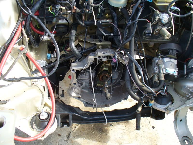

the transmission got put back together and mounted on the subframe..
and quickly bolted up in place...

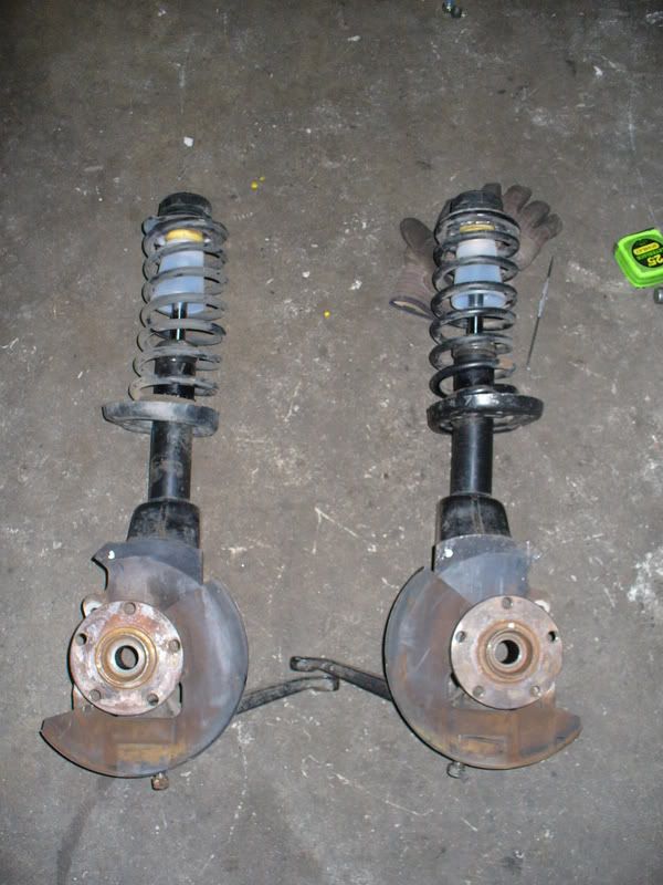

the front axles are in place now too. the last thing i worked on this evening was my custom home brew suspension. i'm interested to see how it turns out :tard:

derracuda wrote: the last thing i worked on this evening was my custom home brew suspension. i'm interested to see how it turns out :tard:
No coilovers on that bad boy?
derracuda
Post by derracuda »
not at this point. the springs i'm using have about the rates i'd like to have, but the issues is just getting the spring perches right :P

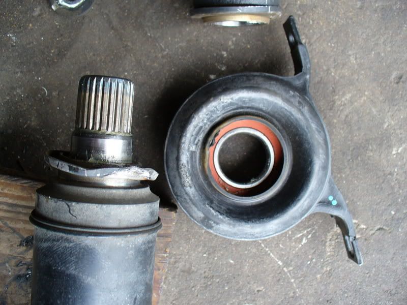

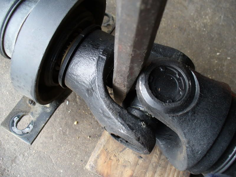

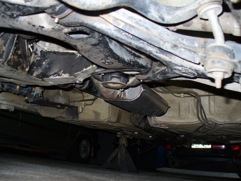

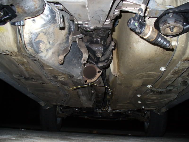

got the driveshaft rebuilt today and put in, hung the center exhaust section, and tore apart some of the engine.
ran into a little issue with the forward part of the bearing coming into contact with the stock dust shield on the driveshaft. so i just tapped it off and everything's peachy keen :)
:woowoo: getting closer :)

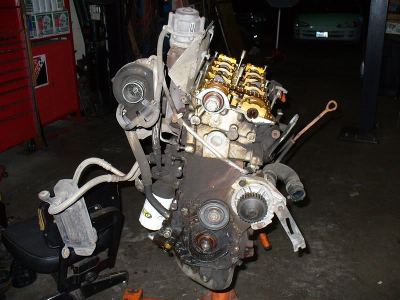

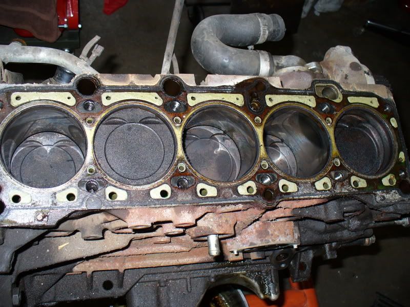

then i got a little into the engine

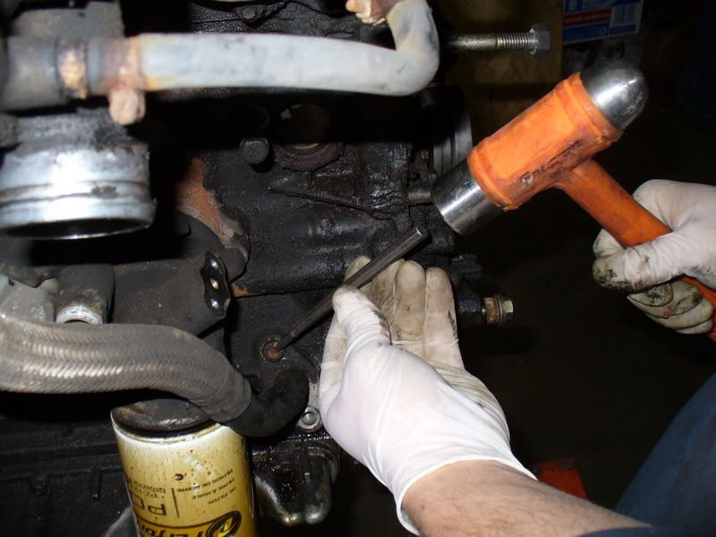

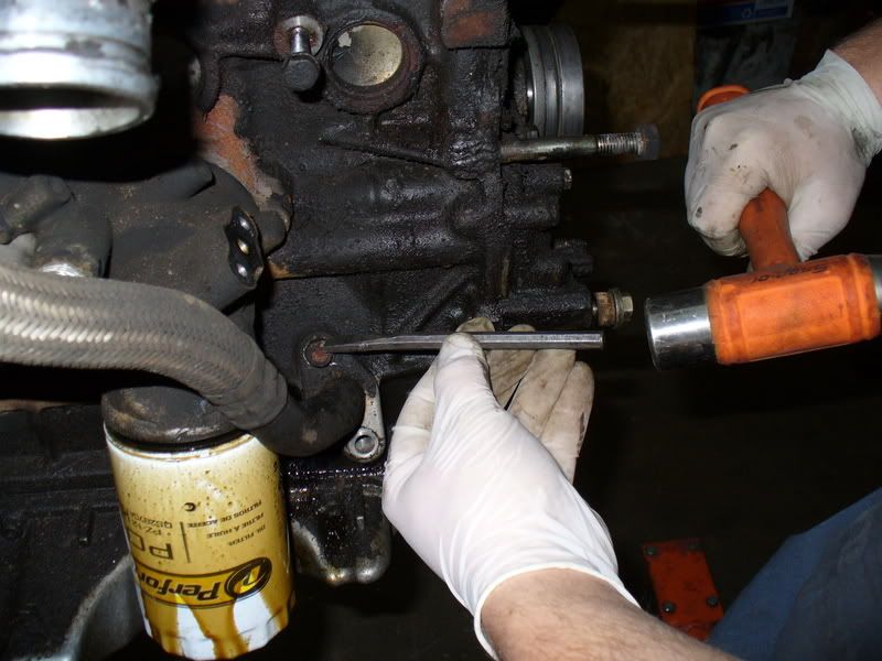

and had fun with the stupid allen bolts that hold the lower end of the turbo return line :frustrated:
here's the remedy...
take a punch and make a groove in the side of the bolt head for the punch to rest in...
then angle the punch and hit in the "off" direction..
other than the allens, everything was pretty uneventful
hope to have the rest of the block apart tomorrow and give it to a friend for hot tanking. i found a nice surprise as well. the front snubber bolt hole bosses were at some point broken off, i'm guess when the car was in a front end wreck (evidence of sheetmetal work etc.) and some genious welded studs in there, one of which i broke off trying to remove not seeing it was welded in under the grease and gunk :tard: so oh well. i'll figure out something soon.

:drool: factory honing marks...
