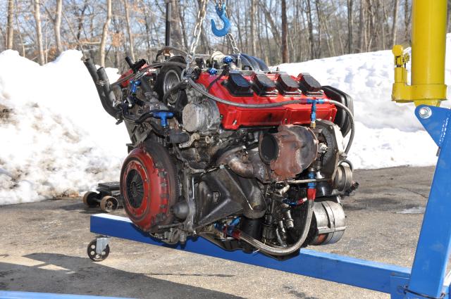

engine is out, car is pushed outside so I can keep the doors closed and swap some of the custom parts off the 3.6 onto the 4.2. Parts I will be swapping include:
oil pan (clearanced for the subframe)
crank pulley (60-2)
t-belt covers (powdercoated)
valve covers (powdercoated)
exhaust manifolds/turbos (duh)
I'll need to drill some holes in the 4.2 block while I've got the pan off for the turbo drains as well as some new provisions for catch can drain back...

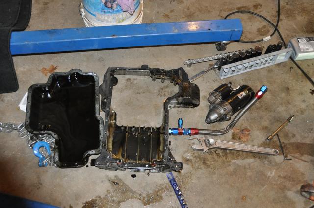

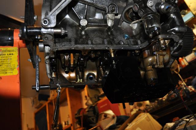

put the engine up on a stand tonight:
pulled the lower and upper oil pans, since those will be swapped onto the 4.2
next up is to lift the 4.2 off the ground and pull the upper and lower pans, drill the oil return lines into the engine block, as well as a yet to be determined catch can drain back hole.
man alive there are a lot of oil pan bolts on these things.

Posts: 1589
life has been busy lately.
Closing on my house the 16th of this month (fingers crossed). I did manage to sneak out to the garage tonight to tighten the oil pan bolts for the swapped mid and lower oil pans (all eleventy billion of them).
Next up is R&Ring the waterpump and idler rollers and installing some new seals, swapping over the powdercoated timing belt rear cover plates for the heads, then install the t-belt..
