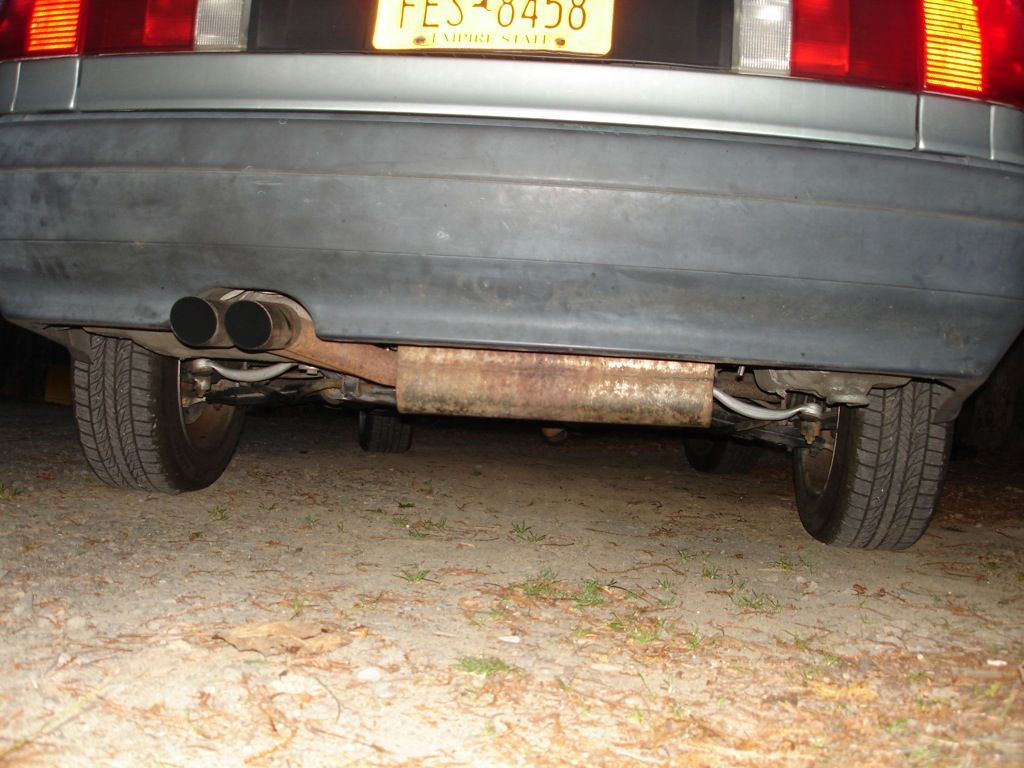

I'll get to that soon; I need to install the center section also. Related to this, I've come to realize my gutted cat may be contributing to the noise + causing unwanted turbulent exhaust flow. I'm going to replace it and here's a few options:DE80q wrote:Haha... So nothing like my 20vt exhaling through it then huh?
I'm still very interested to hear a diesel sound through it.
1. straight pipe
2. diesel cat(new)
3.braided flex-pipe
4. combination of above
Any thoughts or recommendations are welcome. What length and what brand diesel cat? I need to figure that out.

I'd straight pipe it and add a flex section, as long as your inspection shop doesn't put it on a lift...that should be safety only, but I know some shops are being shitheads with the new nys inspection regs.
Re: Rich's '91 80Q M-TDI
I straight piped mine. It helps when your inspection tech also happens to be your best friend though...
