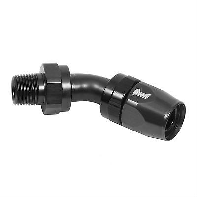

Connector in question:
$_1 (1).JPG (8.07 KiB) Viewed 32000 times
I pulled the trigger on the parts to try it out

Before I respond in detail, I need to slap you if you bought summit fittings.
Posted: Fri Feb 26, 2016 9:24 am
by DE80q
loxxrider wrote:Before I respond in detail, I need to slap you if you bought summit fittings.
Ive learned the hard way to use good fittings.
Posted: Fri Feb 26, 2016 9:26 am
Exactly :thumbsup:
by dana
summit fittings=LOL. They snap very easily.
I just used a bunch of vibrant fittings to build the oil lines for my TDI holset car and found them to be good quality. The price was only marginally more than summit fittings.
Posted: Fri Feb 26, 2016 9:36 am
Not only that, they don't seal well because the taper is wrong or out of spec.
Posted: Fri Feb 26, 2016 10:27 am

I ran a number of summit fittings and lines and never had an issue, the hose ends actually assembled better than the Earls I have on my B6 now. I think it's a step above ebay fittings. Having said that I did go for Earls this time around...
For the oil feed, look at pre assembled brake line, I have 2 sections with a male/male coupler, I think you can get them in -3 in addition to -4 and they're cheaper than buying fittings and hose, although length is a bit less custom.

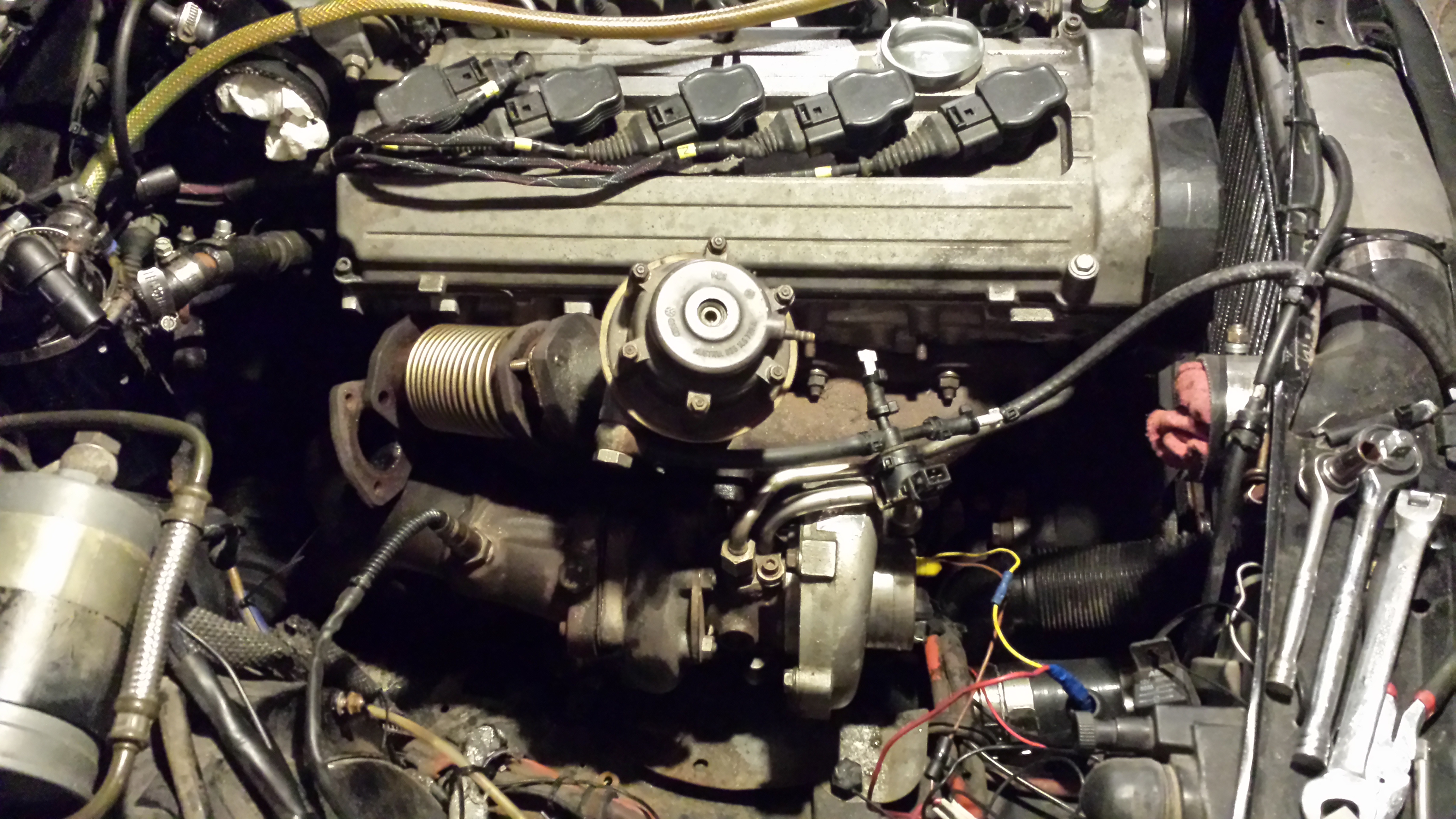

Got a good start tonight kinda
