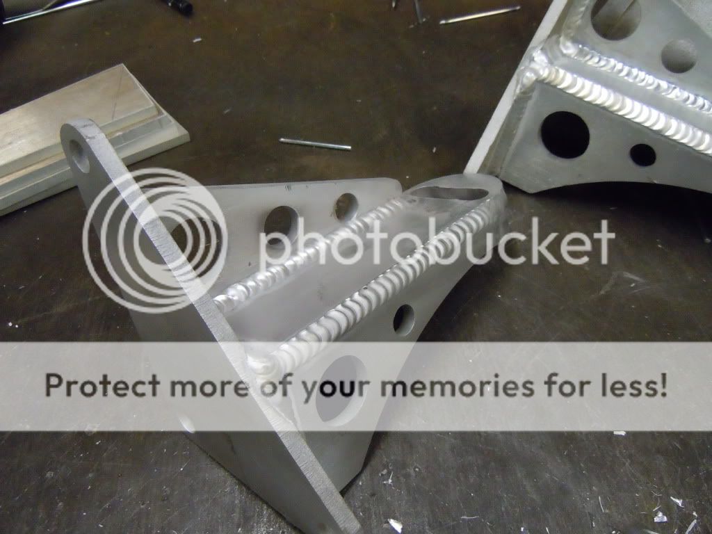

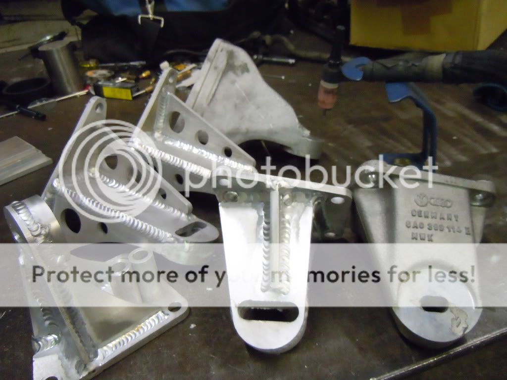

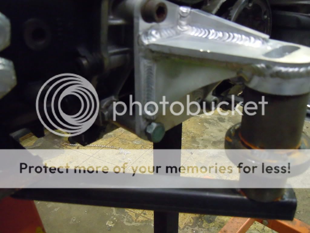

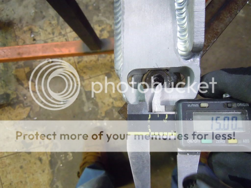

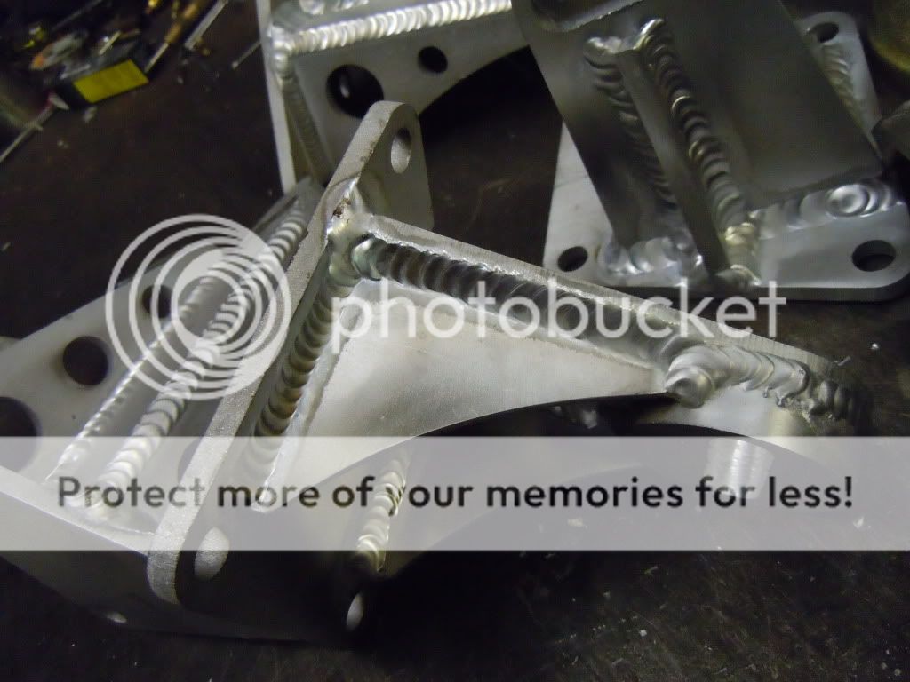

I am starting to gather parts to put one of these 01e's I have at the shop. I made up some transmission mounts that are slotted to soak up the 15mm's of difference in transmission lengths between the 016 and the 01e. It will be nice to get another 5/8ths of room up front. I will probably try to slot everything in the rear subframe later to get everything back another 1/2 inch or so, or within the range of the center bearing support. Eventually, I want to put hte urs4 rear diff in the car, and go to a one piece DS, so I probably will just slide back the engine the 15mm to begin with. I may throw in some 034 slotted aluminum subframe mounts too to get some free castor. The mounts will allow for that much movement though..
Anywho here are some pictures. I think I am going to swap over everything next week. The second set is for Dave's S2 that is getting an 01e soon.

Lookin' good!

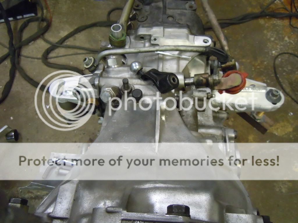

Ya ill get a real post but the linkaged needs to be raised a bit to clear the larger housing of the 01e compared to the 01a

my2000apb wrote:Ya ill get a real post but the linkaged needs to be raised a bit to clear the larger housing of the 01e compared to the 01a
b5 s4 linkage right? Did you cut and flop the linkage or use as is?
- Posts: 659
Re: Hanks 81 URQ 01e prep
it seemed that the owner flipped and apparently shortened too because it bolted right in.....

your fabrication/welding skills are top notch man. very nice work.
Those mounts look good Hank... keep up the good work. With any luck I'll see you in October.

As usual top fab work looks sweet Hank

ShavedQuattro wrote:my2000apb wrote:Ya ill get a real post but the linkaged needs to be raised a bit to clear the larger housing of the 01e compared to the 01a
yes b5 s4 linkage, cut and flop, to use the b3/b4 shifter anyway
the b3/4 linkage doesnt even use the extra stabilizer rod that the b5 s4 uses.
im looking to integrate the b5 s4 linkage AND shifter box into my car so i can use the extra stab. bar as well.

5k linkage will bolt in

Hardly bolt in. it can be modified, but everything about it is different, from the cross over pivot to the actual selector arm(set screw in 016 apps, and a wedge in 01e apps) to the mounting of the pivot arm.. It can be made to work though with some basic fab tools like welders
I have machined spacers to take up the 15mm Marc, but I would just use the slot of the mount to scoot everything back 15mm and end up with more room up front. Anybody putting an 01e in a type 85 probably longs for more IC space
