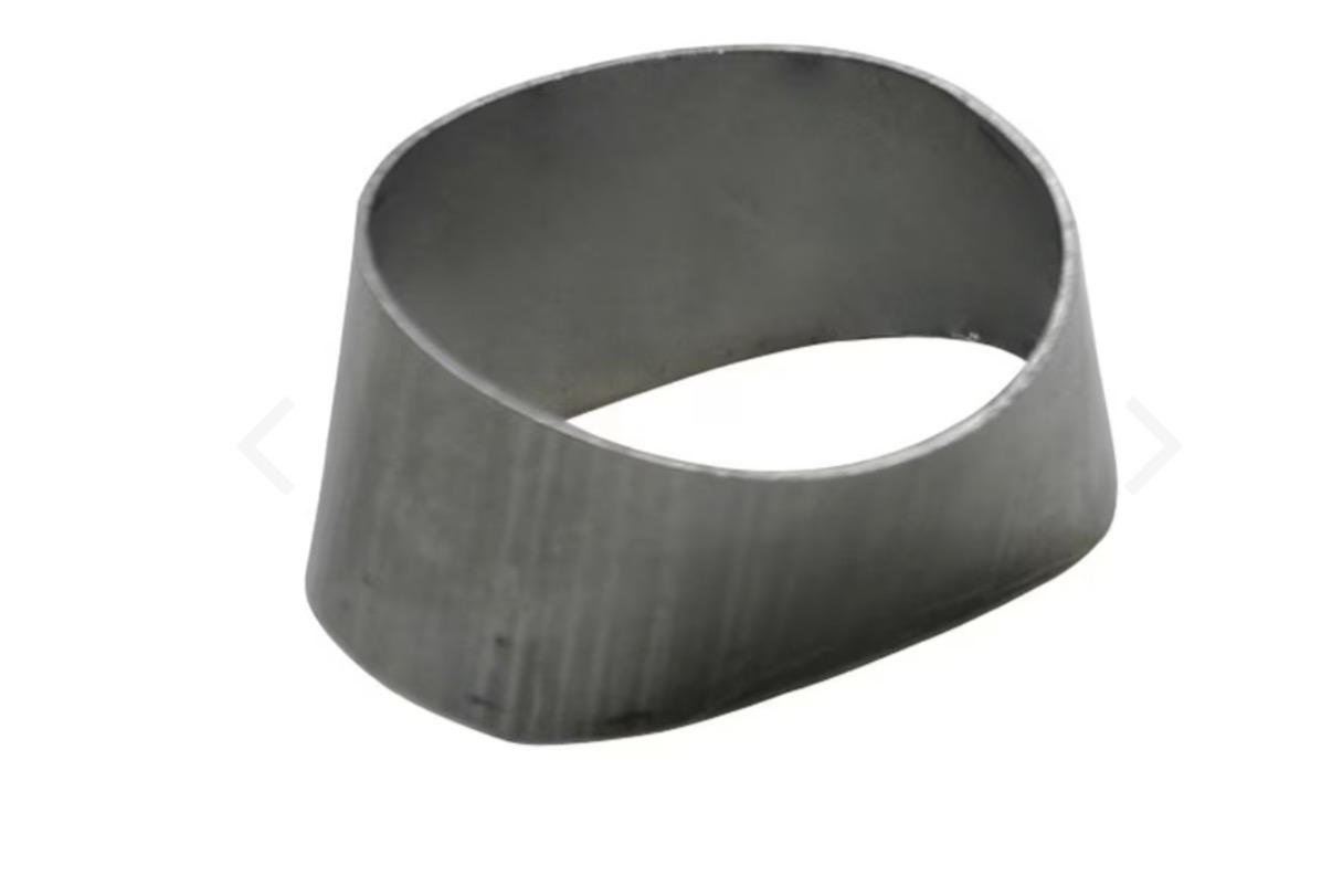

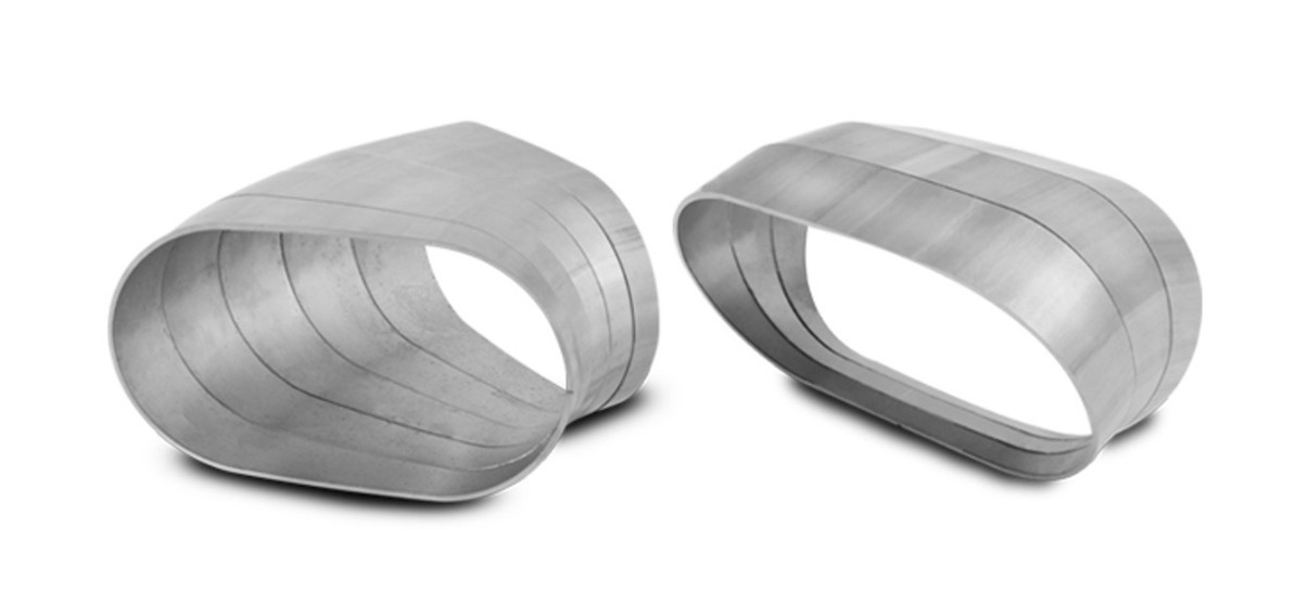

Here’s progress so far. No oval tubing. Can’t get it to fit
do you all run 3” tubing? I’m worried about ground clearance and melting things?

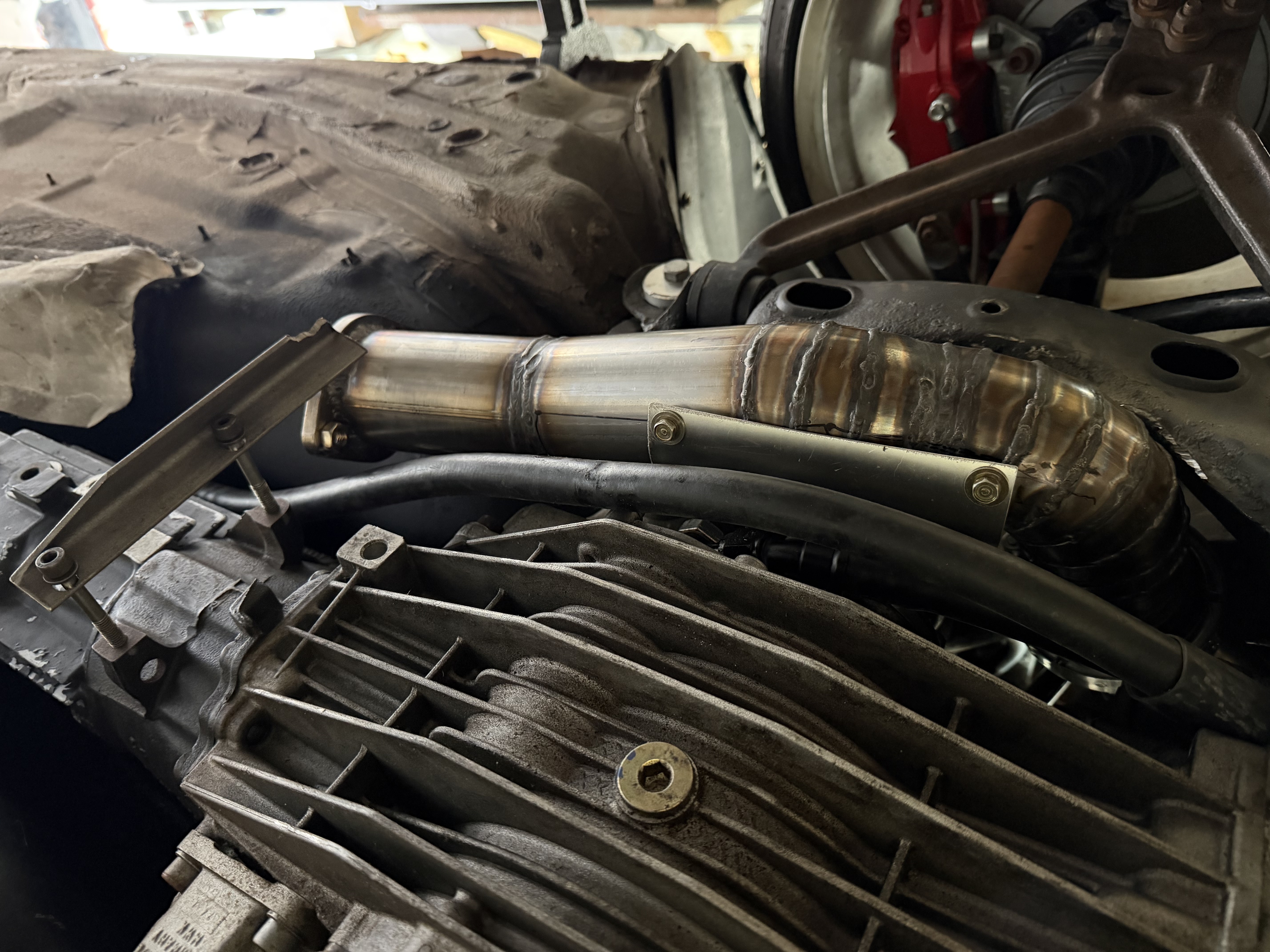

I bypassed going up and around the diff on mine. It is now the first thing that hits anything. I plan on redoing mine to snake around. Your image looks like what I had I mind. 45deg over the CV. I kinda gave up fitting it correctly. Even the same box of amazon pipe but in 2.5
Hanger situation sucks. My rear oem muffler broke at the welds, so it was my quick fix.
I am not happy with my setup.

Yes. A 3” 45 degree slightly cocked will go right through with 2 bolts flanges on both ends to get it out without lowering the subframe or axle. There’s only 1/4” of clearance in a bunch of spots going through though. I’m currently figuring out the mounting situationdspl1236 wrote: Fri Mar 06, 2026 1:01 pm I bypassed going up and around the diff on mine. It is now the first thing that hits anything. I plan on redoing mine to snake around. Your image looks like what I had I mind. 45deg over the CV. I kinda gave up fitting it correctly. Even the same box of amazon pipe but in 2.5Hanger situation sucks. My rear oem muffler broke at the welds, so it was my quick fix.
