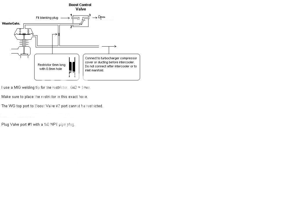

and here, lemme show ya what i do with mine....

The problem as I see it is the industrial valves open a lot more quickly than pretty much all stock boost control valves, so kind of like installing an injector with a lower latency (actually exactly like it) if you install one with no tuning changes your effective duty cycle goes up. I haven't tested an N75 but the solenoid on certain Buicks takes 2ms to open, MAC take far less.
Boost went up 4psi from spec when I installed a MAC valve in my S40. It was fun until the computer started throwing excessive boost codes, which is funny because it never did that with a manual controller set for the same boost level.
