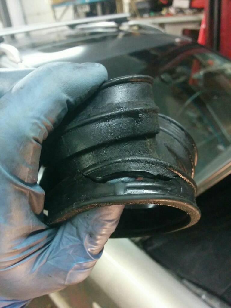

$1100 in wheels, $600 in brakes, $300 in other misc parts (hood strut, oem coolant tank since my year-old one is cracked and leaking, general upkeep) and now it's going into soft limp. Key cycle resets it, but it will do it in 6th @3krpm every time it seems. Lower gears are hit and miss.
Every time I have to touch this engine I just feel dread. Gonna check the codes first obviously, but damn. I hope it's a nice little boost leak that's easy to fix... yarite

Praise baby Jesus I fixed the low boost and soft limp mode problem. Everything I could find said waste gate lines were the likely culprit but thank goodness no problems there. A pressure test revealed... Dun dun dun! A fucked up Y pipe. Everything else was great. It wouldn't hold any boost. Boost is back and it's sooooo glorious. I wonder if the leak would affect fuel economy much. We'll see next fill up.
Re: Matt's WIFE'S 01 6 speed Allroad
Boost leaks are nasty little buggers to find on the 2.7t! It's always so satisfying when you know they're good and tight. Good work!
